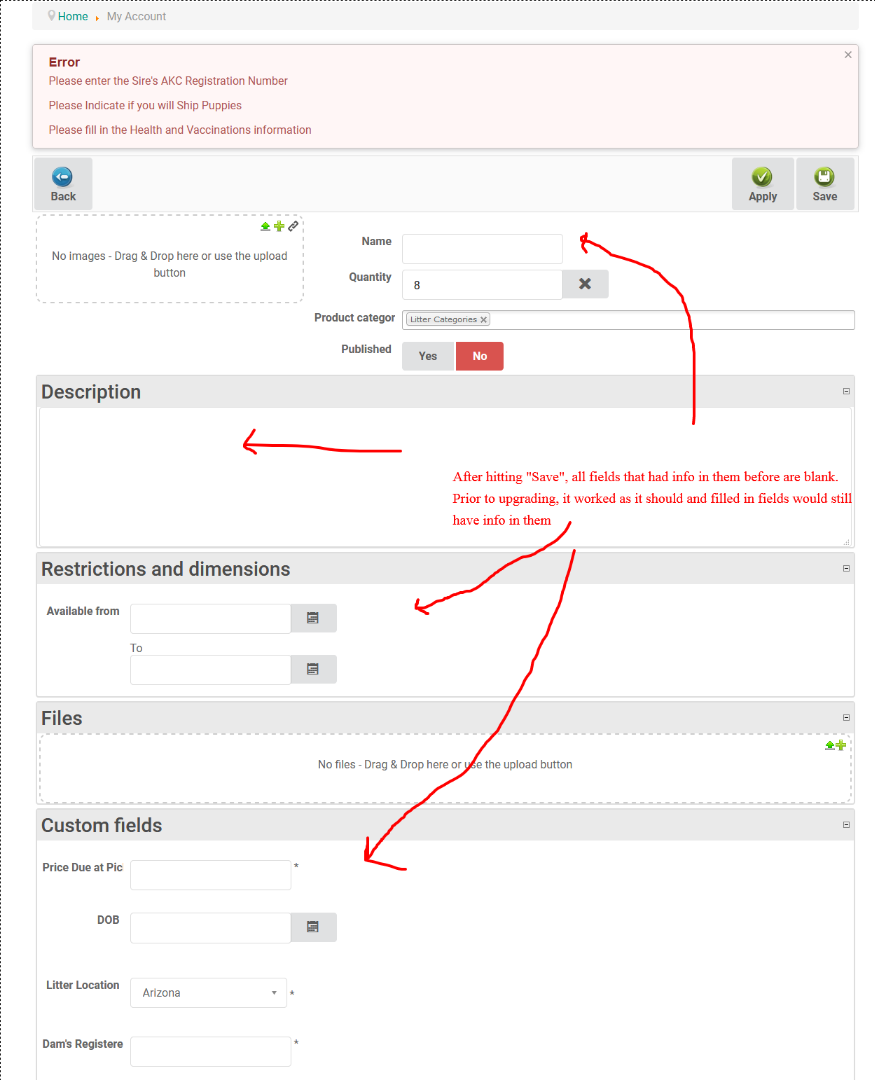

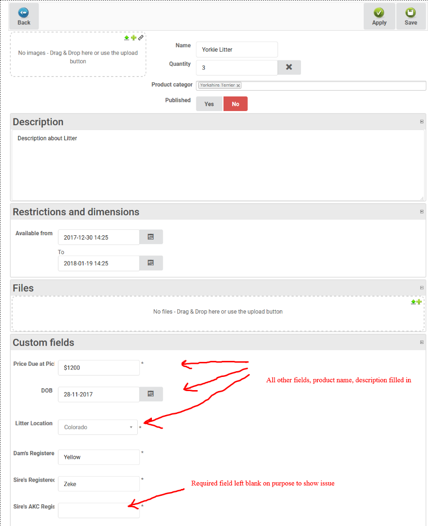

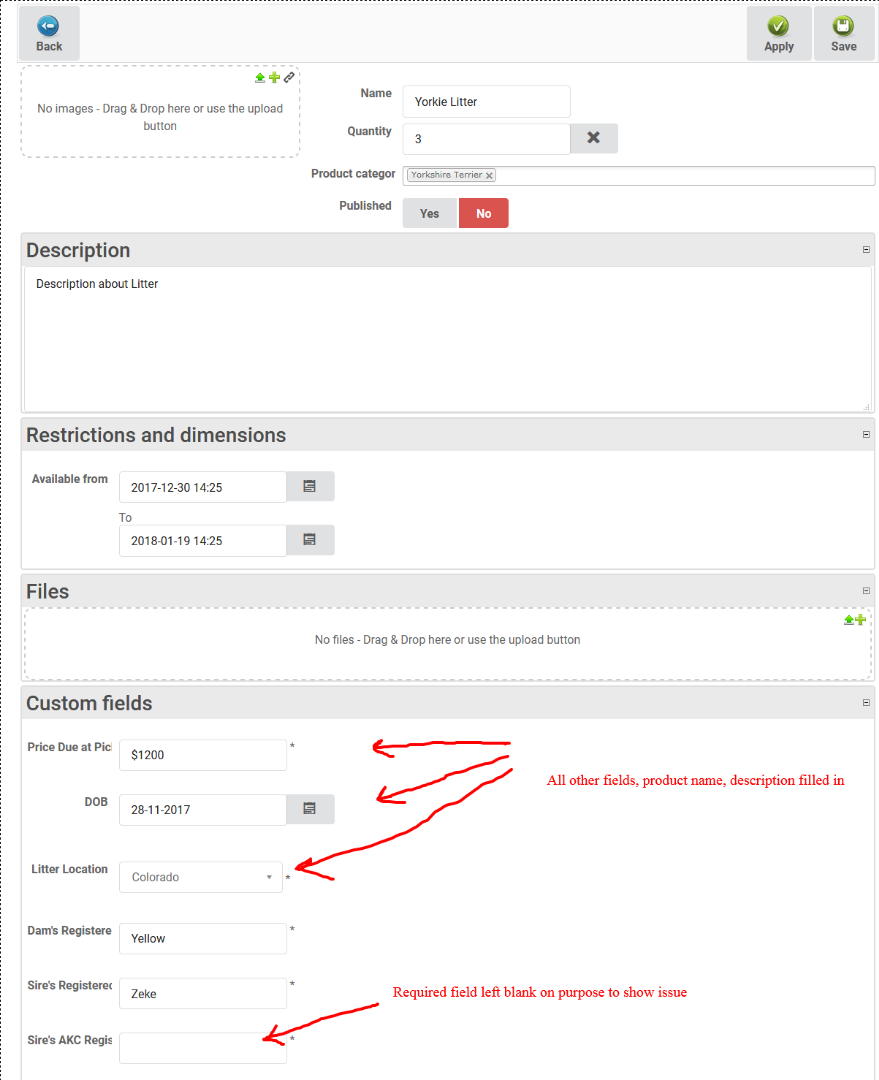

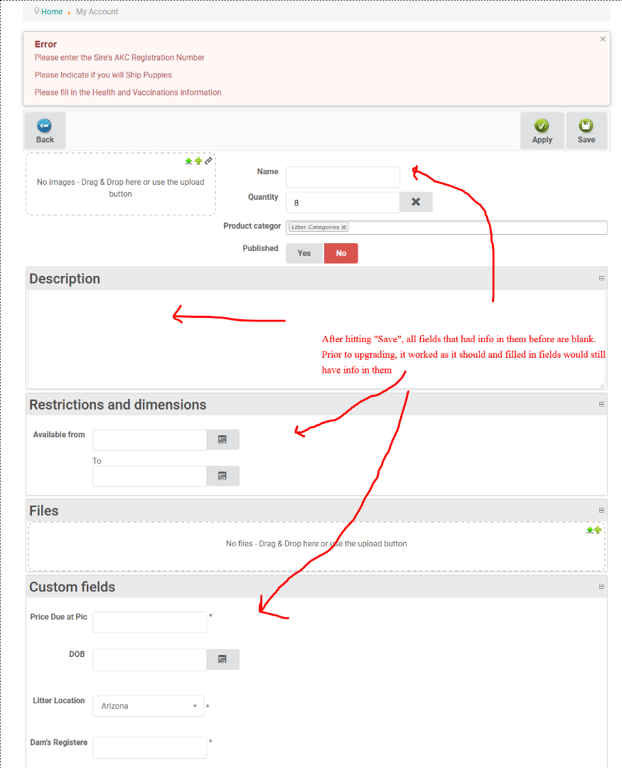

  • Posts: 58
8 years 7 months ago #284561
Sorry that you didn't follow our ask. Here are the steps
1) Vendor is logged in to the front of the website
2) Go to their account and chose "Product" folder
3) Click on "Add a Product"
4) Enter info into fields -- name, price, description, custom fields, etc
5) They mess up and forget to put information in any REQUIRED CUSTOM FIELDS and hit "SAVE"
6) Page reloads and gives them message at top to "FILL IN REQUIRED FIELDS"
This is all great....HOWEVER...all the fields that they already filled in PRIOR to hitting SAVE are now CLEARED. None of the work they did before hitting "SAVE" is saved...they have to start over...annoying.
I'm attaching two screenshots showing fields filled in and then what happens after they hit "SAVE".
Hopefully that explains our problem.
  • Posts: 26380
8 years 7 months ago #284569
I performed a test in my local website, using HikaShop 3.2.1 and HikaMarket 2.0.1 and I cannot reproduce your issue.
If I enter some information, let one required product custom field empty and then press the "apply" button (or "save" one), I got back the product edition page with all the data I wrote in the fields.
That work is done by the HikaShop field system. When there is a failure, the process is loading the data which has been entered and put it into the user "session". And when the product edition page is displayed, that data in the "session" is detected and loaded instead of the getting it into the database.
Please, be sure to be up to date with the latest version of HikaShop and HikaMarket.
If the problem persist ; please first perform a test in the demo website to check if you can reproduce the problem there.
