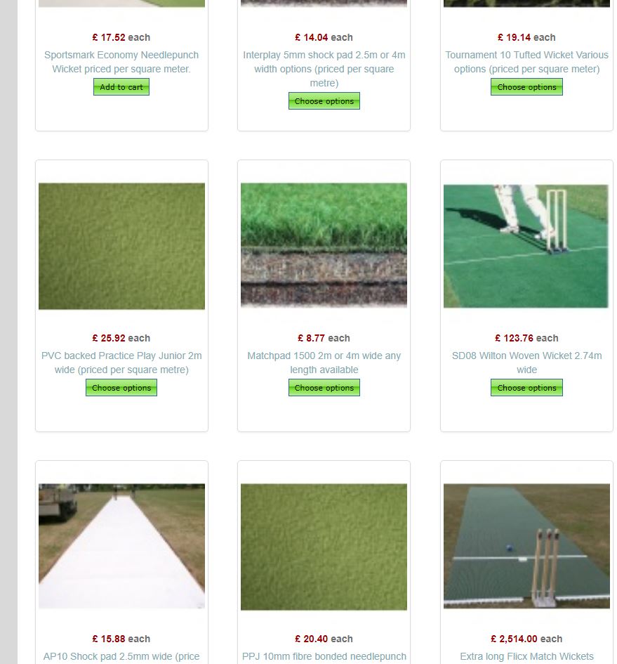

Hi All,
I've been asked to look at a Hika shop in Joomla and this is my first visit to both Joomla and Hika, so please go easy on me if there is a simple solution, but I did search and could not find one.

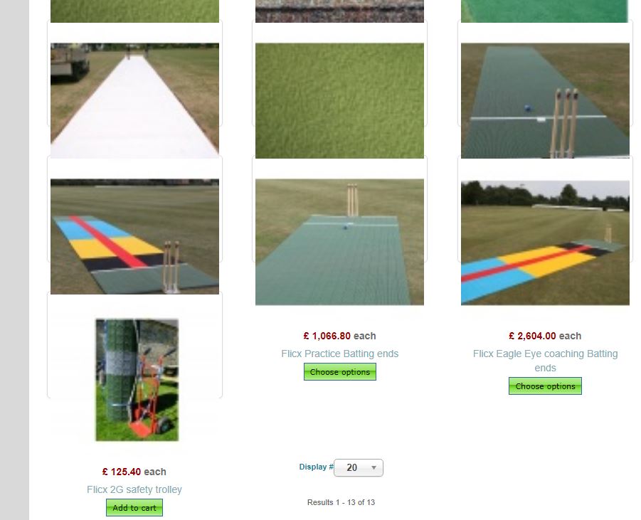

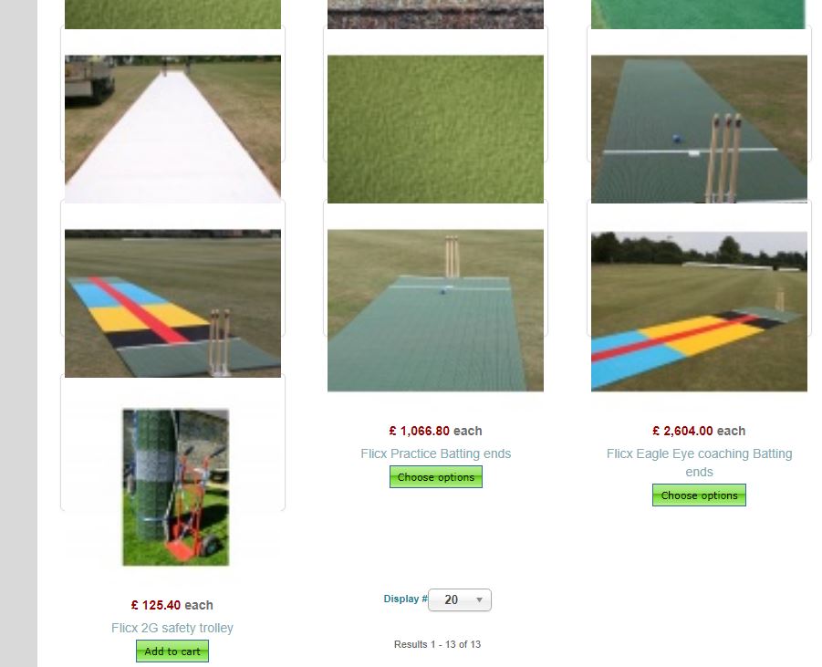

As you can see from the first image attached image the products are displayed in a lot of instances without their prices. The second image shows what the page should look like and is what is seen after pressing refresh, or if the developer tools are open. I assume this is something to do with the way that the style sheets are downloaded, but is there a fix?

8 years 7 months ago #285335
For me, your links display fine on the first load.
I suppose that the problem comes from your internet connexion which is too slow and because of that, the javascript to calculate the height of the elements is done before the images are loaded.
I would recommend adding such CSS to your template in order to force the height of the elements:
.hikashop_subcontainer {
    height: 350px;
www.inmotionhosting.com/support/edu/joomla-3/edit-template
docs.joomla.org/Discover_your_template_c...n_how_to_change_them
