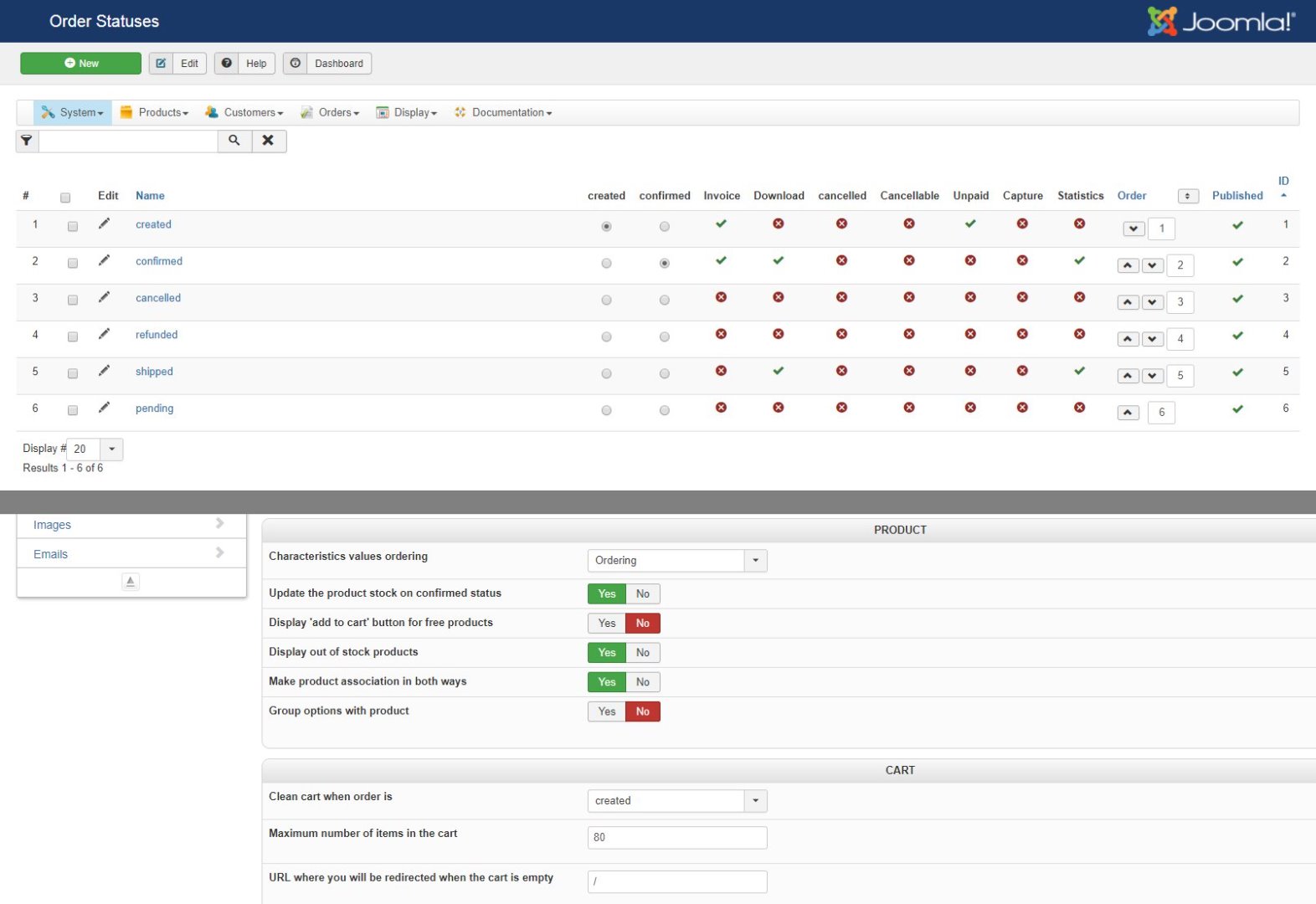

In order to better understand and be able to reproduce your issue, can you provide screenshot configuration :

Hi Philip,
see attached screenshots, though the setting "Clear cart when order is created" doesn't have anything to do with when product stock is deducted, right?

When you have that option activated, the stock is updated when the order status is set to one of the statuses activated in the column "invoice" of the System>Order statuses menu.
So you should deactivate the "created" status in the "invoice" column there and it will then work like you want.
