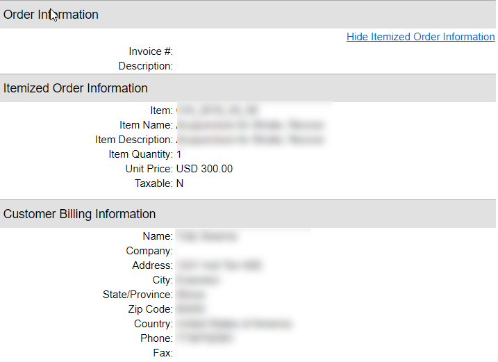

-- Error-message(debug-mod must be tuned on) -- : Invoice Number does not appear in authorize.net invoice.
How do we send the invoice number to authrorize.net?
Currently, no invoice number appears under the order information in authorize.net.
Looking at the API documentation, "invoiceNumber" can be sent under the "order" object in JSON.
I have no clue how the data is sent in the authorize.net HikaShop plugin.
I was hoping you can help me add a couple of lines of code to pass the invoice number.
See the attached screenshot for a visual of the missing information.

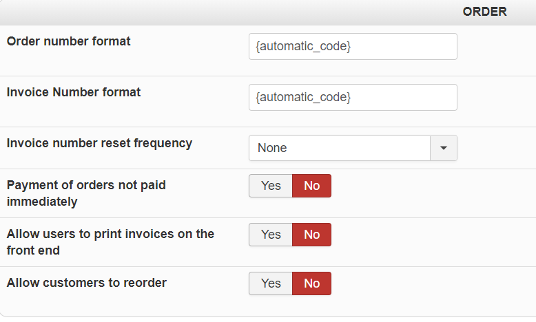

Finally, the orders in the database are mostly confirmed, but no invoice number is showing in the database for any order id. Here are the settings for "system > order".
