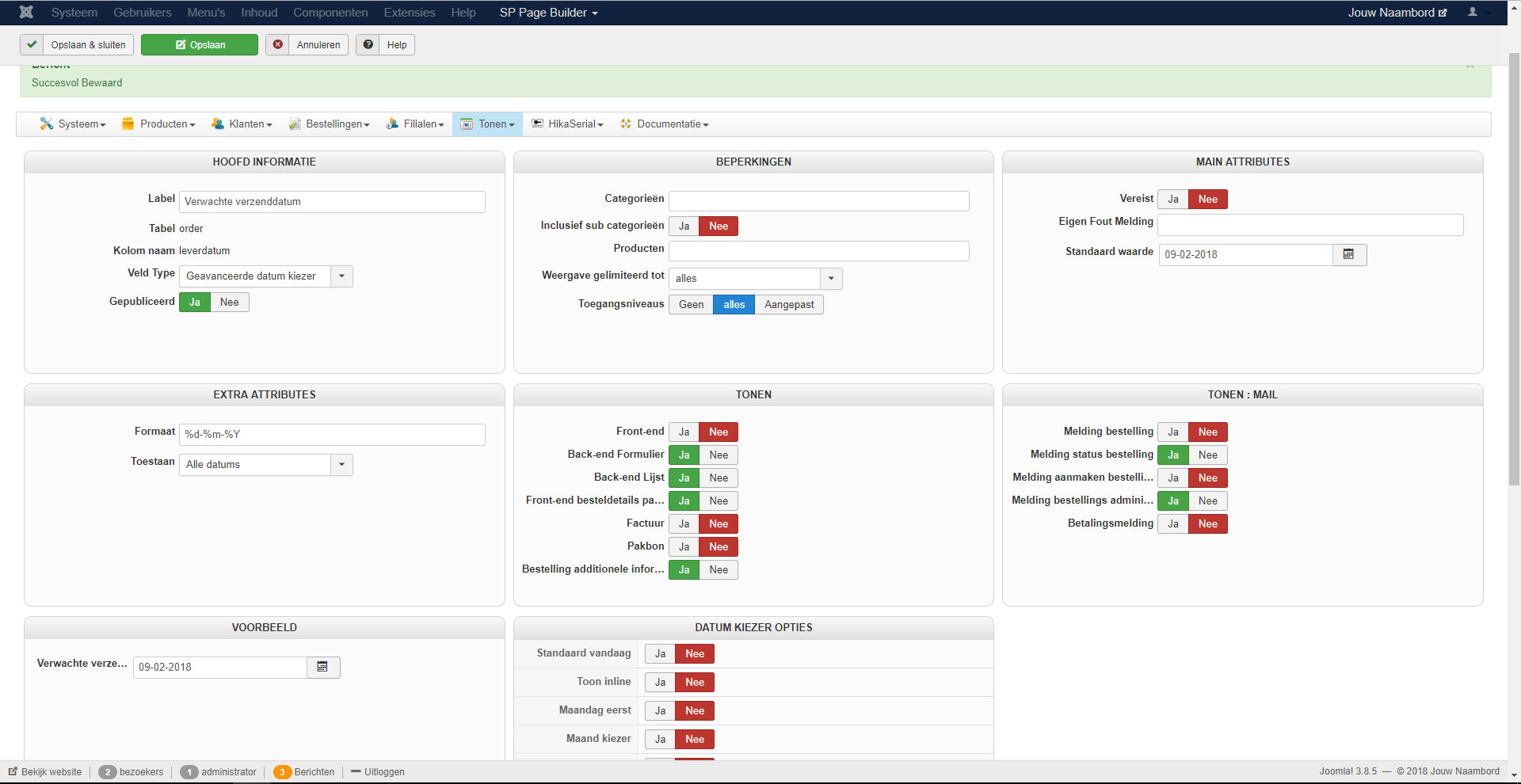

I have a datepicker extra field in the ordertable, so my clients can see an appr. deliverydate. I checked the corresponding "frontend orderdetail page" in the show tab, but the date isn't visible on the order detail page. Only when I also check "Front-end", the date shows up on the page. But then it also shows up in the checkout and my clients are choosing a date theirselves to send the order. That's not what I want :), I would like to let us choose this date. See screenshot.

Activate the "frontend" setting and remove the "fields" block from the "checkout workflow" setting of the HikaShop configuration.
That way, you'll have the field on the order details page but not on the checkout.

Thanks!
