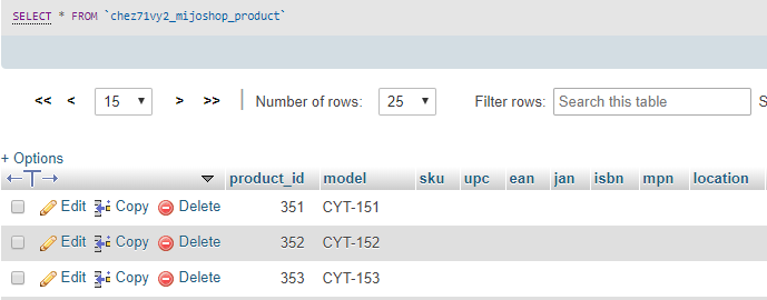

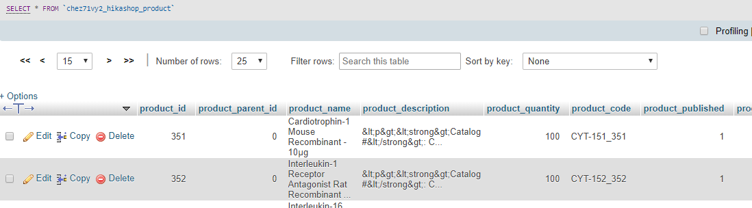

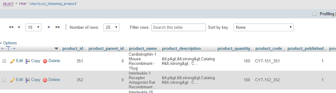

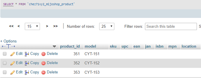

The import script is joining mijoshop_product 'model' and 'product_id' into hikashop_product 'product_code'.
See the attached files. I do not want the underscore and what follows.
Our correct product code format is CYT-151 not CYT-151_351.
I'd like to modify the script to NOT add the 'product_id' to the 'model' before writing it to hikashop_product 'product_code'
