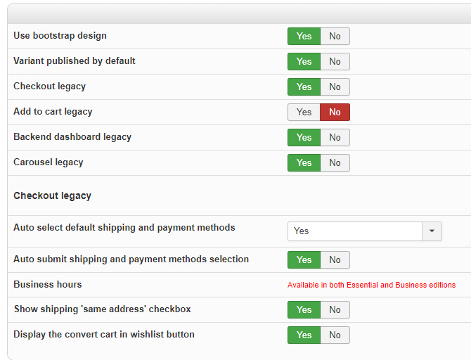

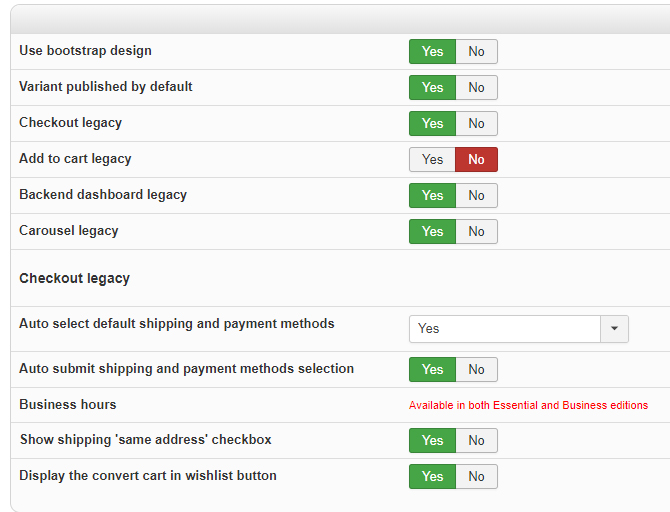

8 years 6 months ago #288750
Here are my settings and it STILL is not working... I need some serious help here man. I'm loosing money becasue of this problem.
Please try it for yourself on my site: www.ucanfixit.ca/index.php/browsemanuals...272147-repair-manual

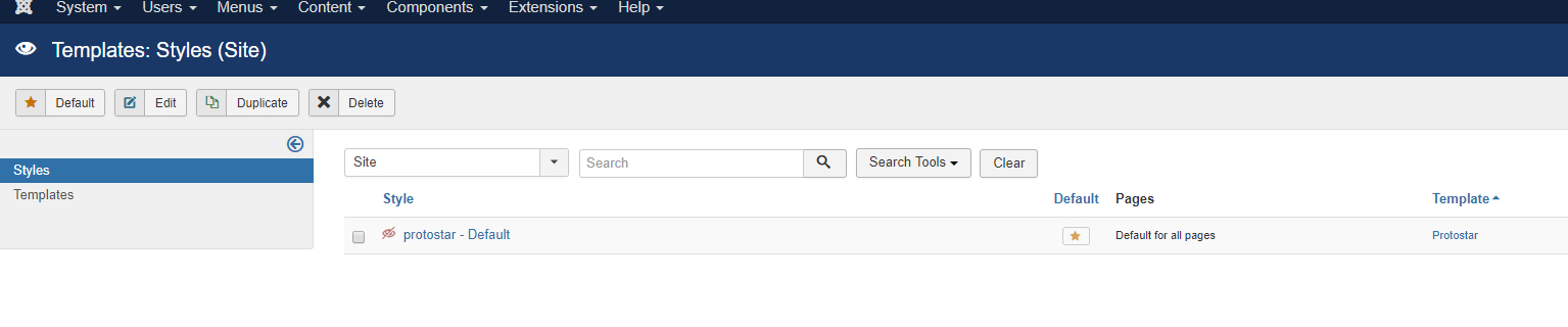

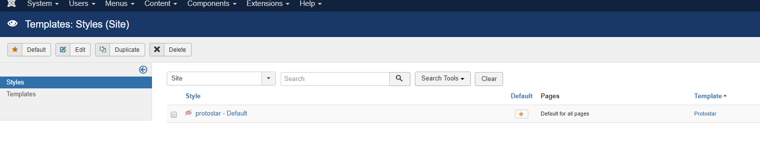

8 years 5 months ago #289157
This is it though man... I don't have any other templates installed! See below:
  • Posts: 86081
  • Thank you received: 14190
8 years 5 months ago #289181
Then, try renaming the folder templates/YOUR_TEMPLATE/html/com_hikashop/ via FTP in order to deactivate all the view overrides of your template, that might help.
