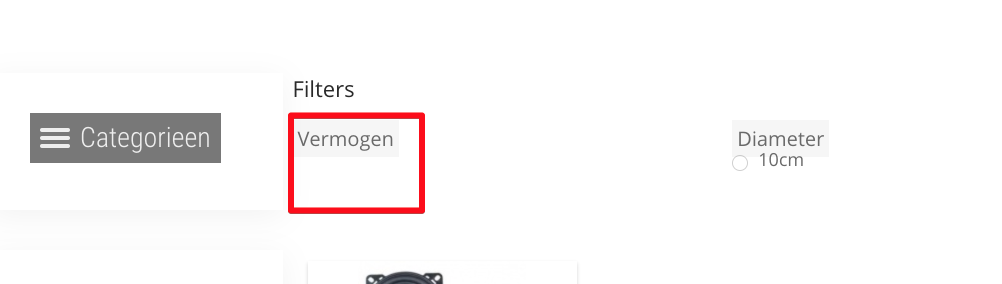

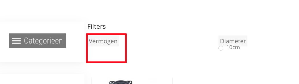

I can also dynamic view in the filter settings but why is this option showing the title position even if the filter option itself isn't shown?
If this title isn't shown when there are no filter option available this would be perfect.
