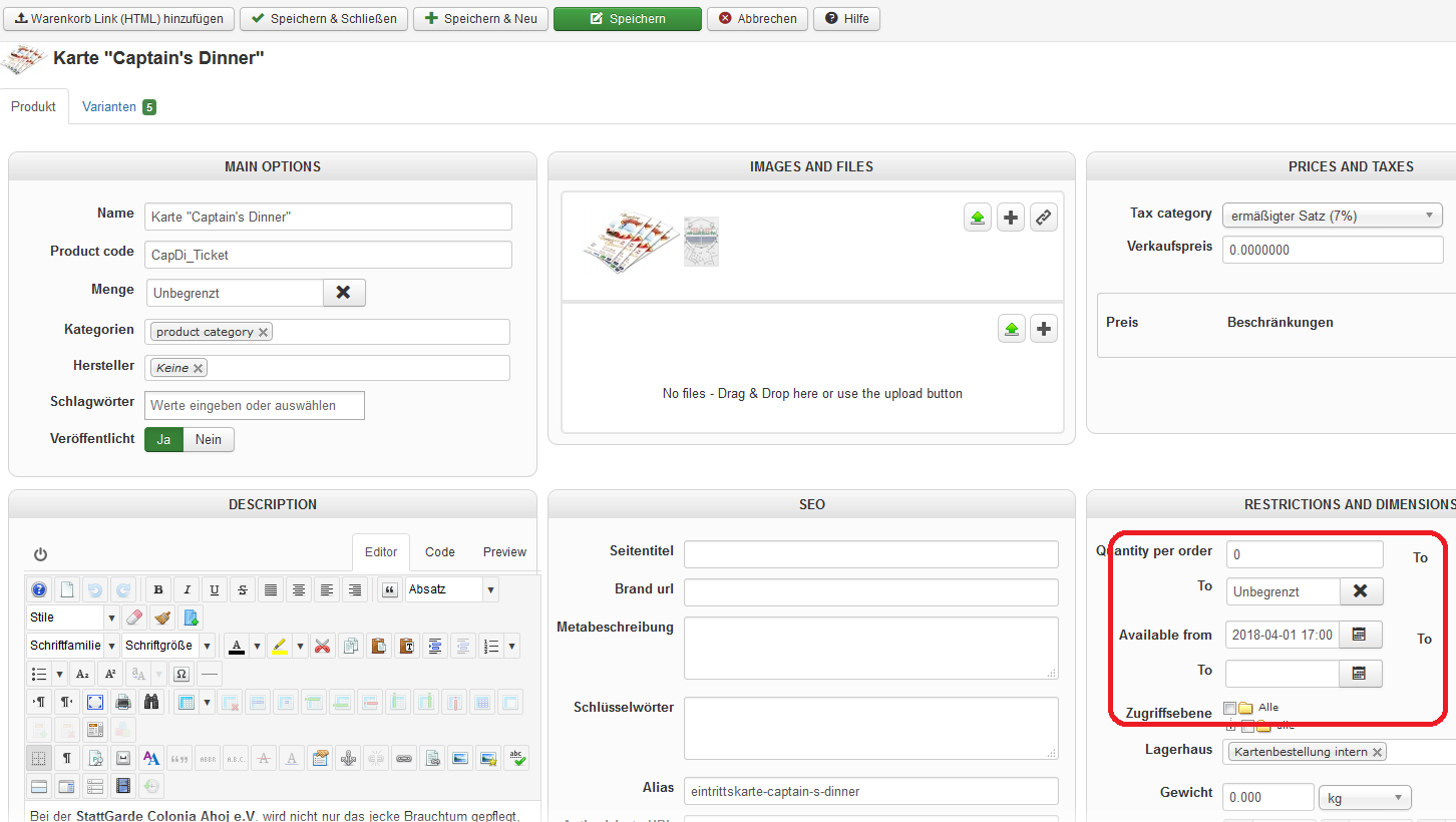

Hi togehter!

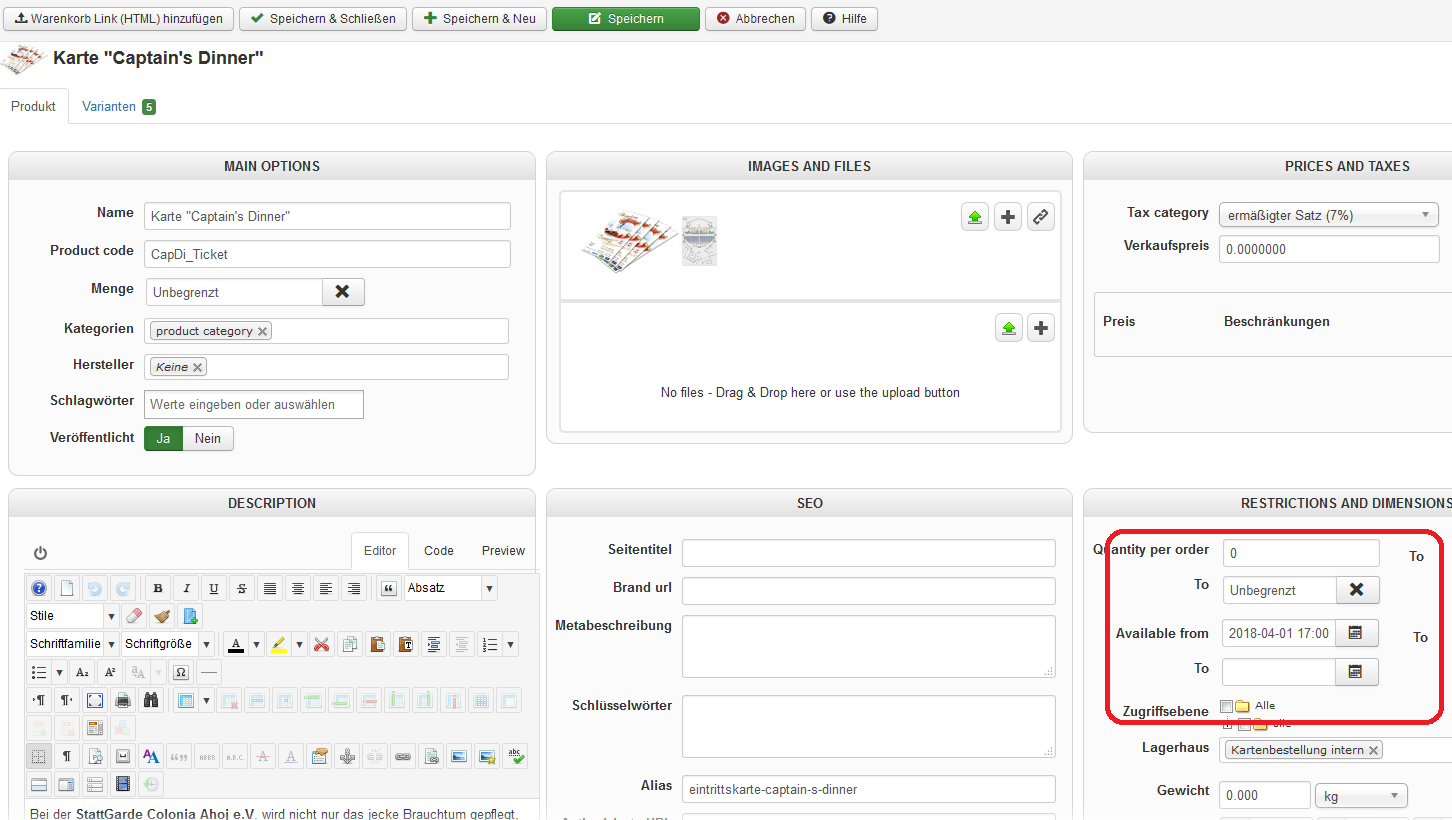

The restrictions and dimensions are not working properly anymore - I guess since one of the last updates. Every time I try to define a date and hour to start selling - the time changes every time I press "SAVE".
For example: start selling should be 2018-04-01 14:00 - I press SAVE and the hour increases to 15:00 - press SAVE again it is 16:00 and so on.

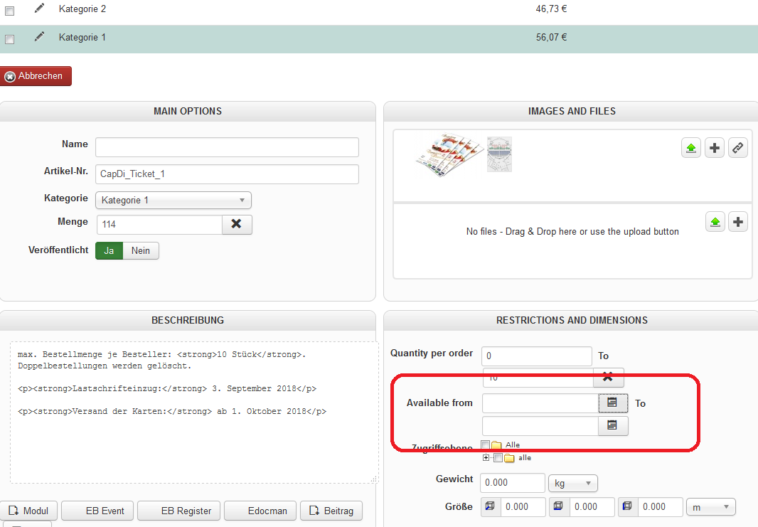

another problem: if I try to set different dates for the variations - the calendar is not opening anymore. The only possibility is to type in.
and guess what: after saving changes the time has increased about 1 hour :-)))))
Might it be possible to fix that bug?

Our timezone is still "Berlin, Germany" and when starting with hika business 3.1 there haven't been these kinds of "problems". What makes me a bit suspicious is the fact that the time I set changes everytime I press save. Even without any change has been done on the product details - the hour changes after pressing SAVE.
Concerning the calendar
It's a bit strange. On the products main page it opens when clicking the icon - on the products variants page it does not open. So I don't think that the reason is the javascript.... :--)

2. It's not possible that it's not a javascript problem. The calendar system uses javascript to display itself. If there is something not working with it, it can only be a javascript issue.
Are you able to reproduce the issue on our demo website ? If yes, it might be linked to a javascript issue with your browser (which version are you using and which browser ?). If no, then it might be linked to a conflict with something else on your website and I guess we'll need a backend access and FTP access to check on the issue directly on your website.
