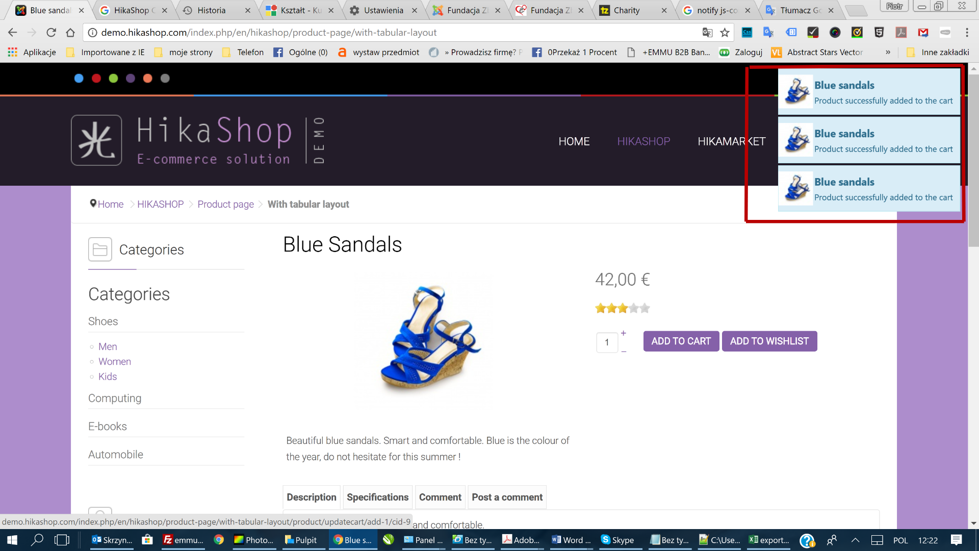

I warmly welcome.
When adding to the cart I would like to have a pop-up window like in the picture.
I do not know how to set it.
Regards.

8 years 5 months ago #289384
In the Joomla backend -> Extensions -> Plugins look for the "HikaShop Add to Cart notification Plugin".
Make sure it's enabled and configured to your liking.

8 years 5 months ago #289392
The thing is, you're use the "legacy" add to cart system.
The plugin is only working when you're using the new add to cart system (added in HikaShop 3.0).
www.hikashop.com/support/documentation/5...html#advanced_legacy
www.hikashop.com/home/blog/357-hikashop-3-0-beta.html
