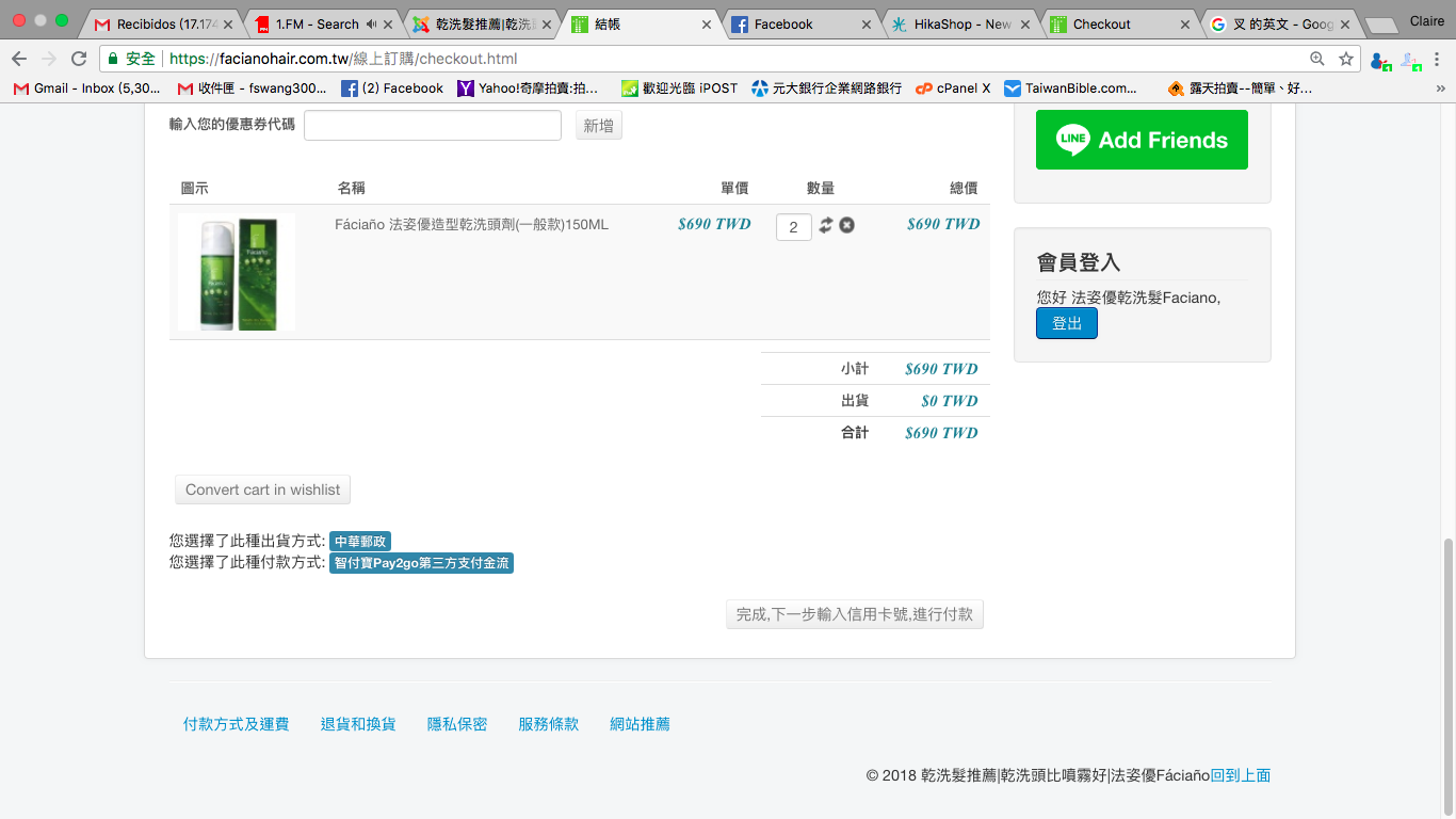

Hello dear,

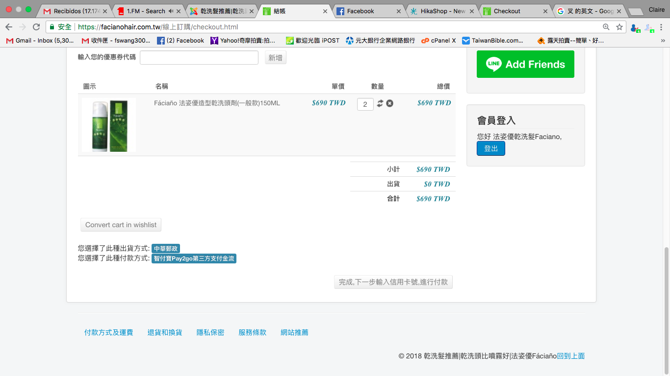

The order can't change the quantities even clicking circle or cross icons before payment. Do you know how to fix it? Thank you so much.

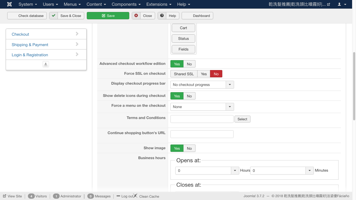

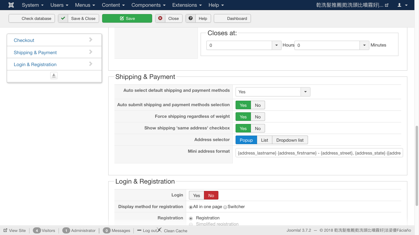

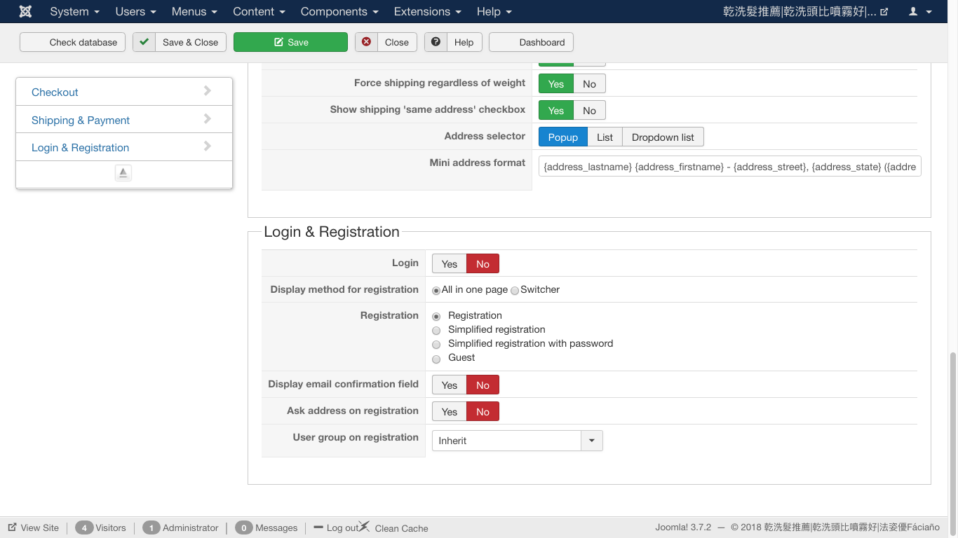

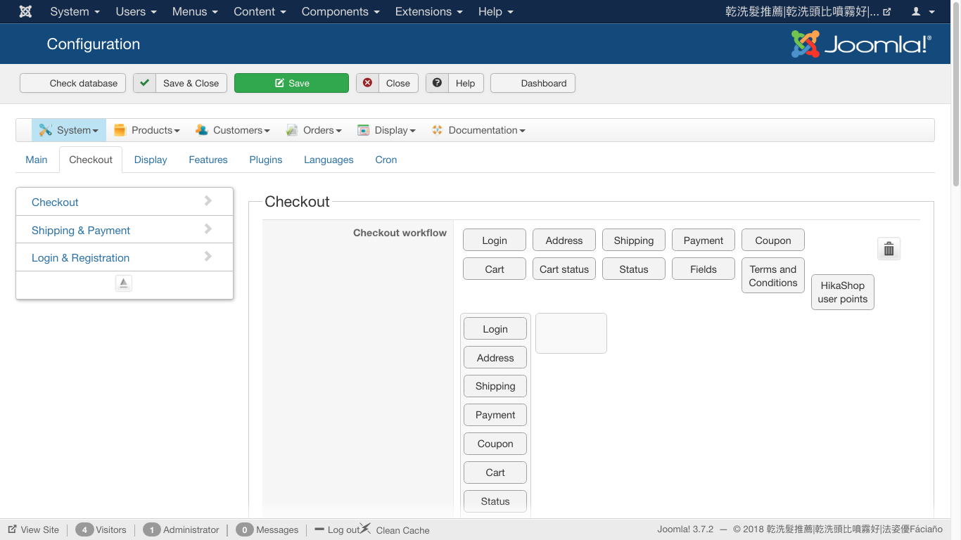

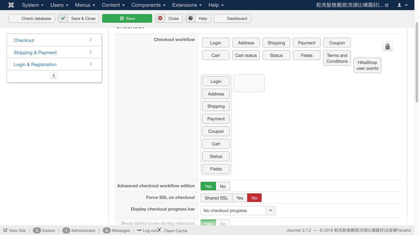

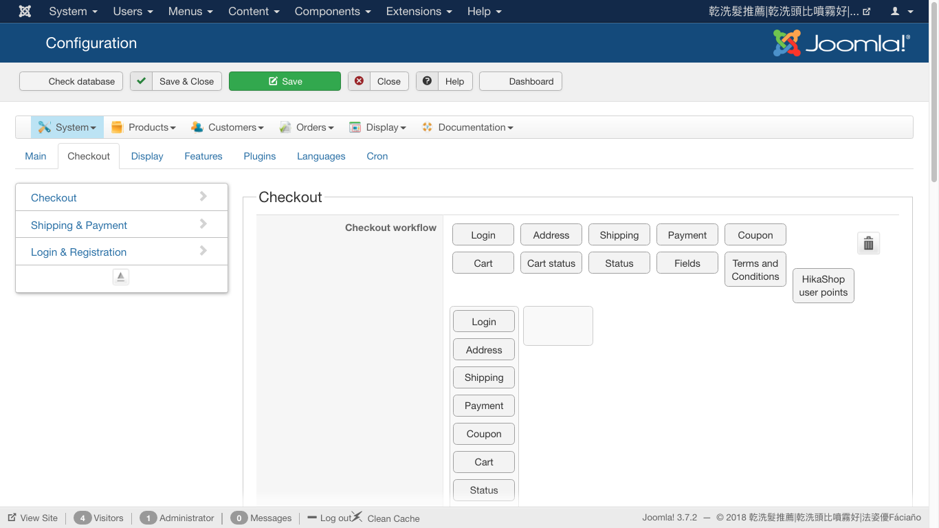

I process some tests on your website, for now I don't understand how works your checkout can you provide some screenshot of your Checkout Configuration (In Main HikaShop Configuration => Checkout tab) AND the Advanced configuration page (in Advanced tab).
Can you precise if you use some override view in the Checkout or other HikaShop webpage.

  • Posts: 220
8 years 4 months ago #291359
Hello Phil,

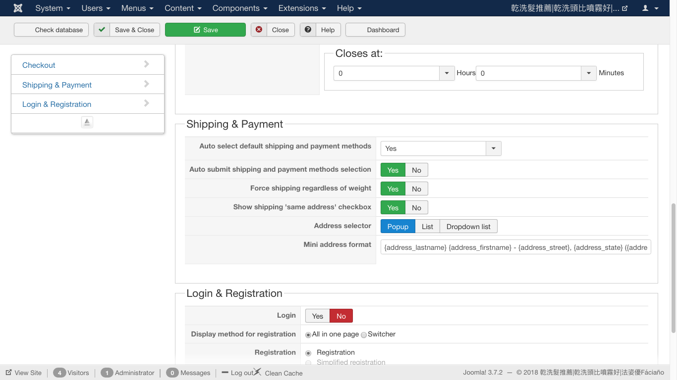

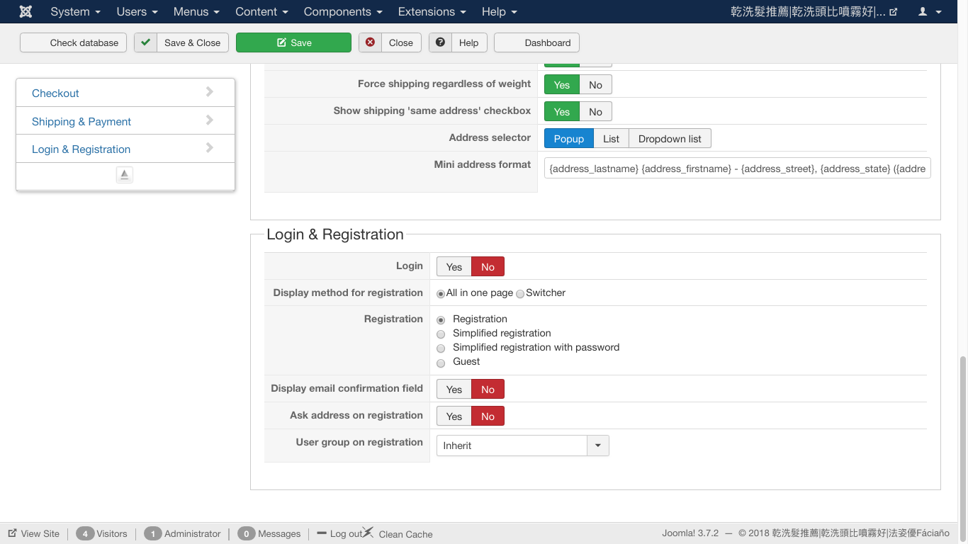

Thank you a lot watching for me, please see the attachment. I saw the Display I did some changes but I forgot what I did since it was long time ago. And I did some overwrite in the language.

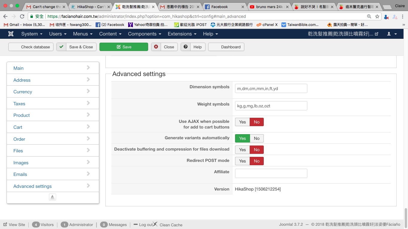

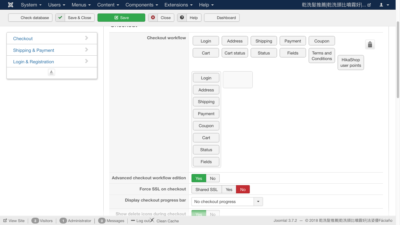

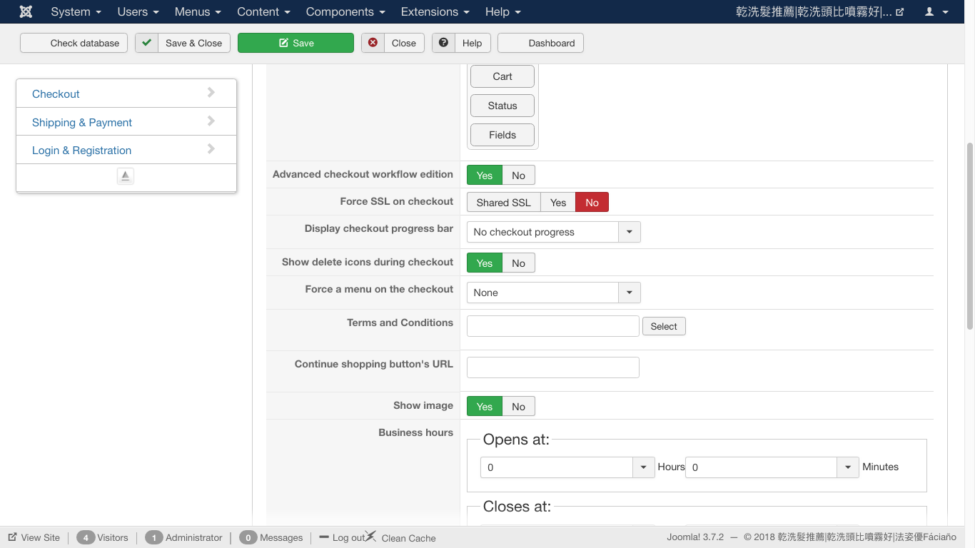

8 years 4 months ago #291364

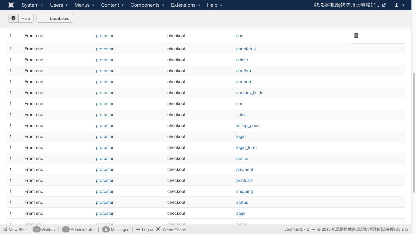

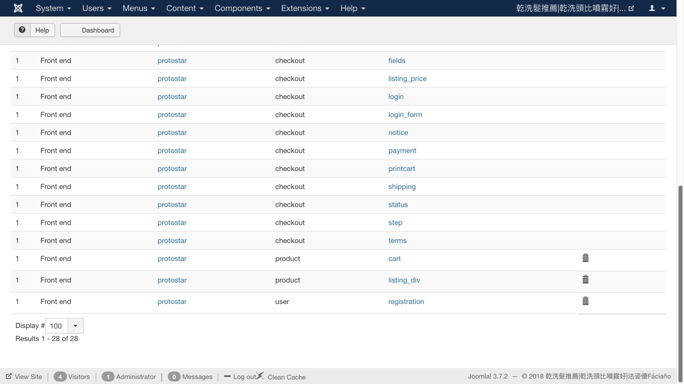

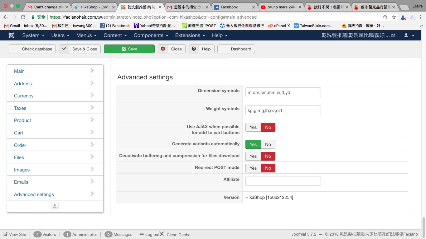

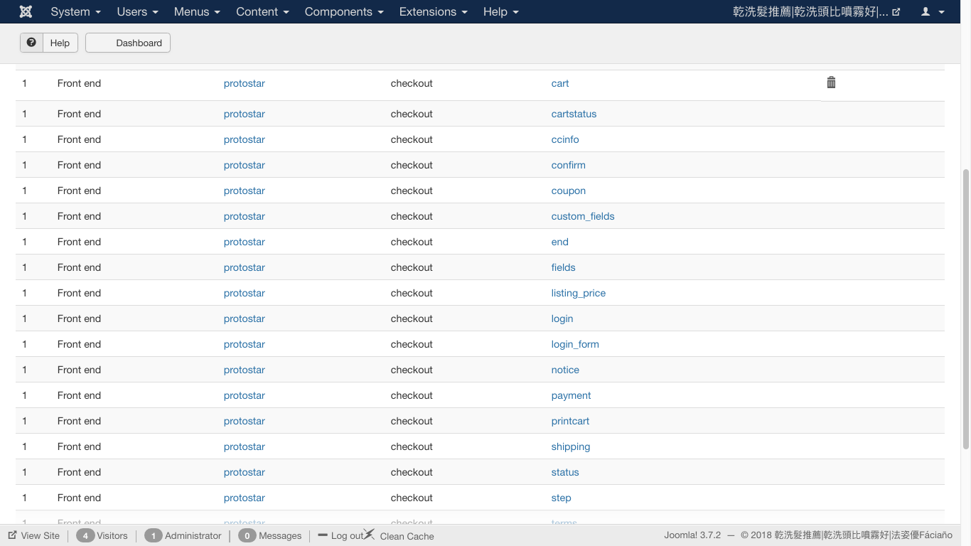

Please, I will need a complete page view (of the checkout tab in several screenshot if you want) AND as asked, I will need the same things for the Advanced tab.

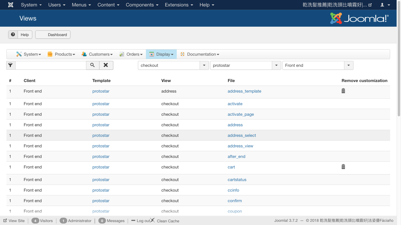

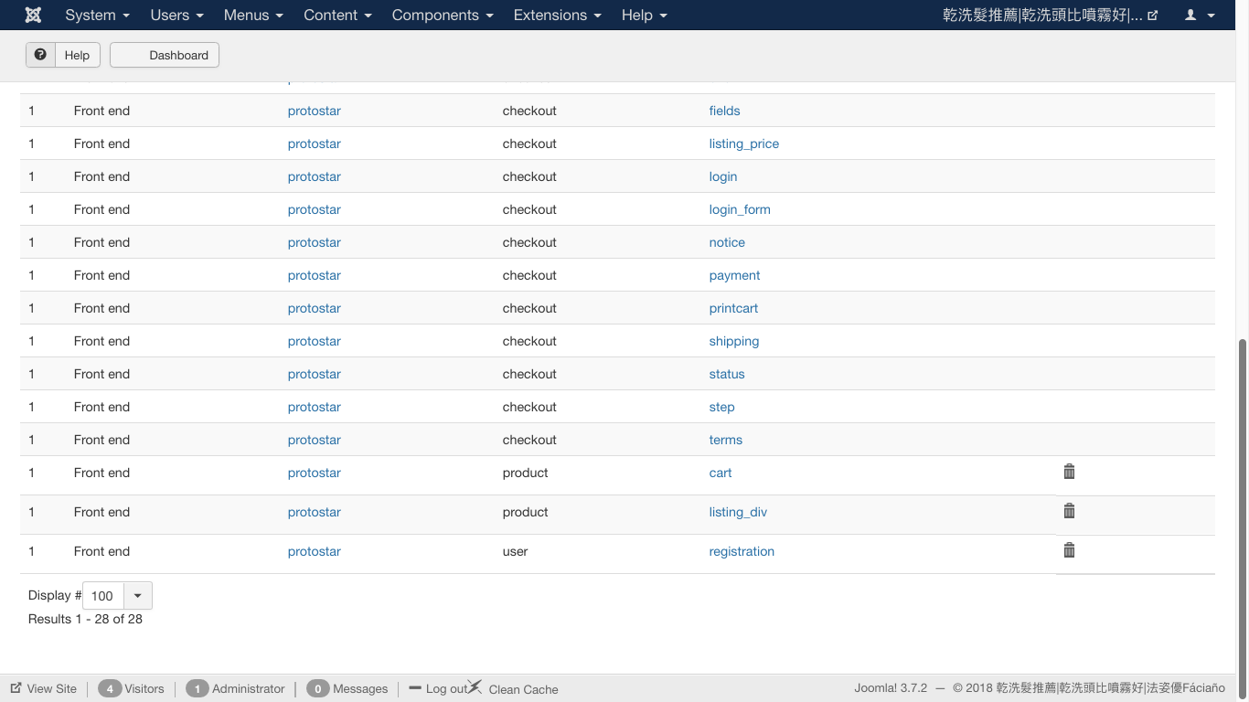

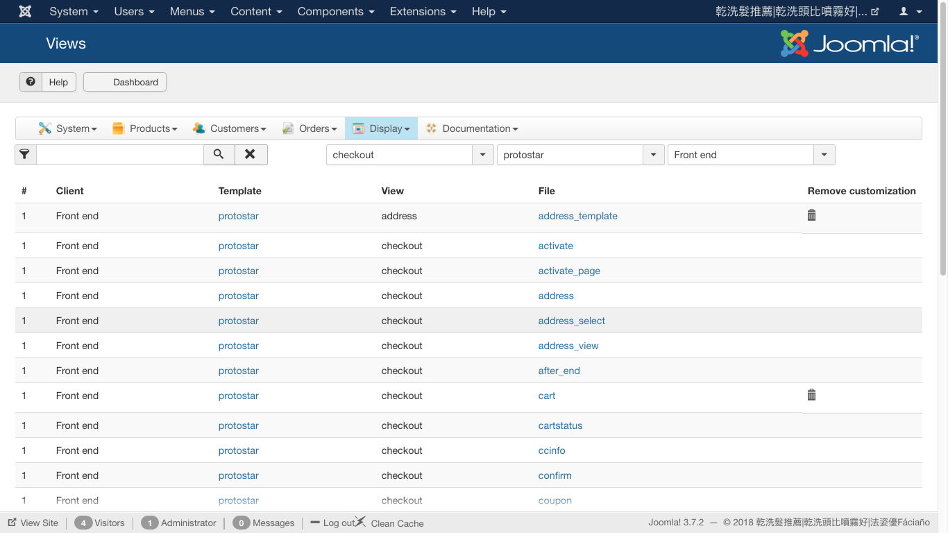

Other point, check that you haven't an override in Display dopdown => Views, like on this screenshot, take care to filter your view with the 3 dropdown filter with Checkout/YourTemplate/Frontend.
If you can see a little trash icon that mean that you have some modification in your HikaShop View code maybe some of your code is outdated or leads to this issue, because on our side everything works well.
Awaiting news from you.

  • Posts: 220
8 years 4 months ago #291504
Hi Phil,
Your website dies for two days, so I reply you today. Thank you so much, please see the attachment. So I need to remove all of the trash cans edit?

8 years 4 months ago #291509
What's interesting is that if you aren't logged in yet, changing the quantity of the products in the cart works fine on your checkout.
So I see that you're using actually HikaShop 2.5.0
Please understand that it isn't made to work with recent versions of Joomla.
So I would first recommend updating to the latest version of HikaShop.
Philip was thinking that this issue might be caused by some modifications in the views of your website. I don't think it is, but it's still worth checking. Just switch temporarily to the default template of Joomla and do a test. If it works fine, then it's indeed a template related issue and renaming the folder templates/YOUR_TEMPLATE/html/com_hikashop/checkout/ should help.
If it doesn't work even with the default template of Joomla, then the issue is a bug and updating HikaShop should help.
