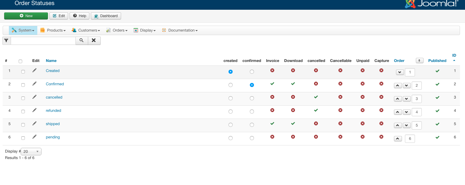

Hi, our ecommerce shop is user can receiving both order created and order confirmation email, but admin can only receive order creation email, order confirmation email unable to receive. please advice which part is affecting this part? we did not touch anything on email configure and order status.

Hi there. Thanks for the reply.
The weird thing is, the payment plugin that we developed acknowledges the payment signal and update the status of the order from pending to confirmed inside the database. Its just the hikashop email on the status notification change is not received.
The payment notification email address is filled in. the same value as the Order creation email field value. Thats why we find it weird why the order created email is received but not the payment notification one.

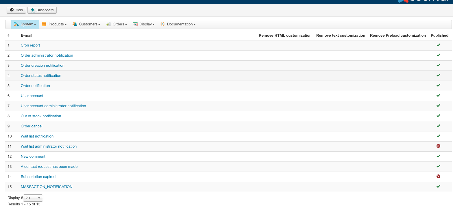

8 years 3 months ago #293070
The "order administrator notification" is sent when the order is created, not when the order status is changed.
If you want to send it within some code on your end, you can add such code:
$orderClass = hikashop_get('class.order');
$mail = $orderClass->loadNotification((int)$order_id, 'order_admin_notification');
$mailClass = hikashop_get('class.mail');
$mailClass->sendMail($mail);
