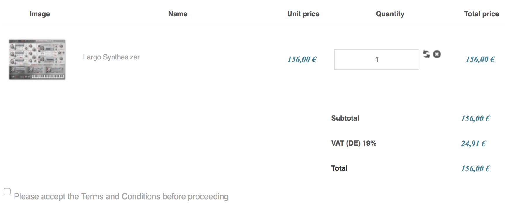

-- Joomla version -- : 3.8.3
-- PHP version -- : 5.5.38

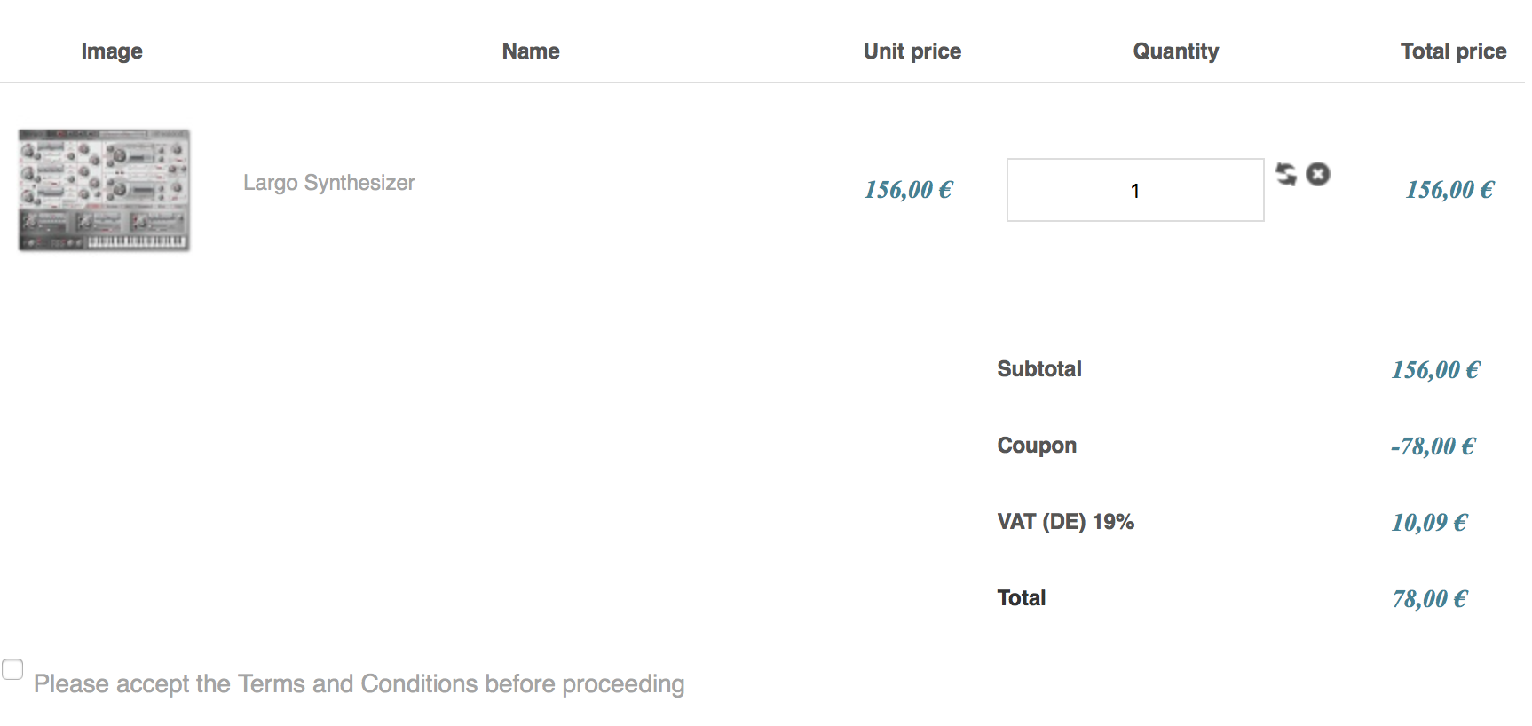

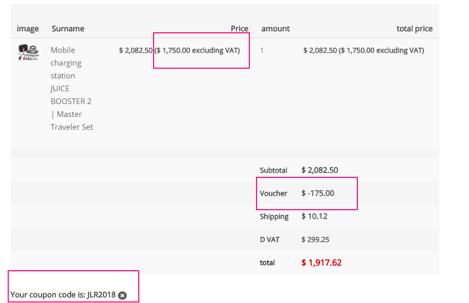

There is a problem with coupon calculation.
Apply discounts is set to before taxes.
The coupon is calculated good but on the total sum the discounted amount is still taxed.
If I switch from coupon to discount, it seems to be working well but going back to coupon it is the same problem!
On the pic below the tax is DE 19%.
Coupon value 10%.

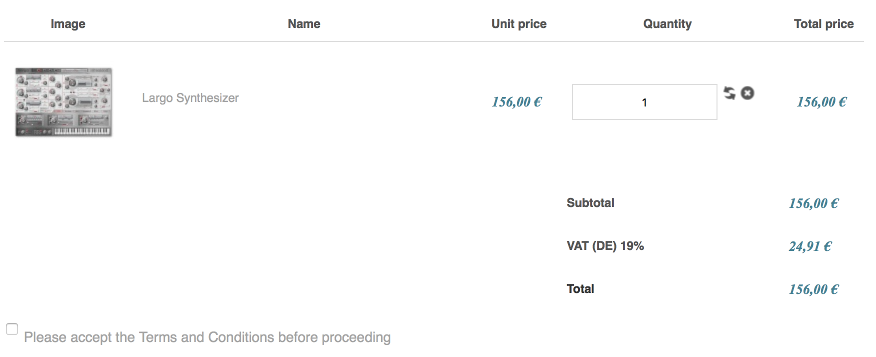

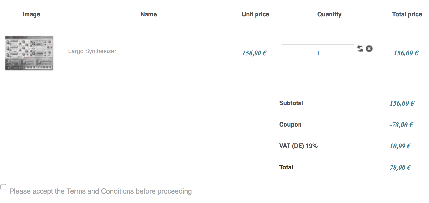

8 years 1 month ago #294887

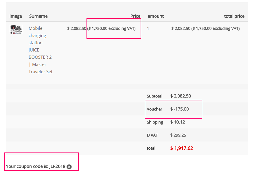

I have the same problem wit 3.4.1
Looks discount calculates taxes correct, but coupon doesn't.
I attached 4 screen shots to show the problem.
Hope you can help, because I just corrected over 100 invoices...
Roger

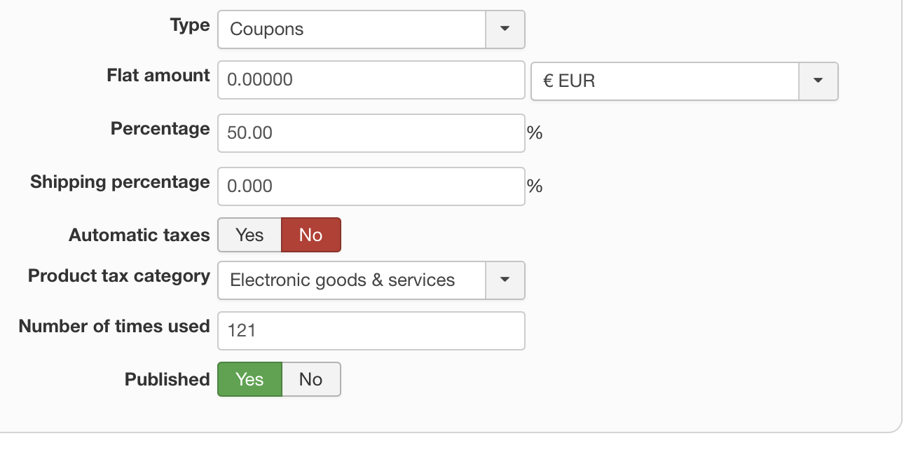

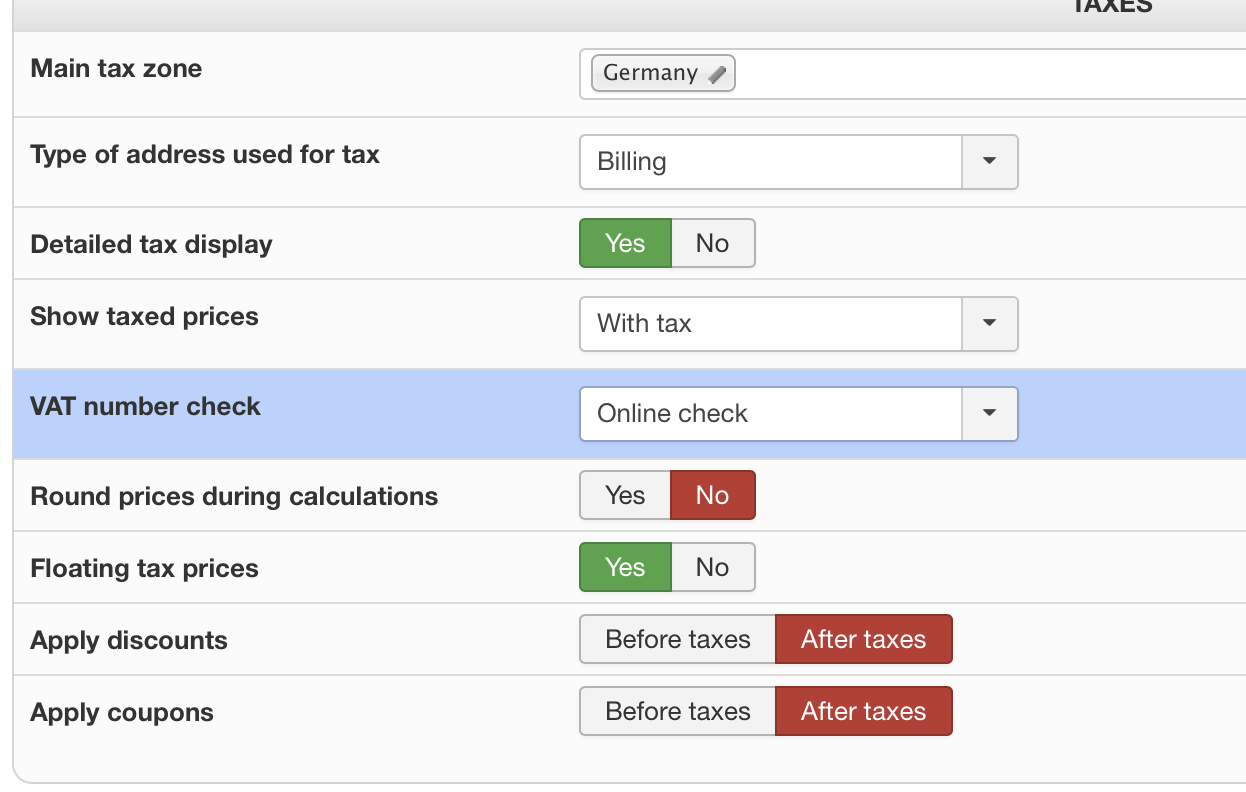

I see that you selected the "Electronic goods and services" tax category in your coupon. Did you configure tax rules for that tax category ?
Also, you might want to try switching the "apply coupon" setting of the HikaShop configuration. Based on that setting, HikaShop will either used the taxed or the untaxed amount for the percentage value calculation.

yes, the whole shop works with the tax category 'Electronic goods & services'. I tried the coupon code with other settings as well and also tried the settings in 'apply coupon'. The result was always wrong, but only when using a coupon code.

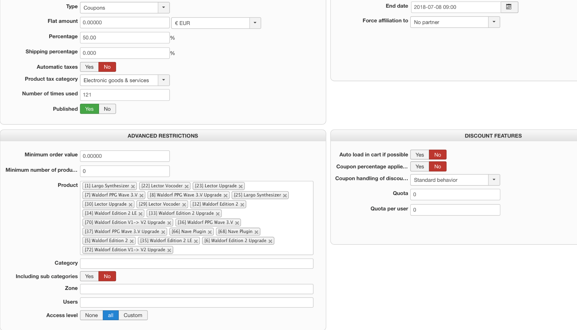

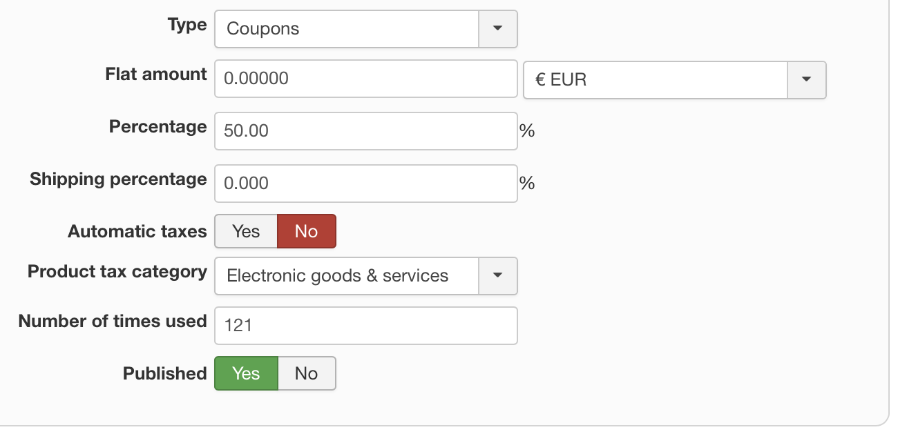

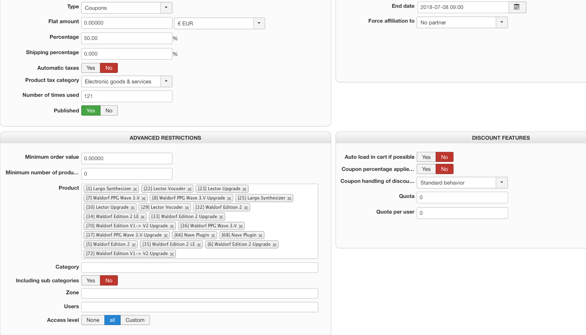

Ok, so for us to reproduce the issue, could you provide a screenshot of all the settings of that 10% coupon, and a screenshot of the settings of that "D TAX" tax rate ?
  • Posts: 159
8 years 1 month ago #295638
here is a screen shot of the coupon code. Where can I find the "D TAX" tax rate? I don't have it.
Roger

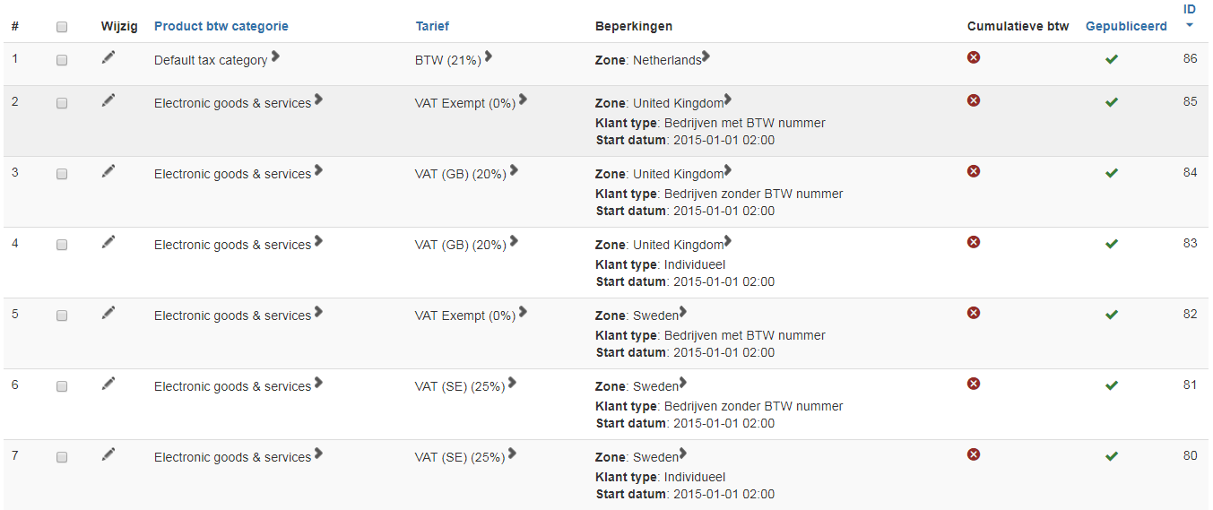

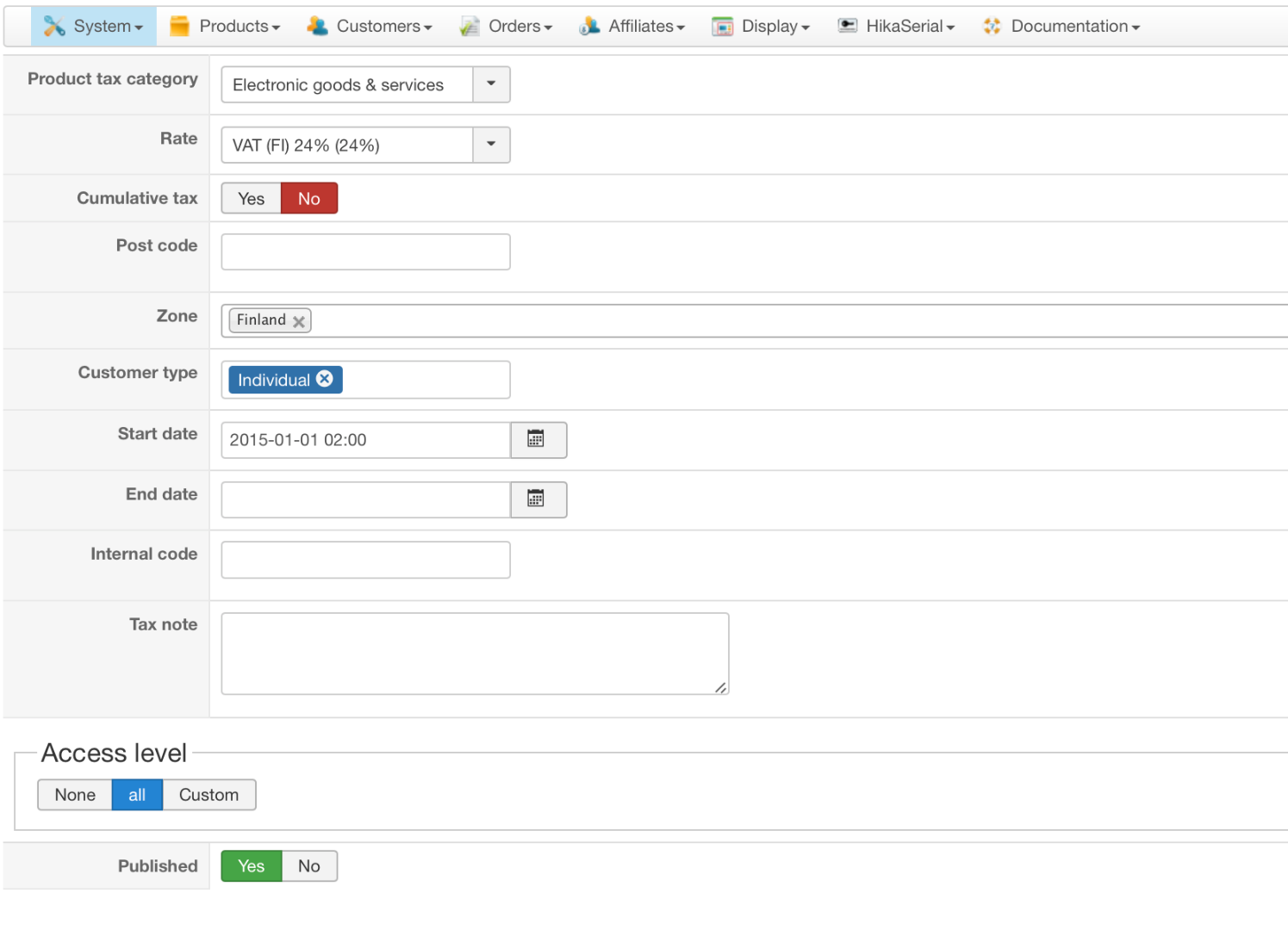

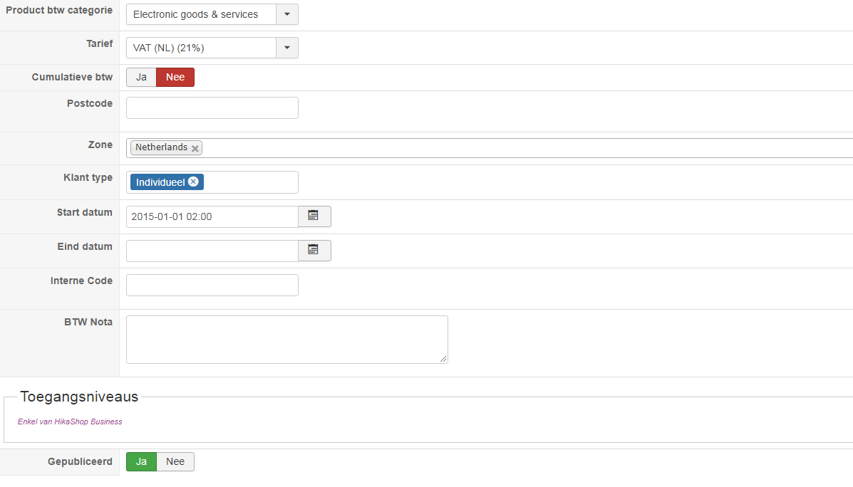

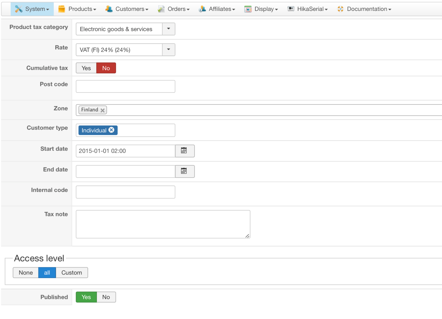

Go in the menu System>Taxes, edit your tax rule and provide a screenshot of the settings there.

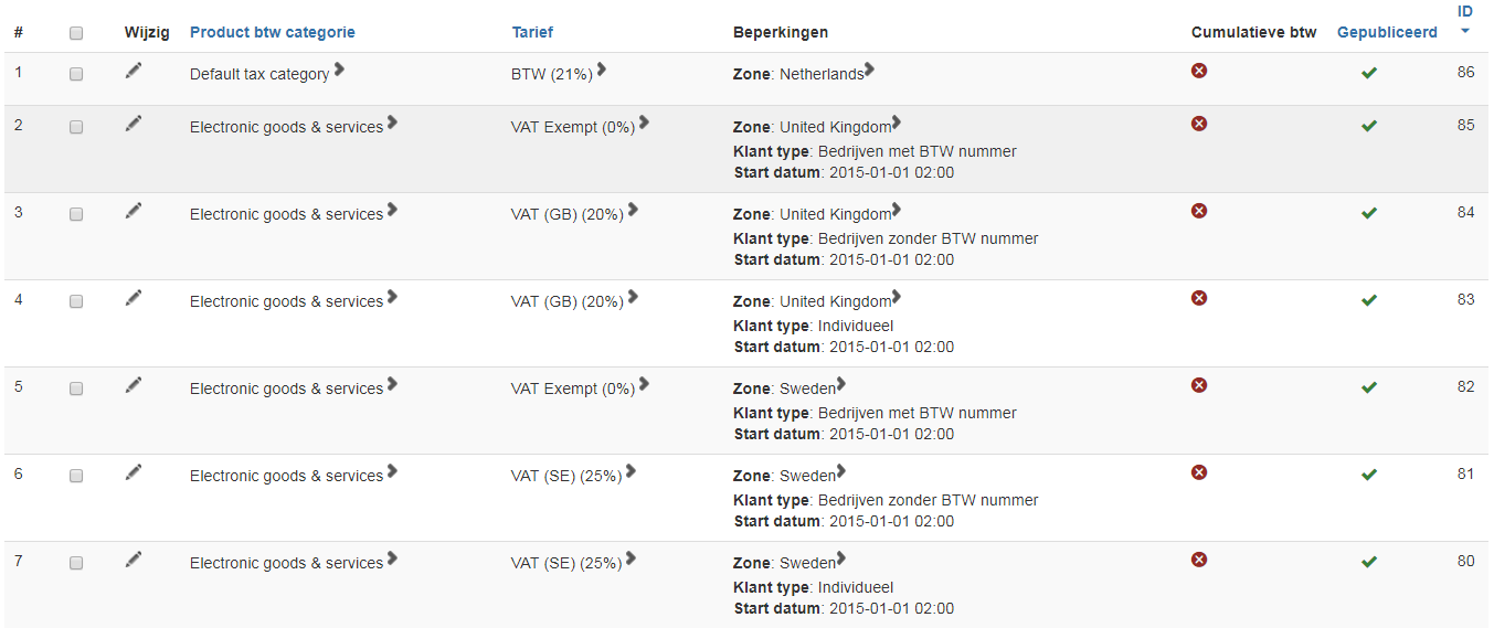

  • Posts: 159
8 years 1 month ago #295673
OK, I use the taxes for 'Electronic goods and services'. There are plenty. Here is one:

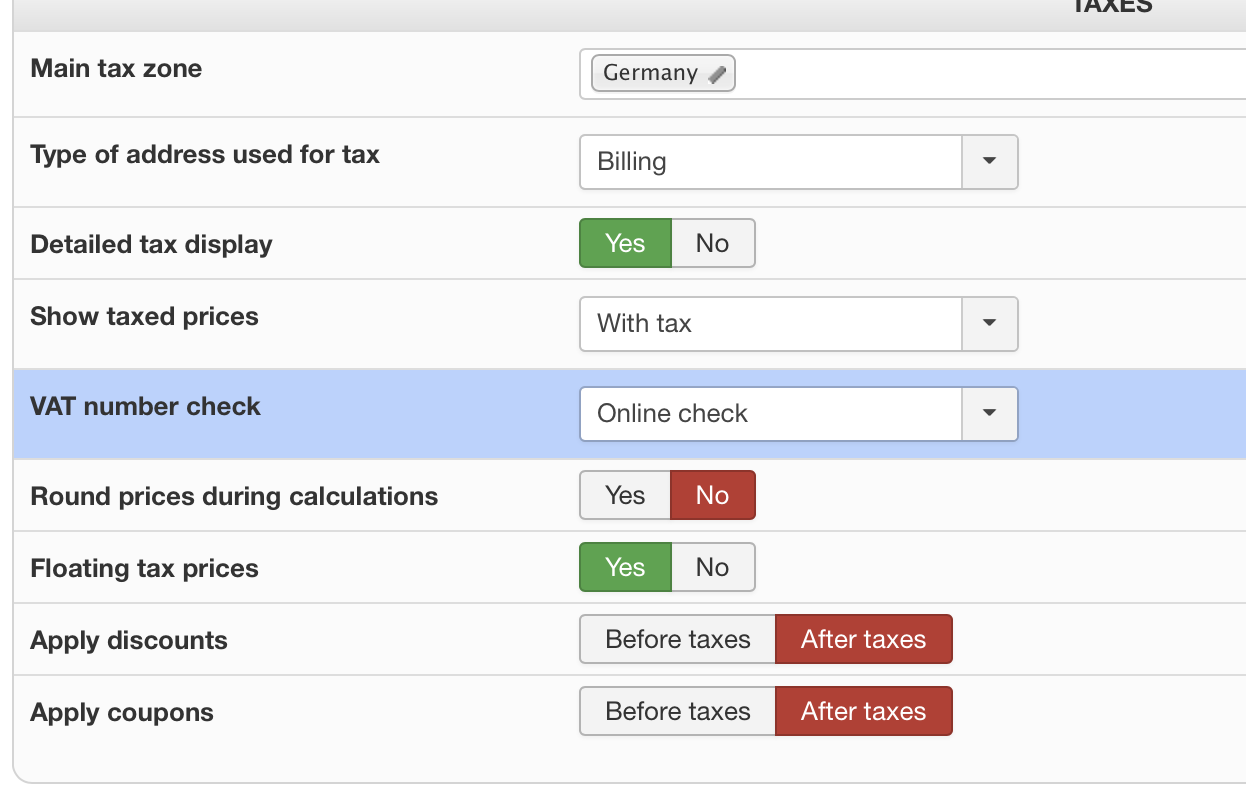

The issue is with the "floating tax prices" option which causes some issue with the tax calculations for coupons.
I've added a patch on our end for that.
Download again the install package on our website and install it on yours to get the patch and it should then display a correct tax amount even with a coupon added.

  • Posts: 86081
  • Thank you received: 14190
7 years 11 months ago #298350
Hard to give any guidance without precise details.
Please provide:

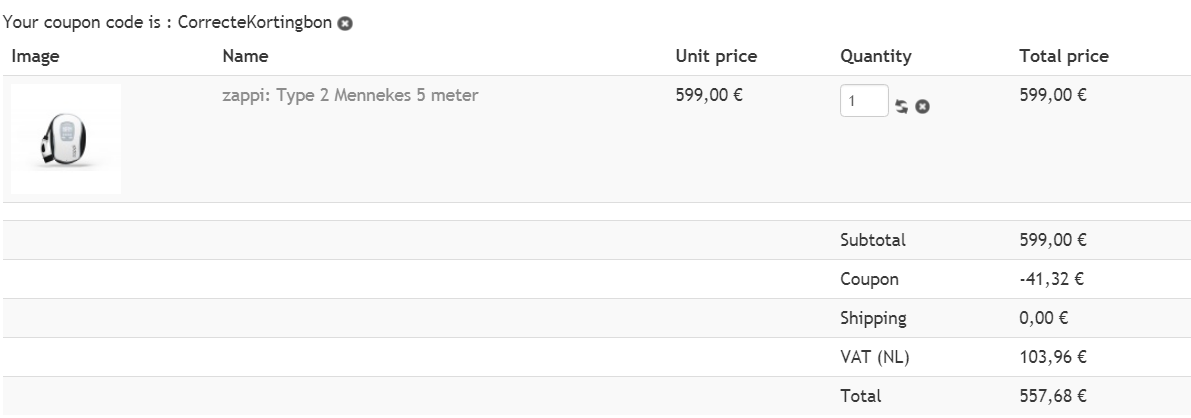

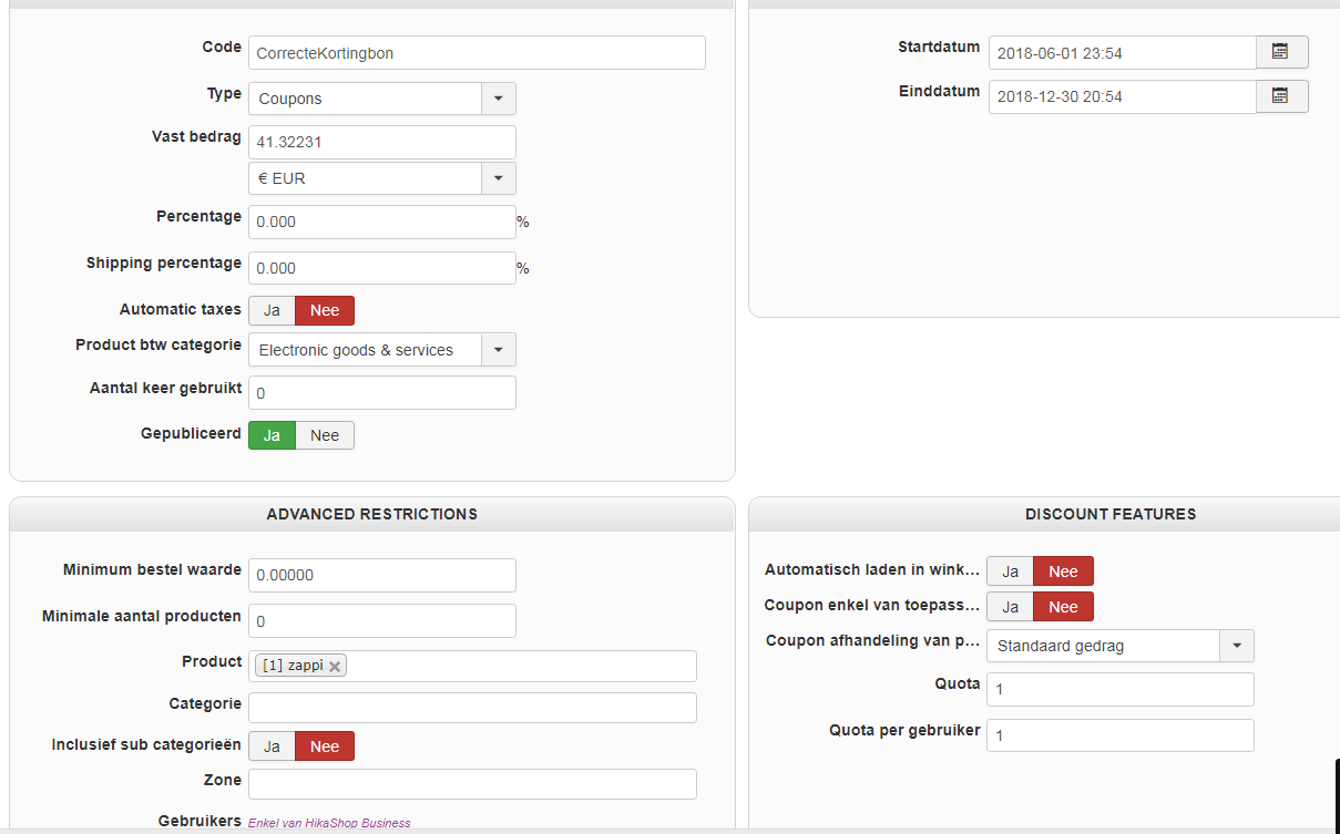

- a screenshot of the settings of the coupon
- a link to the shop
- precise instructions to reproduce the problem
- a screenshot of the menu System>Taxes
That will enable us to assess the situation.

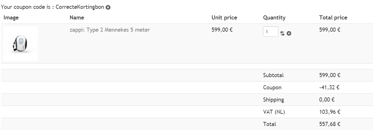

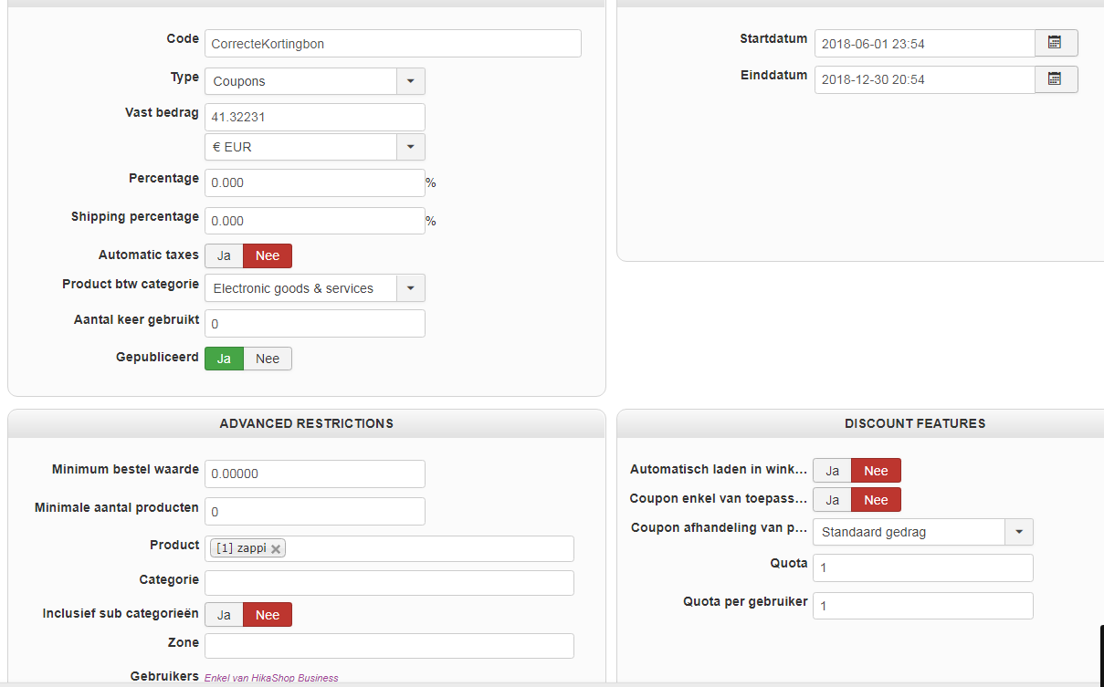

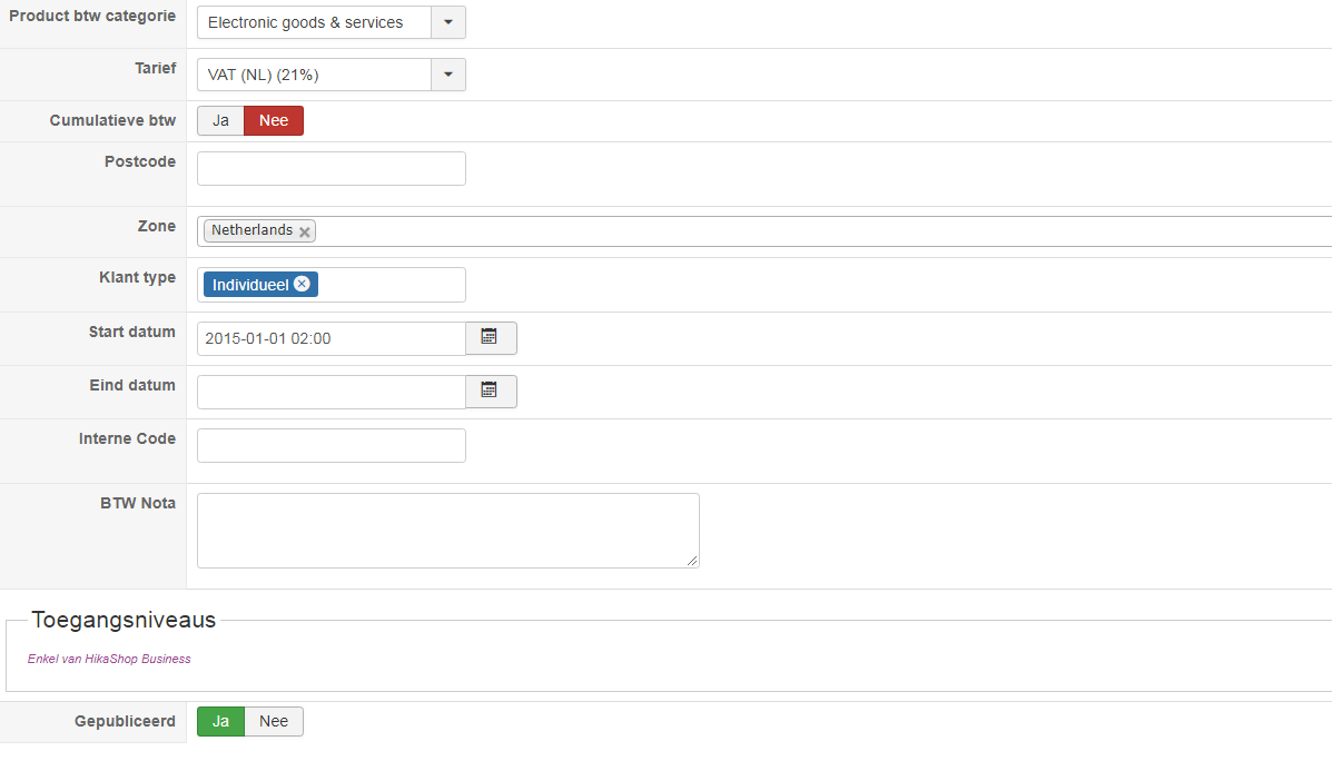

  • Posts: 7
7 years 11 months ago #298389
The coupon code is : CorrecteKortingbon
The link to the product is: www.zappi.info/en/shop/products/product/1-zappi
Once you have selected the product and then activate the coupon code in the checkout, you see that the amount is only decreased by 41,32 and not 50 euro. Also there is no decrease of the VAT.
See attached screenshots as you've asked for.
