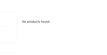

8 years 3 months ago #292615

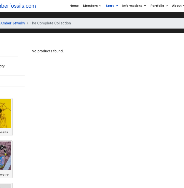

on a category if "search" return "no product found", the search "box" disappear and there's no way to display back
all the products of the category. I've try cleaning history, caches.....no way...
The only way to back to normal, is restart the computer
I certainly miss something here...
Thanks in advance

  • Posts: 56

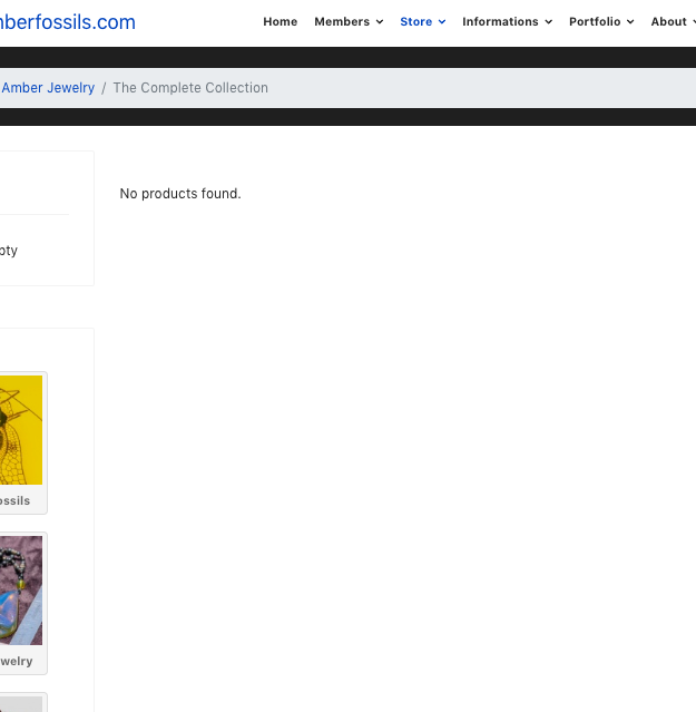

8 years 3 months ago #292658
Hi, thanks for getting back quickly
here is the link to the store, type anything on the search box like 1235678.... and you'll see
problem "stick" on the page the search was done, changing to another category, search box is available
weird...

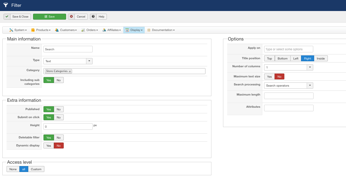

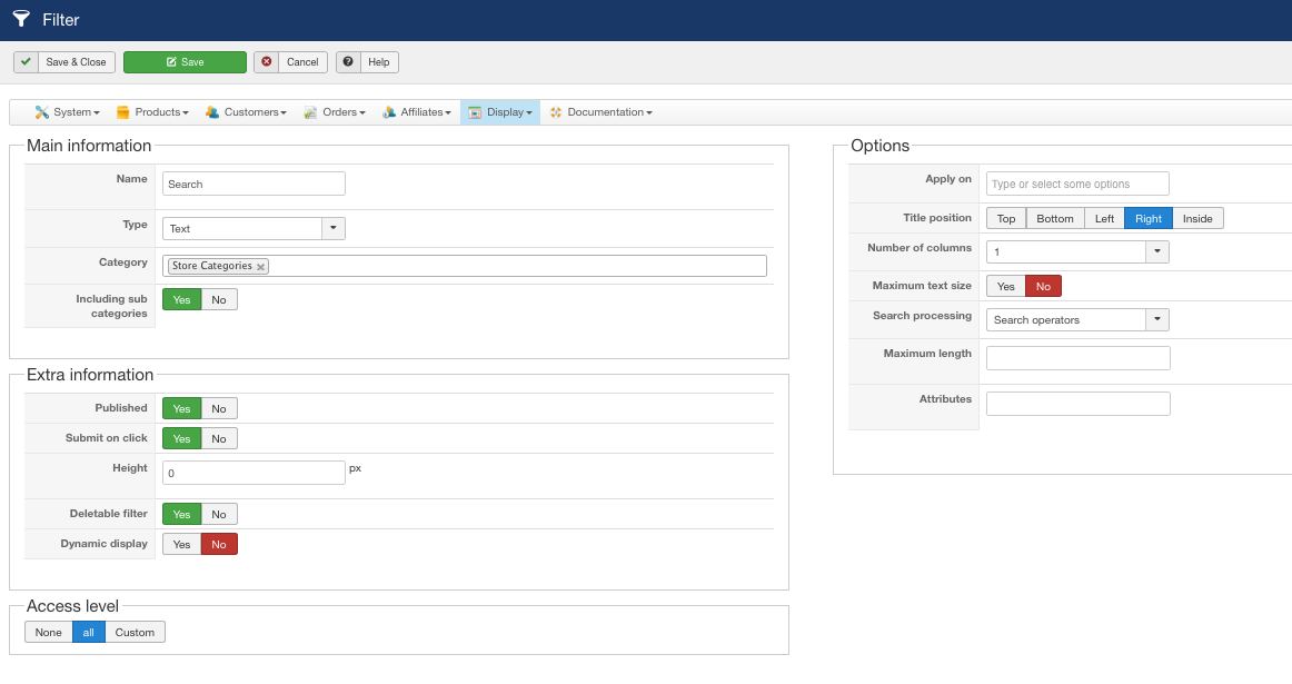

I add a pic of the filter settings as well in case...

8 years 3 months ago #292660
You didn't select any column in the "apply on" setting of your filter. So you're filter is searching on nothing and thus no products match.
I would also recommend turning on the "redirect POST mode" setting in the HikaShop configuration.
  • Posts: 56
8 years 3 months ago #292702
Hi thanks for getting back
Exactly, even without any fields selected on the "Apply on" options, performed search return a result with any valid product name or product code.
As per your recommendation, I add fields on "Apply on" (Product name & Product code) Nothing change, if there's no product matching with the info entered on the search field, filters disappear on the specific category search was performed with no other option to get them back than restart the computer....
I also turn on the "redirect post mode" according to your recommendations as well.....it stays same exactly...

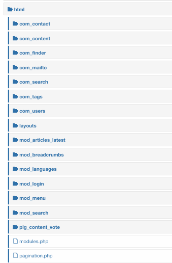

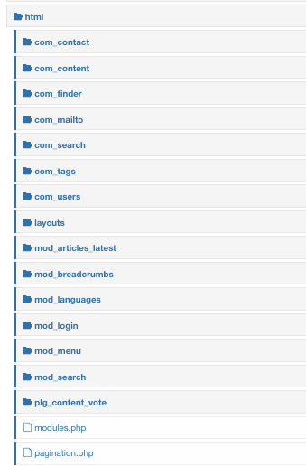

  • Posts: 56
8 years 3 months ago #292734
Hi. there's no com_hikashop folder in the template/html one
See enclosed the html folder structure as well as errors displayed in the chrome inspector
