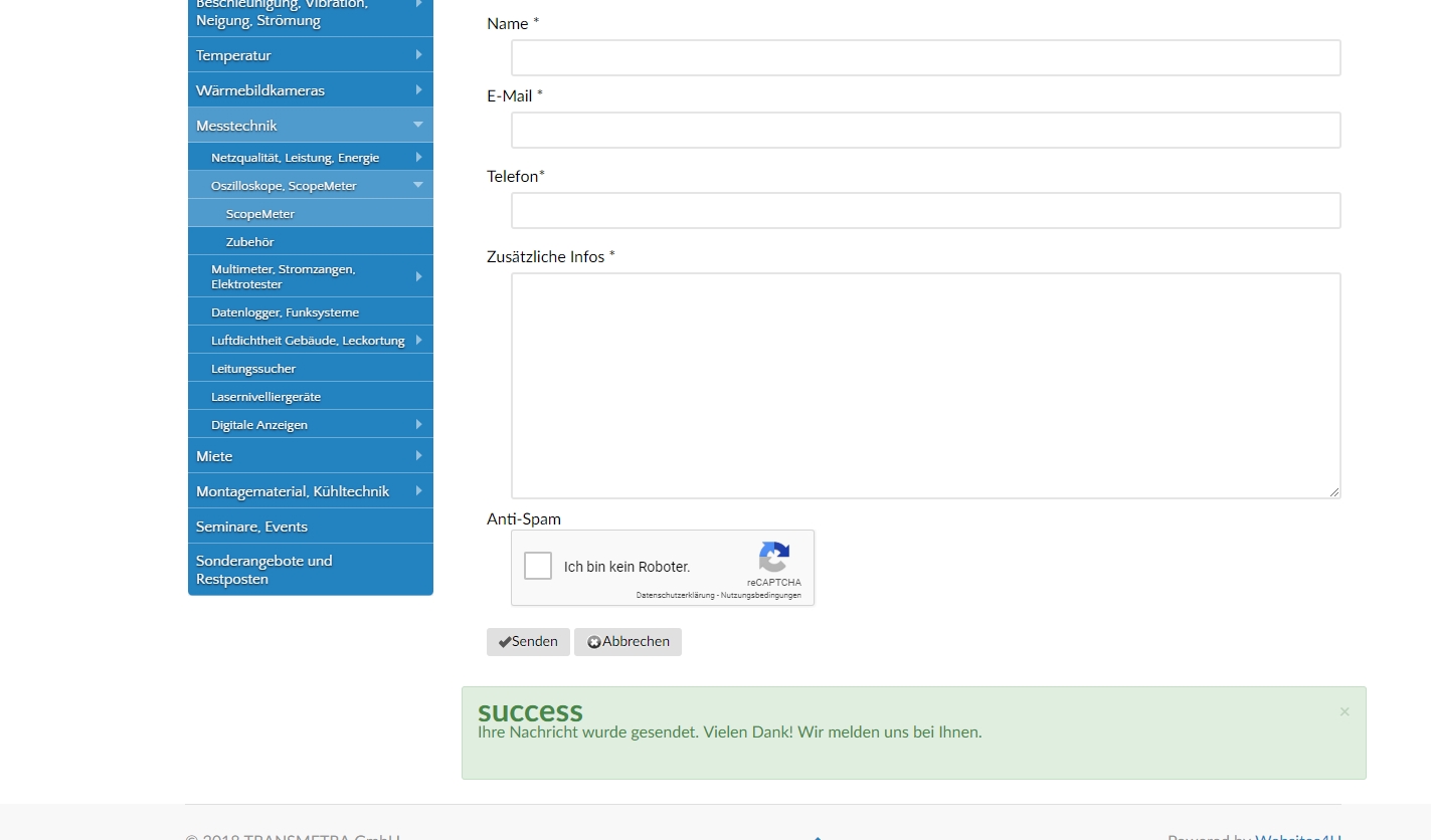

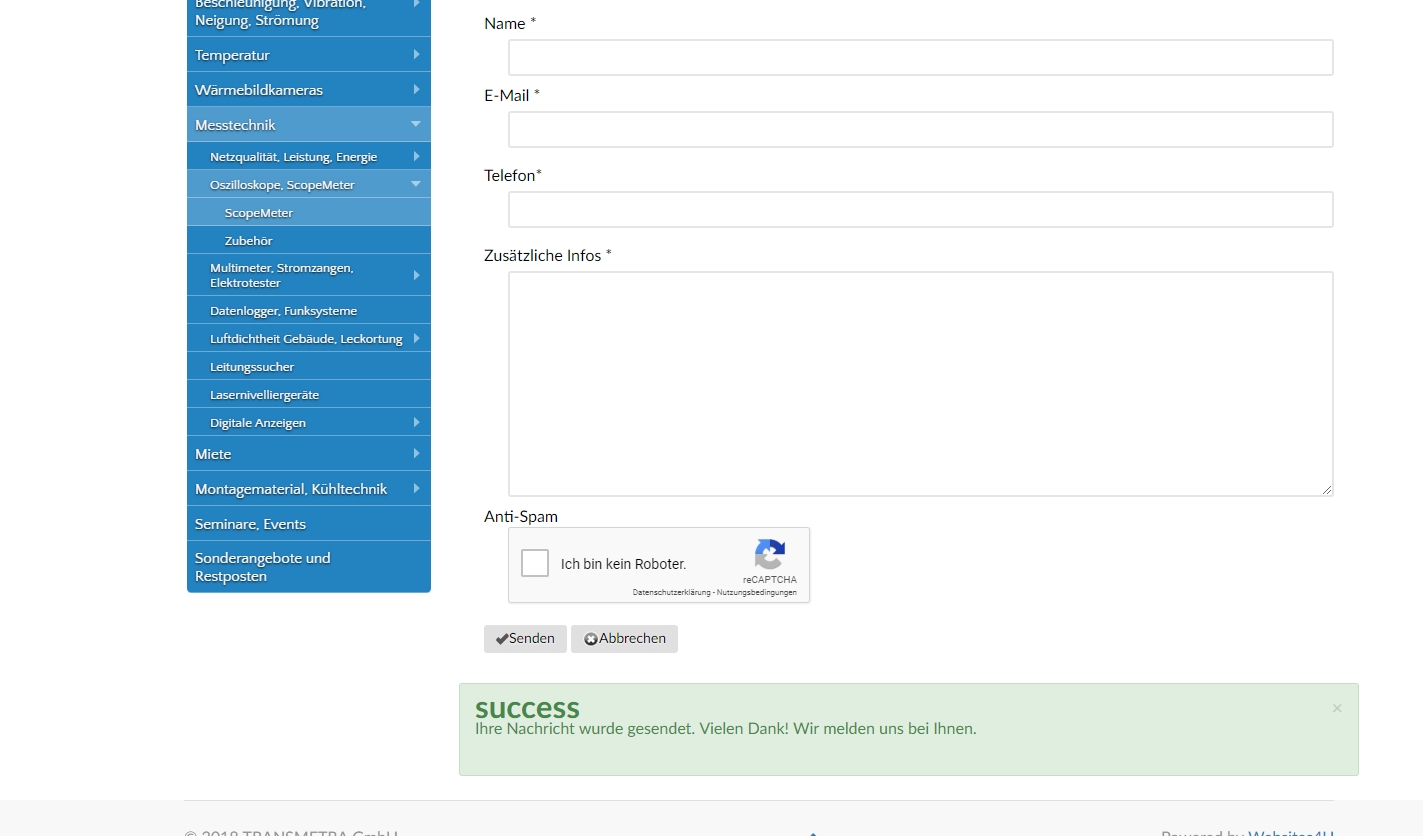

I've got that working, however, there is still the text "Success" which I can't find anywhere to change.
David
Last edit: 8 years 3 months ago by transmetra. Reason: Added file
  • Posts: 86081
  • Thank you received: 14190
8 years 3 months ago #292944
That text is added by your template. HikaShop only sends the message and the type of the message to joomla so that the template can display it.
So it depends on how your template is made.
The easy solution would be to add some CSS to hide that title.
Otherwise, you'll have to ask your template provider on how to change that text.
