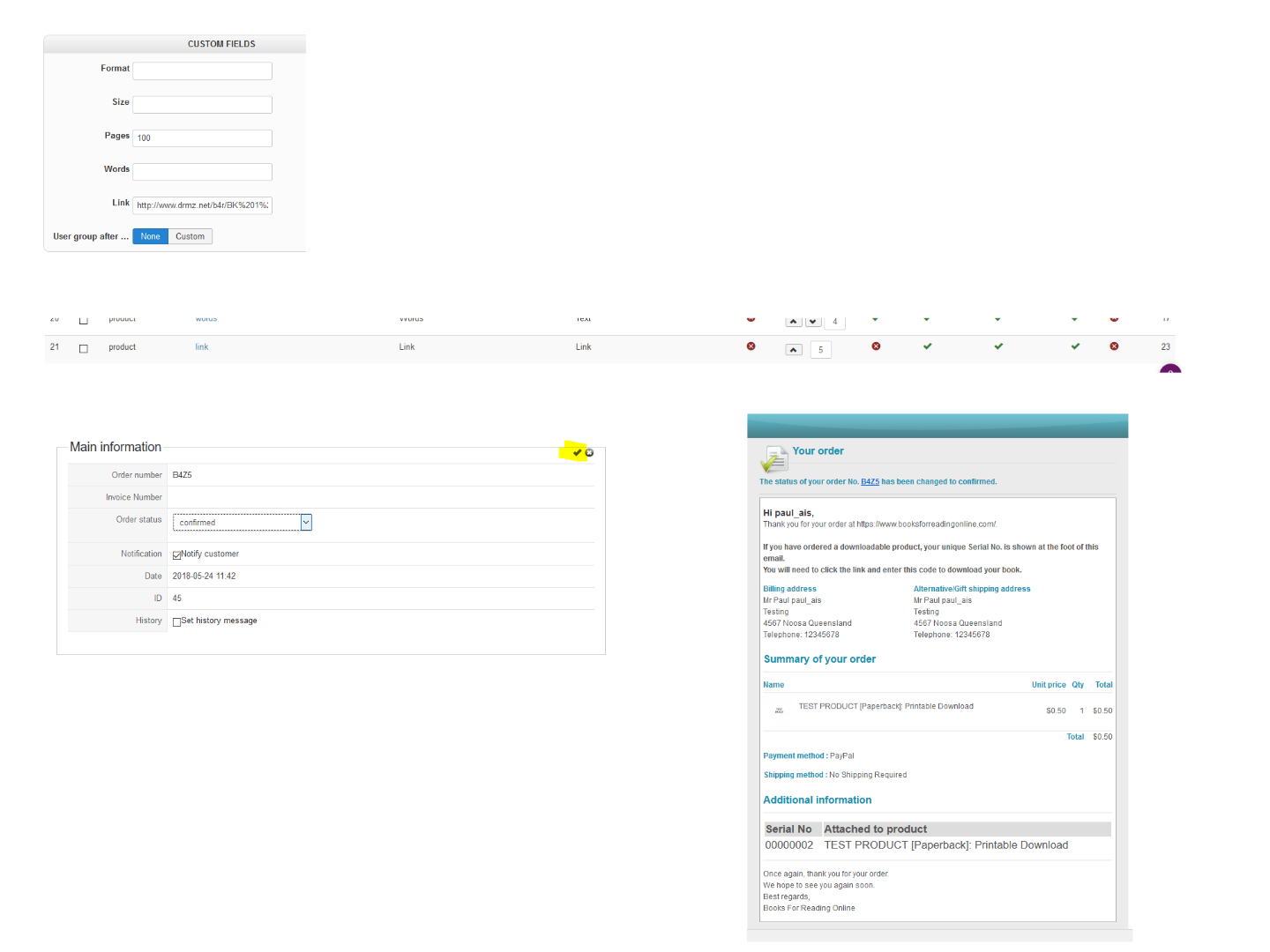

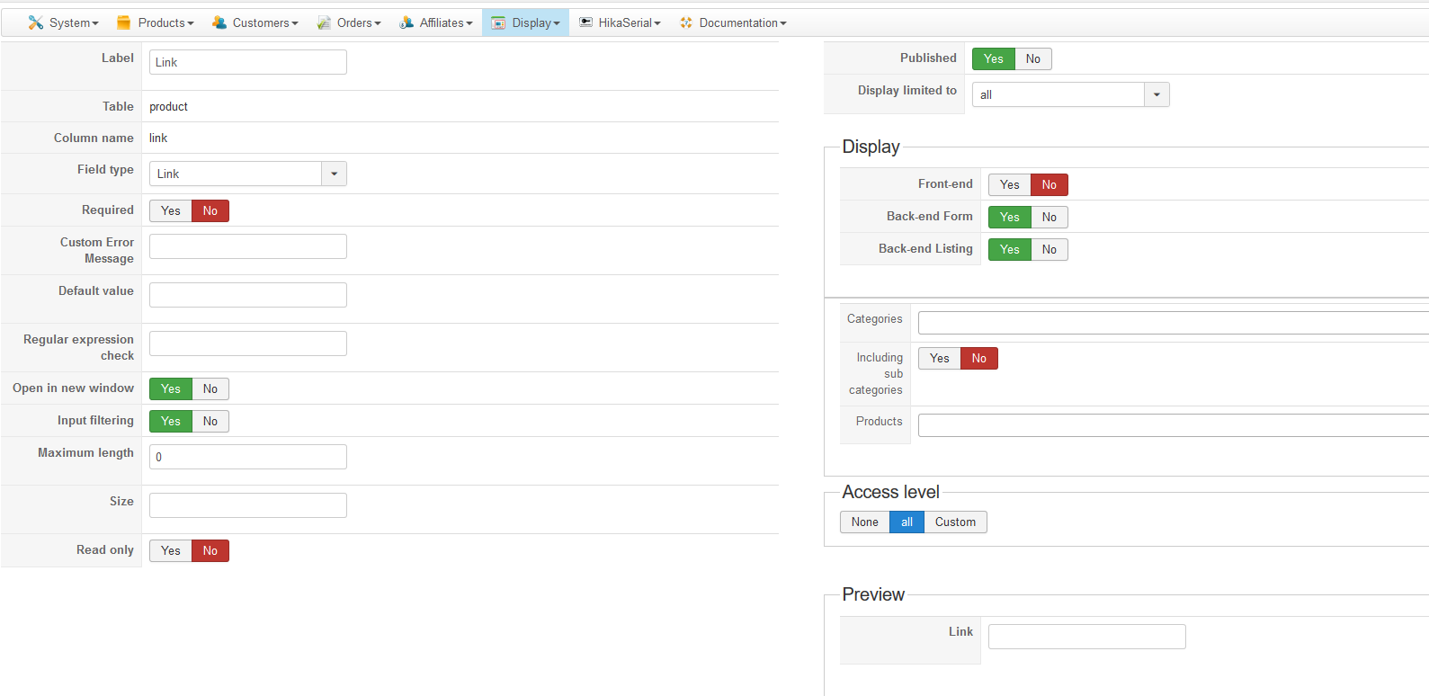

Hi Nicolas I followed your advice and:
* Set up Custom Field of type Link.
* Set to Front-end 'No'
* Added a link to the 'Link' Custom Field in the Variant of my product.
* Purchased the product and changed order status to Confirmed.
Confirmation email does not show the link.
Please see the attached screenshots.
Is it perhaps because this is the 'Printable Download' Variant of my product ?
Thanks again for your help.
Paul

In the settings page of the custom field, you're supposed to have many settings for the display of the custom field in the emails.
These are not present on your screenshot.
That means that you're using an old version of HikaShop which doesn't support the display of the custom product fields on the emails.
So you would have either to update and activate the display settings of your custom field for the emails, or you would have to customize the code of the emails via the menu System>Emails and add custom code of your own to display the custom field value there yourself.
