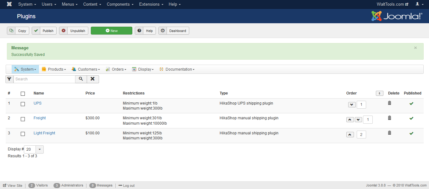

Now any orders with multiple pieces get the error - The cart items combined weight is too small for all the possible shipping methods - ups plugin appears to be correct, unchanged from prior to update. UPS Plugin is set to calculate orders up to 500 lbs, group or NO group packages does not fix. Many abandoned carts and angry customer calls due to this. The products all have weights. I have a generic freight plugin enabled for 300 plu pounds because I do alot of heavy stuff. But if the weigth is only combined to 200 lbs, no ups shipping. Single packages still okay.

I have tried both minimum weight as zero or one pound. Neither fixes the problem. It only happens when there are multiple items so I tried grouping and not grouping, with both minimum weights. No fix. This problem started right after the last update so it should not be a config issue since that was already established and the error was never present. The only change was the update.
Let me know what else you need to see or I can let somebody look at the config specifically.
Since I wrote the above, I have even removed ups restrictions so weight is not in play. Not fixed.

I played more with items on my cart. It is just bizarre. Some combos work, some do not. The products used were configured properly. A combined weight of 120 works. 145 does not. 160 works. 170 does not. There is shipping configured from 1 pound to 10000 pounds. I decided to add another manual freight option from 125 to 300 lb since I do not get errors over 300 lb or under 125lbs. I will have to fix shipping cost for every transaction but at least they may be able to complete an order and not have to get frustrated and call.
