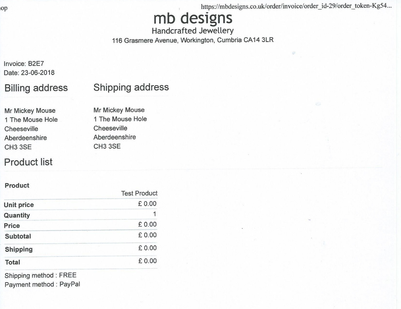

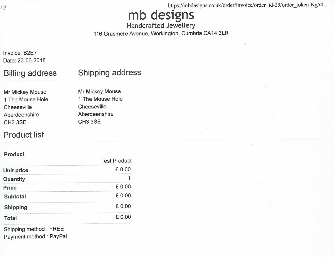

Print out not as screen or preview.
Have a problem with customer print invoice after completing order not printing correctly. Was working correctly 8/5/18 but not working correctly 15/6/18. Change would seem to correspond to when I tried hikashop version 3.4.0 and found the customer print invoice was not working so went back to version 3.3.0 See www.hikashop.com/forum/checkout/893949-view-order-.html

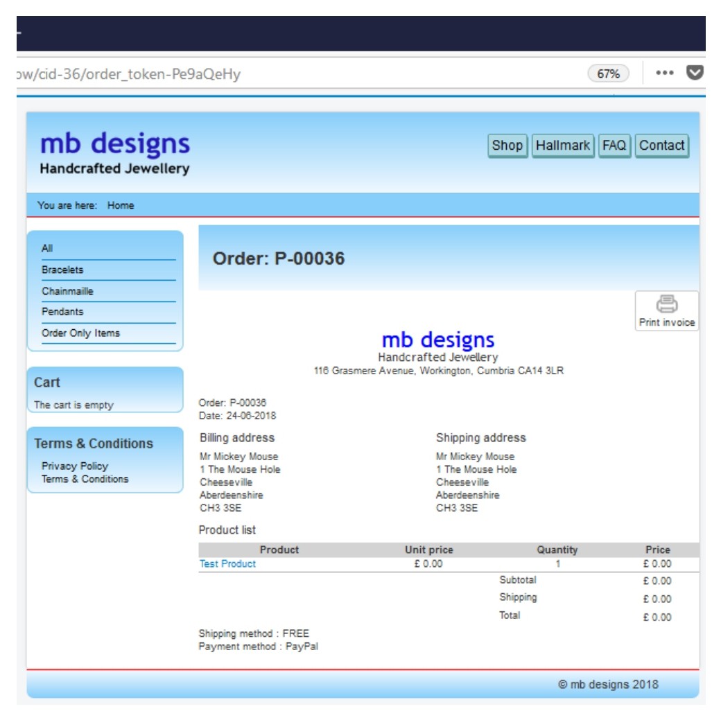

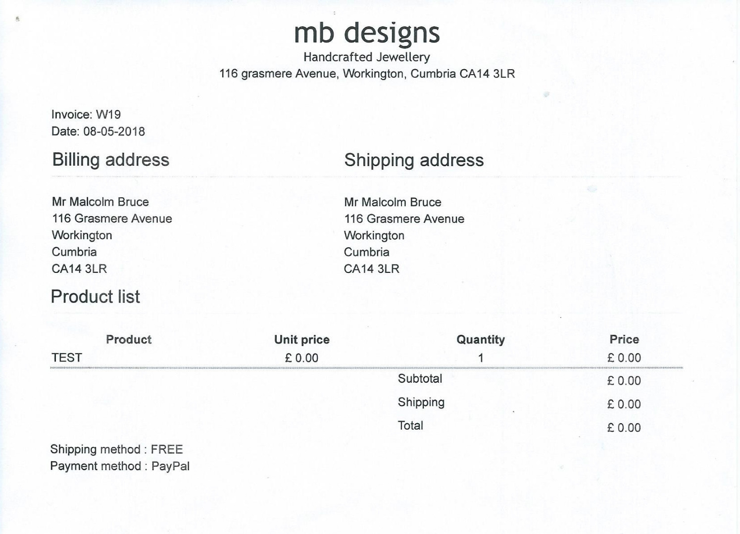

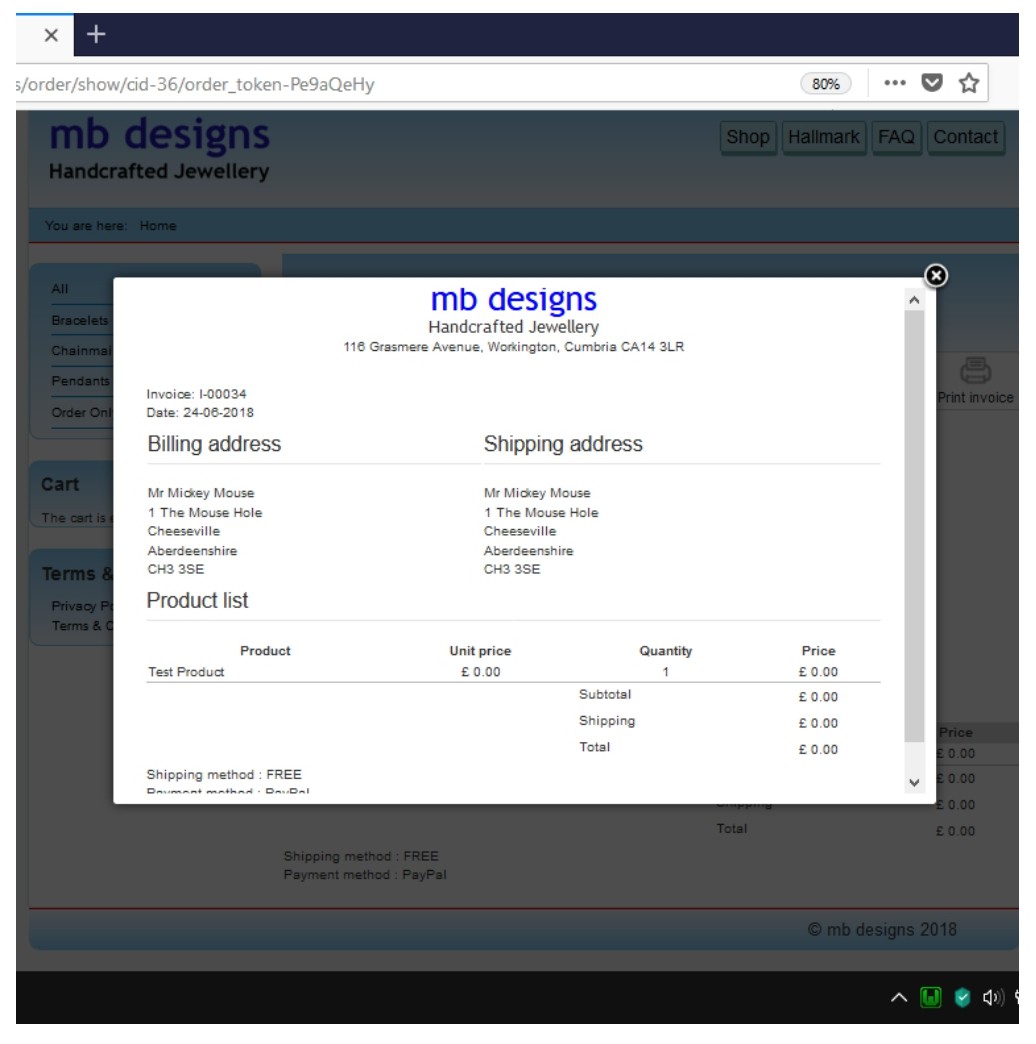

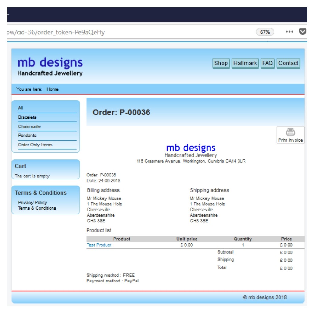

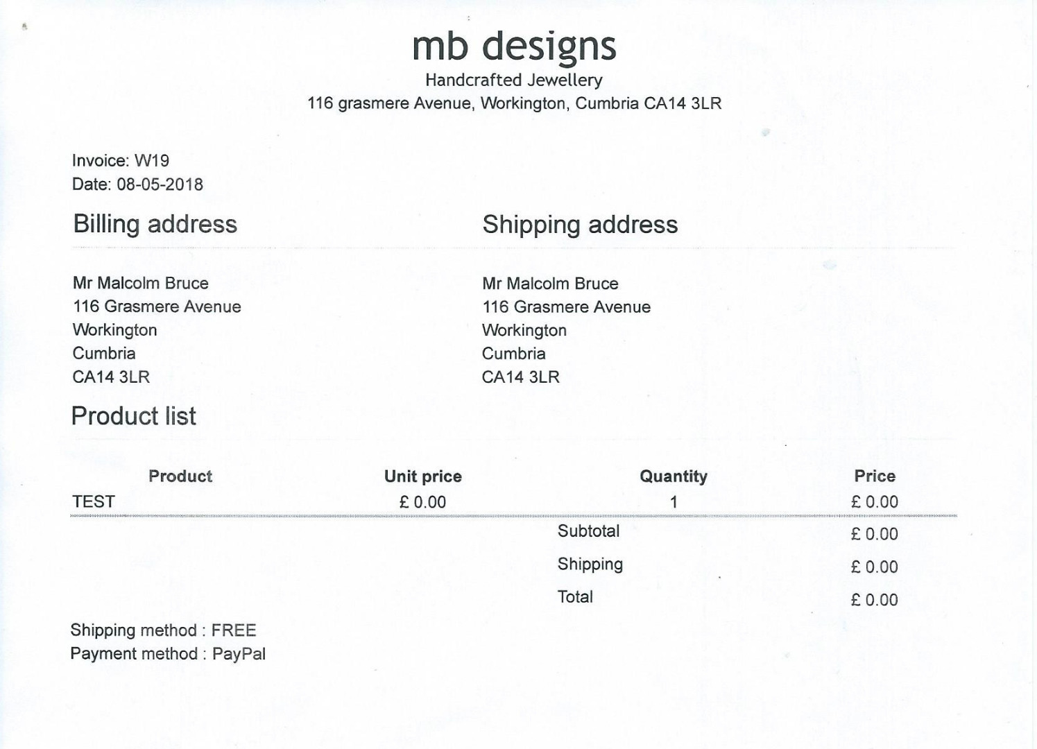

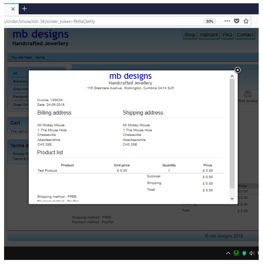

see attached files: 1. - screen view is correct, 2. - print preview is correct except for table title background colour. 3. - print out 8/5/18 correct except for table title background colour.
4. - print out 15/6/18 not as preview or as original.

Setting configuration – advanced > view files > to front end. I can see that the invoice layout is from file order/show.php. This file controls the screen layout but has no effect on the print preview (note the missing light Gray background to the table titles.
What I want to know is - what files are used to print out the invoice and what changes are required to print correctly.
