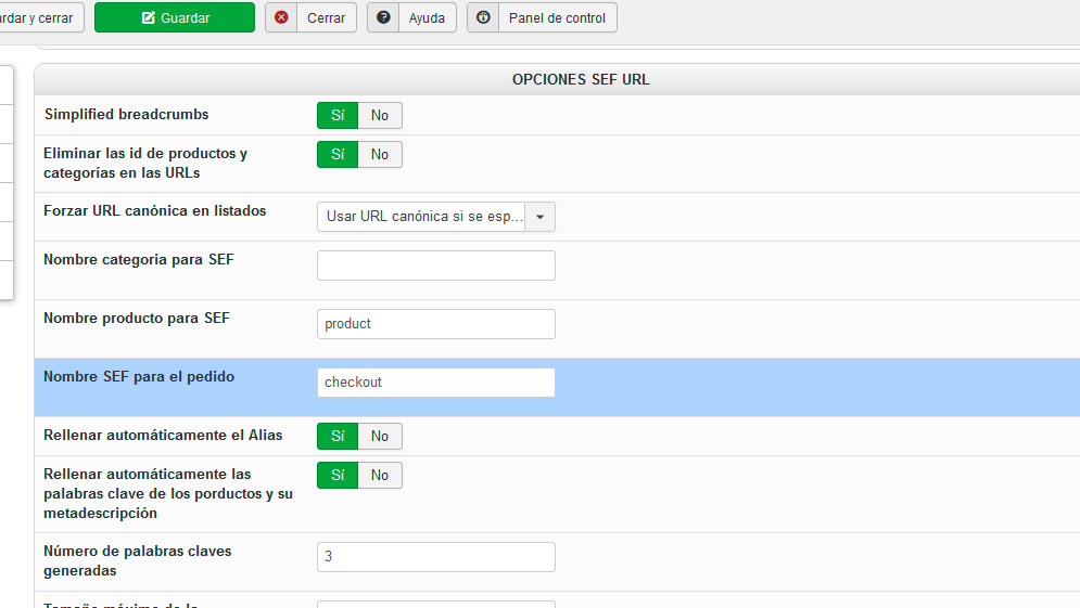

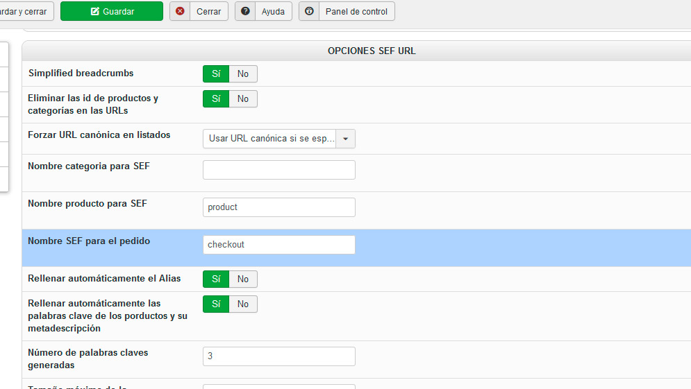

the configuration of "product SEF name" is correct
This changed after the update

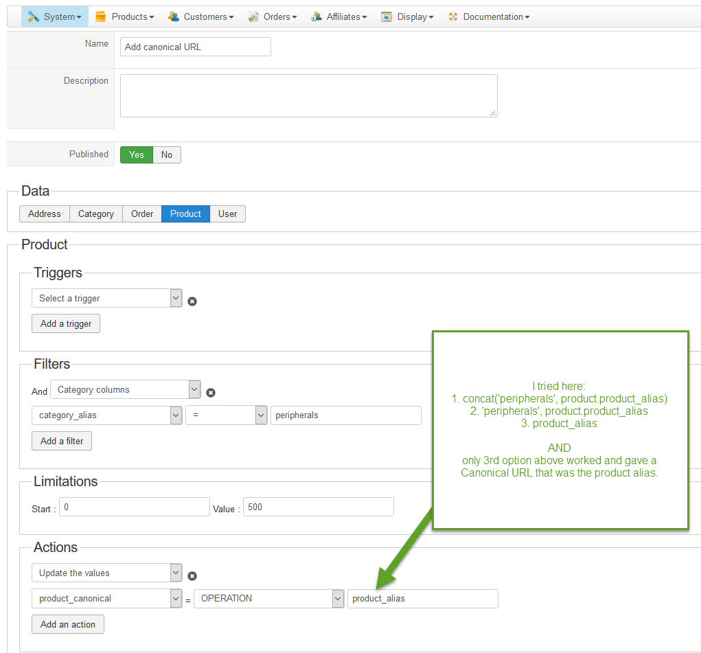

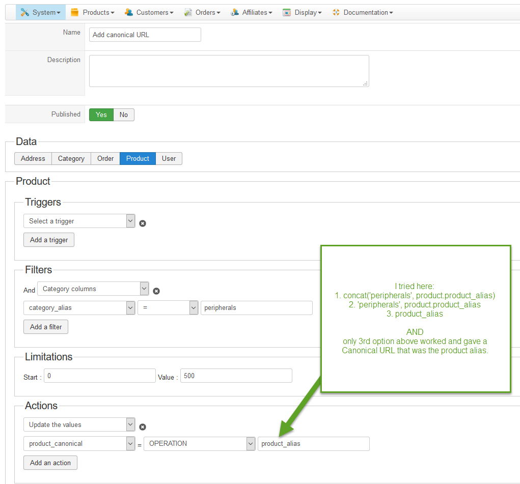

8 years 2 months ago #295380
I tried your proposition that will give me the solution that I was looking for, but I can not make the mass action to give the result I want.
Please see the attached image.
Any help?
To remind you, I want to have a canonical URL that will be: "category-alias/product-alias"
Thank you
Last edit: 8 years 2 months ago by ButterflyPixel.
  • Posts: 86179
  • Thank you received: 14217
8 years 2 months ago #295401
I forgot the / it should be like that:
concat('XXX/', product.product_alias)

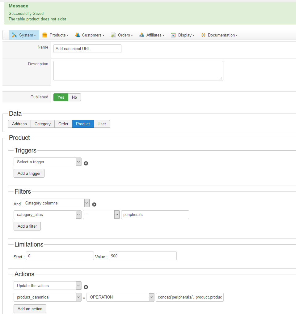

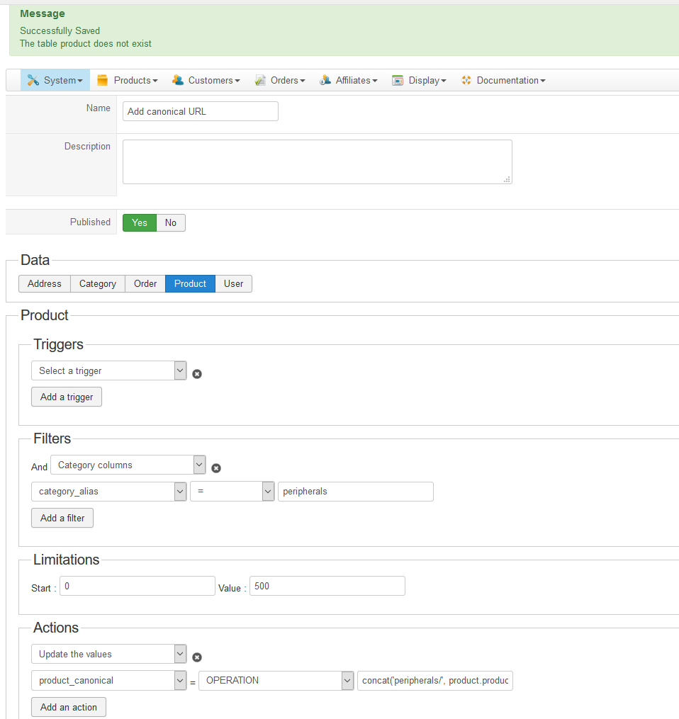

8 years 2 months ago #295409
I did that but I have this message;
"Message
Successfully Saved
The table product does not exist"
See attached my settings
  • Posts: 143
  • Thank you received: 9
8 years 2 months ago #295410
Well, I delete the space before "product" and worked!!!
concat('XXX/',product.product_alias)
Just let you know, make sense?
