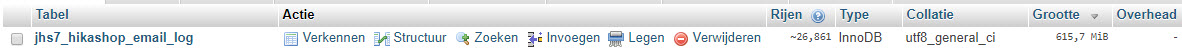

After a couple of years the email log file is huge (see attachment).
How can we clear this table?

Using the "Number of days" option of the "Hikashop Email History Plugin" will probably do the job.
Also, don't forget to back up your email logs before triggering your cron.

Great. Thanks. It's working!
