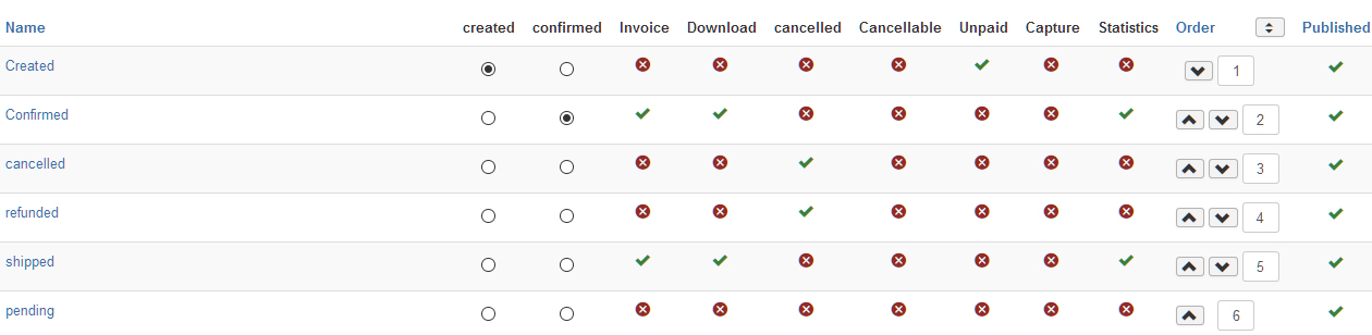

- if you have the option "Update the product stock on confirmed status" activated in the HikaShop configuration, the stock will only be updated after the order status is changed from "created" to "confirmed", after the order is paid. But if the order status is not changed because you have a problem with your payment gateway notifications of payment, then it won't happen.
- if that option is turned off, then the stock will be updated when the order is created.
- you want to check the settings of your order statuses in the menu System>Order statuses. If you don't use the standard statuses but custom statuses you created yourself, they need to be properly configured and it can get tricky.

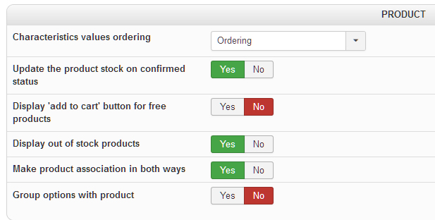

I tested what you suggested but something is not working for me.
I have "Update the product stock on confirmed status = YES". The stock was NOT updated because the status did not change to confirmed but the orders were paid for. The orders that are paid for are still showing the status as "Created".
Please kindly tell me how to get it to work this way and what I need to change, etc...
I would like the stock to be updated ONLY after payment is made, because customers don't always pay. Otherwise I will have to update the stock manually each time they don't pay.
I don't have any custom statuses.
Please see attached settings.
Thank you.

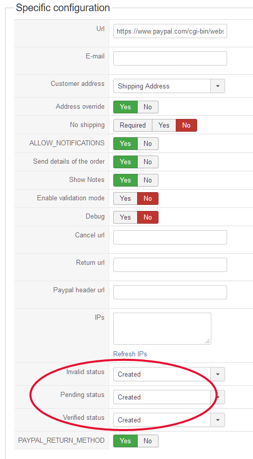

Attached are the configuration of Paypal.
Do I need to change any of the items circled on the attached to make it work? Does my settings look ok?
I just want to make sure before I contact Paypal.
Thanks!
7 years 11 months ago #298222
You might want to use the default settings for these.
So an order will become "cancel" when an invalid notification comes.
So an order will become "pending" when a pending notification comes.
So an order will become "confirmed" when a verified notification comes.
