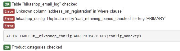

-- Joomla version -- : 3.8.12
Hello, I'm having a few issues when I carry out a database check - see attached image
I realise that part of the issue might be that I copied data from an older version of Hikashop (3.2.0) to a newer version (3.4.0) and in hindsight I should of made sure they were on the same version! I didn't want to mess around installing the latest version just yet in case it makes things worse.
Is there any way of fixing the errors I have?
Note that everything seems to be working OK - I can checkout etc...
Thanks in advance.

7 years 11 months ago #298396
Hello Mohamed, that was a screenshot of the Hikashop database check, so in my case it hasn't fixed the issue.
  • Posts: 86081
  • Thank you received: 14190
7 years 11 months ago #298398
There is apparently a problem with your hikashop_config table where HikaShop stores the settings of your HikaShop configuration.
The simplest you can do is to rename that table via your phpmyadmin in order to deactivate it and install the HikaShop install package just after that. That way, it will reinstall that table and add back the default values to it. You'll have to reconfigure the HikaShop configuration but you should then be good to go.

7 years 10 months ago #298626
OK, thanks for the download link, that fixed the errors.
It took a while to get all the config details back to as they were though. Thanks for your help.
