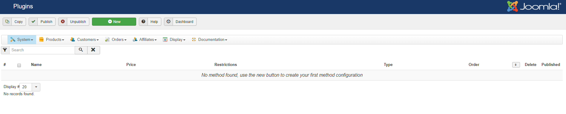

7 years 10 months ago #298585
I just tried to test it in your website using the access you previously gave us but I wasn't able to check your shipping methods and your product didn't have any weight / dimensions set.
That error will only mean that :
- All the shipping methods your created can't be used with that product / shipping address
- A shipping method could have been used if the total weight of your cart was higher that its "minimum weight" option.
Kind regards,
Mohamed Thelji.

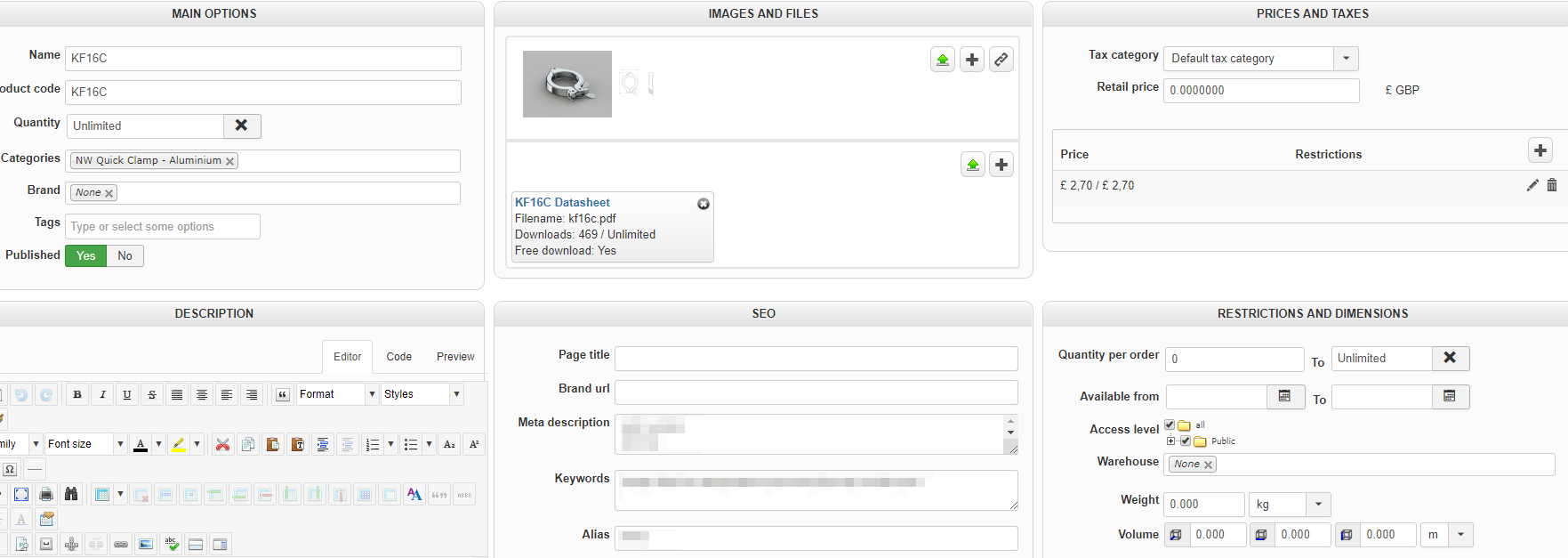

  • Posts: 94

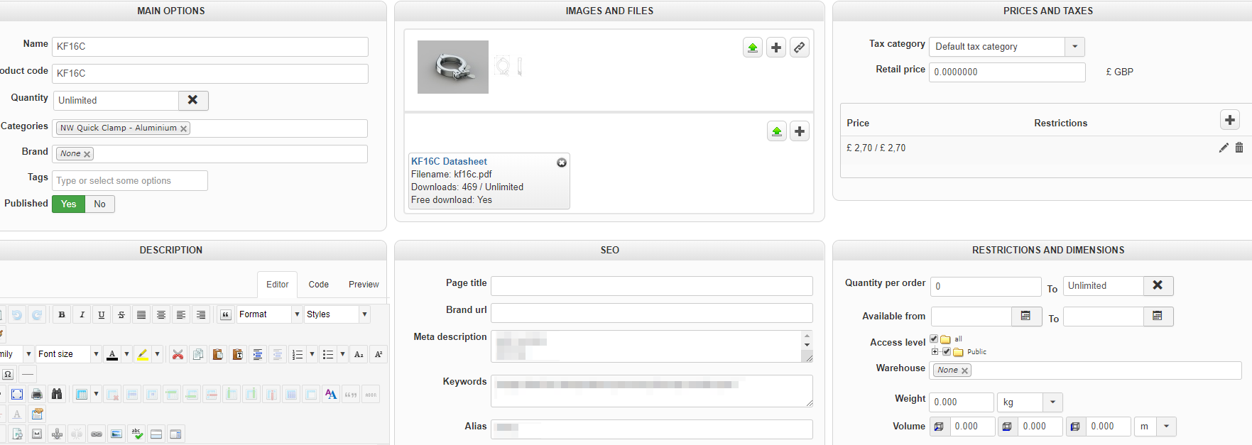

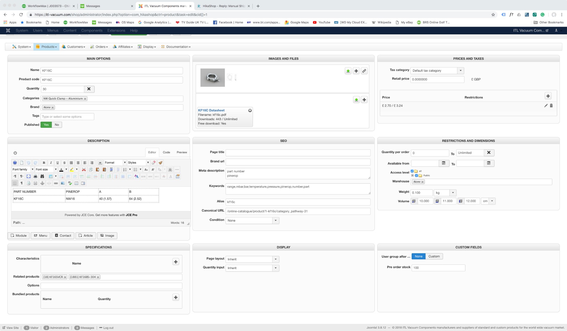

7 years 10 months ago #298708
But the item does have a weight??

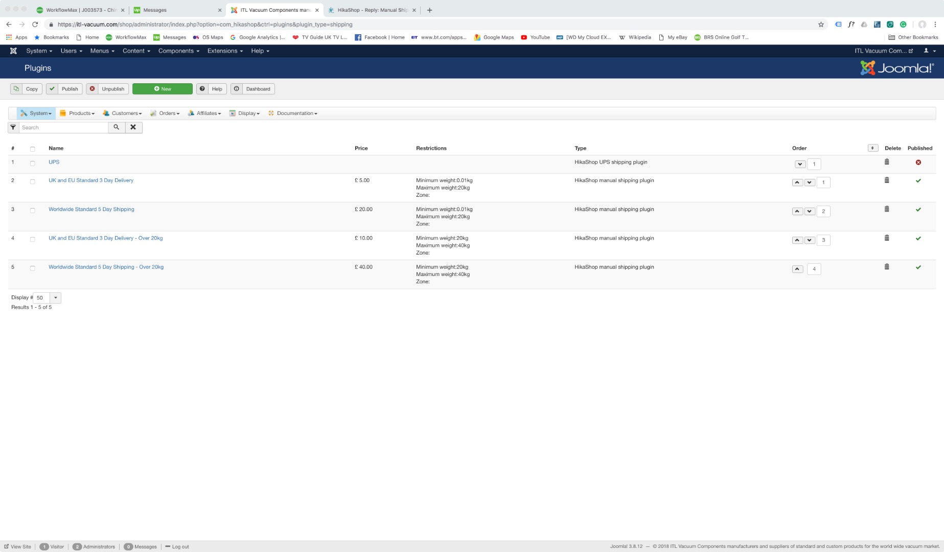

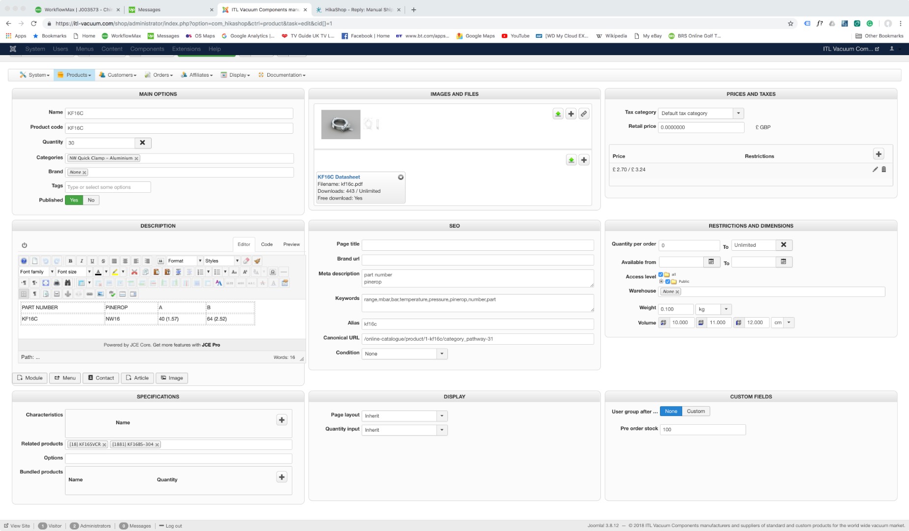

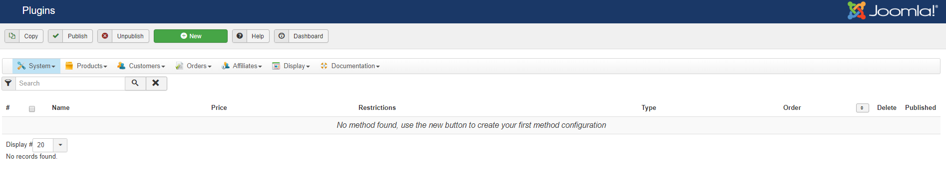

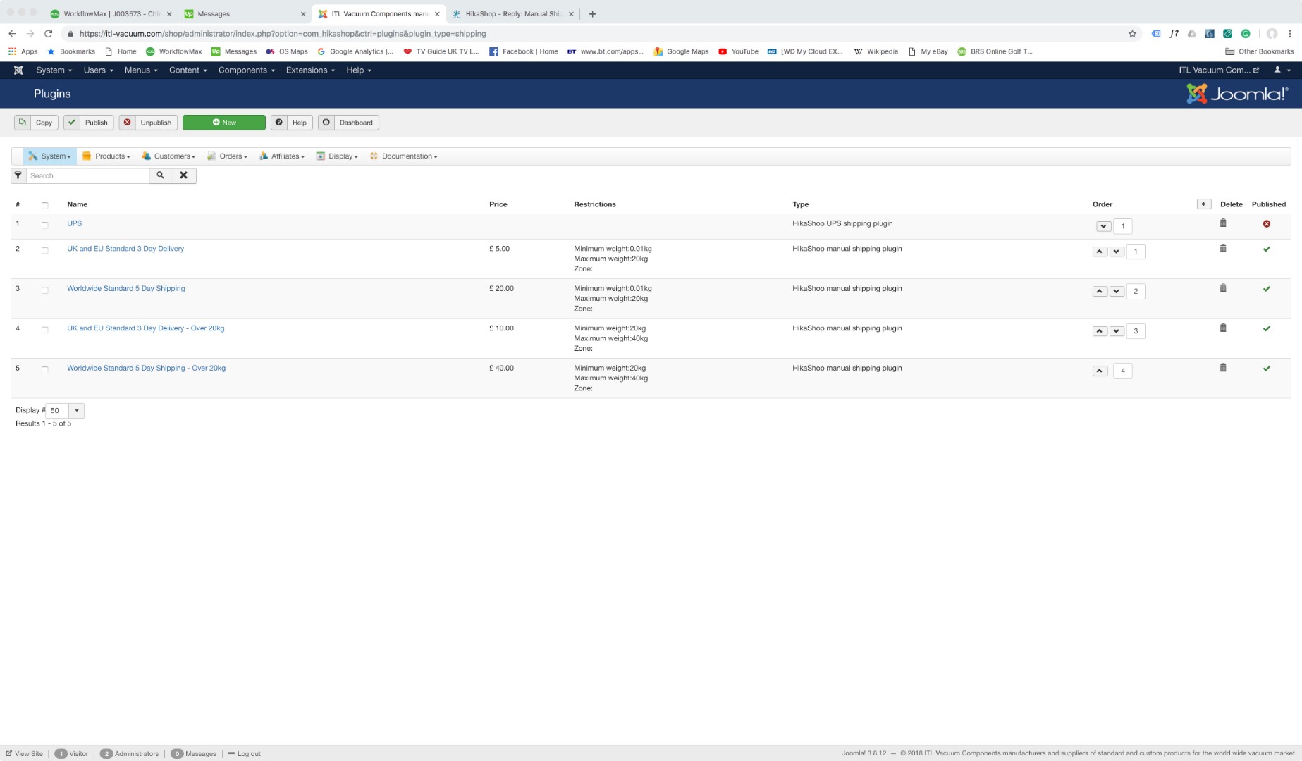

7 years 10 months ago #298713
I checked again if you had shipping methods or if you have set a weight on your product and here are screenshots of what I have.
Kind regards,
Mohamed Thelji.

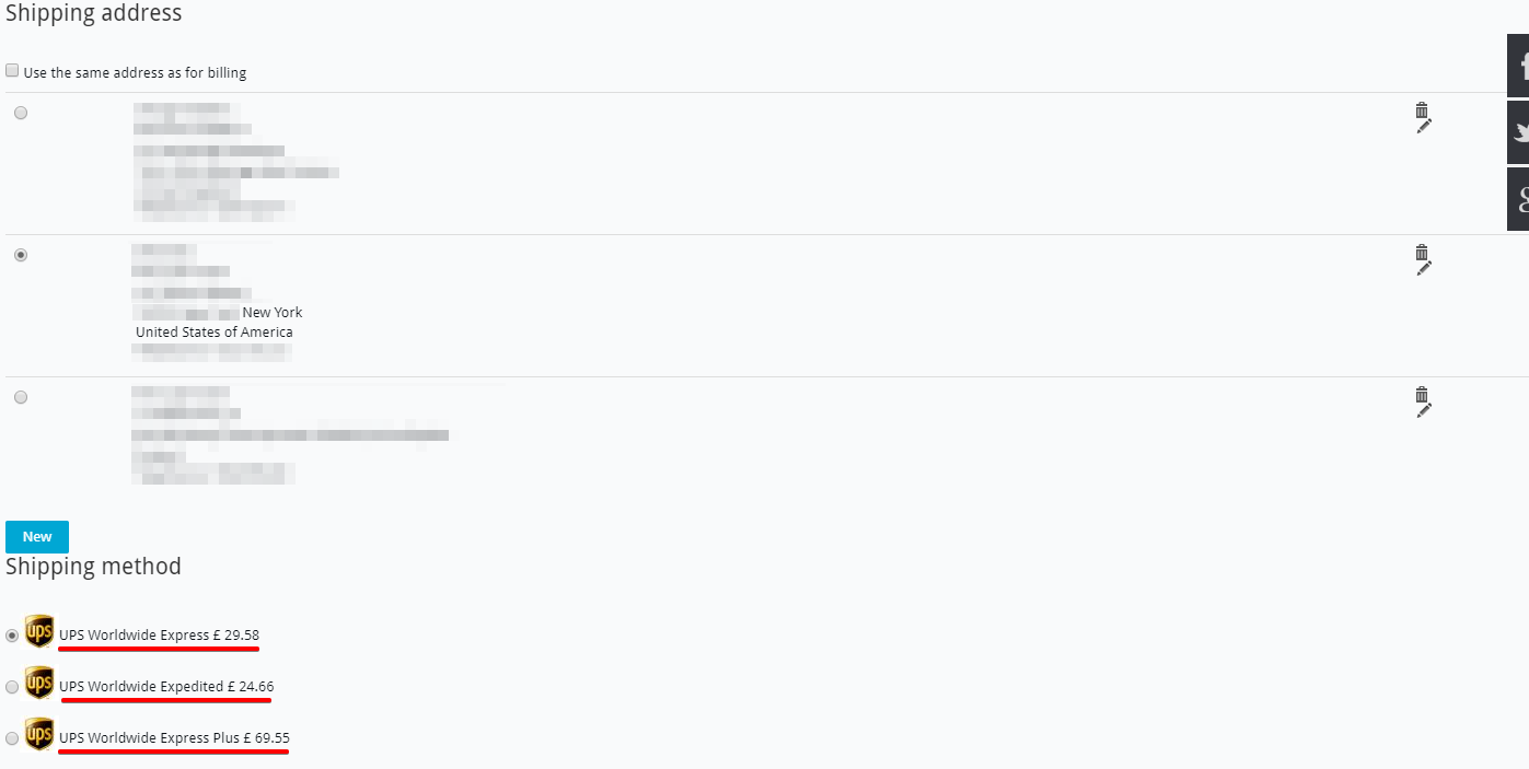

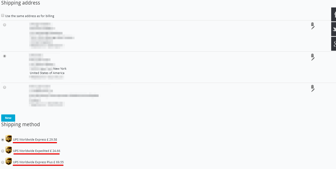

7 years 10 months ago #298777
I just tested it with the correct URL, and I wasn't able to have the "weight is too small" error message with an US shipping address (cf. screenshot).
Did you fix your issue ?

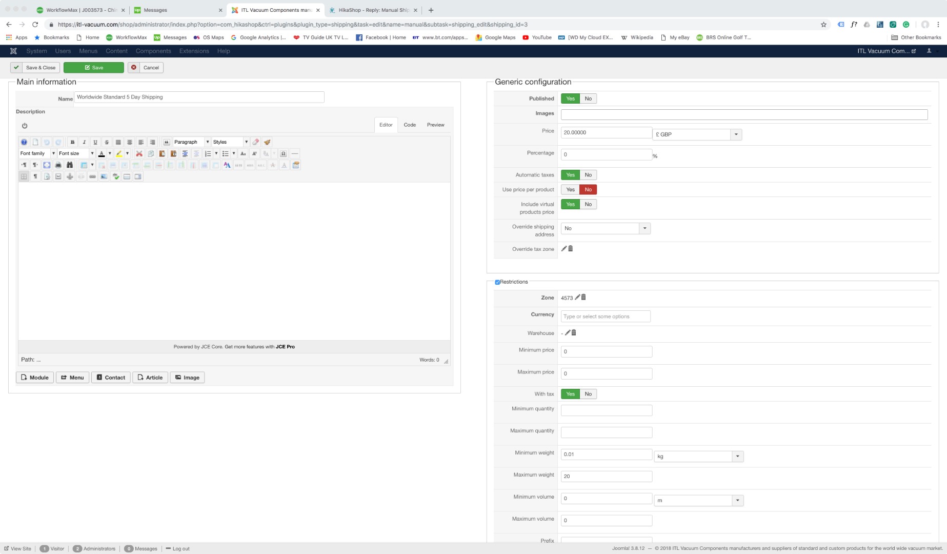

As mentioned earlier in the thread - the error happens with manual shipping options (which I have turned off because of this problem) the UPS shipping method works. BUT one issue we have with the UPS option is when logged in as a UK user the delivery in the cart module (position left) defaults to worldwide shipping which makes the cost look very high and may deter customers. When you checkout however it corrects itself - any ideas on this?

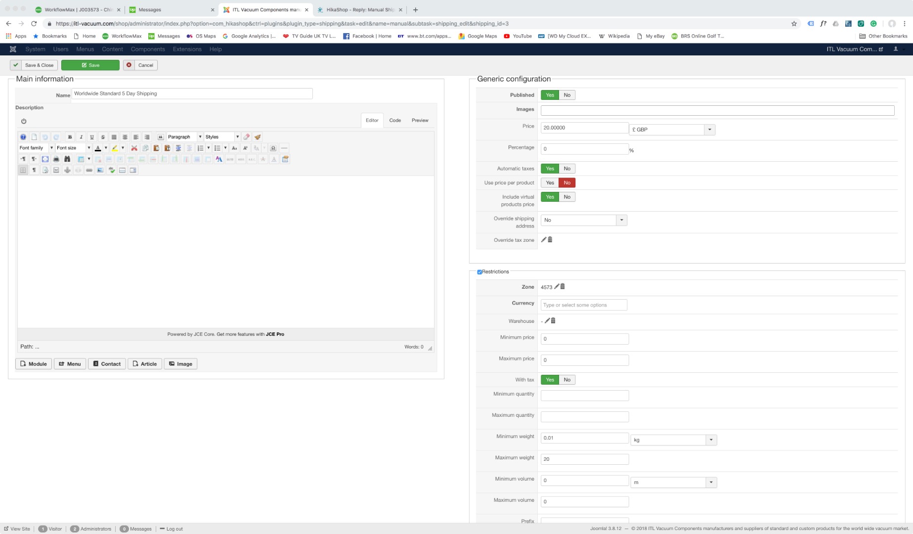

7 years 10 months ago #298823
The issue you're having with your manual shipping methods is coming from how you have configured the "Zone" option of the "Worldwide Standard 5 Day Shipping" method which seems to be the "EU/UK" zone.
Regarding the shipping prices displayed through the cart module, these are approximations, a solution can be to change the ordering of your shipping methods via "Hikashop->System->Shipping methods" and have the UPS shipping method be last.
