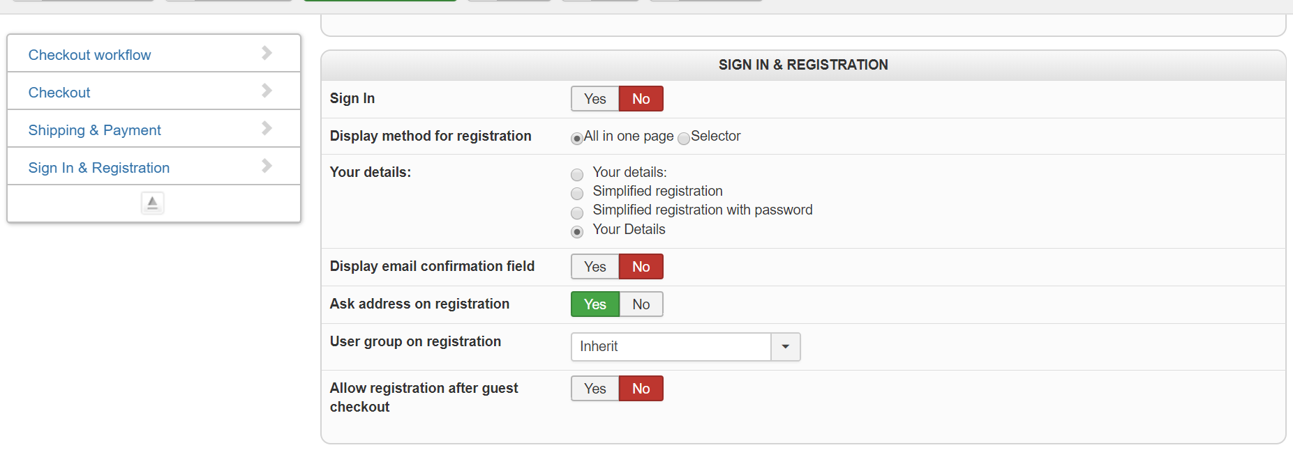

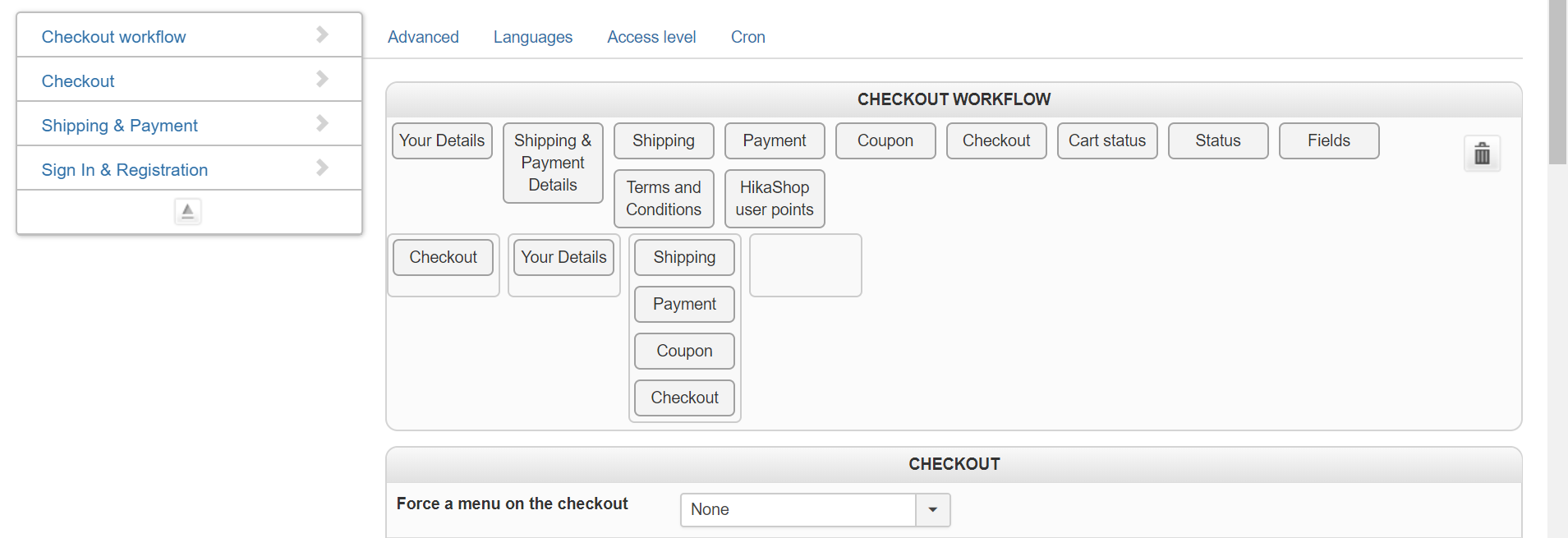

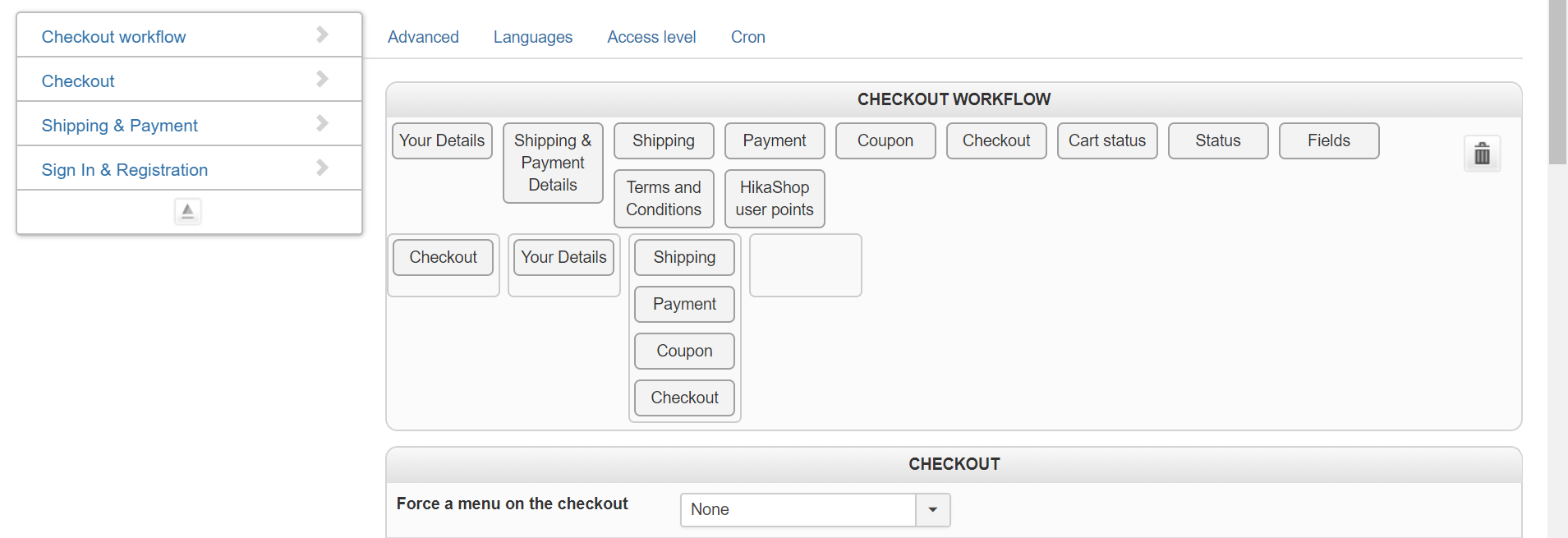

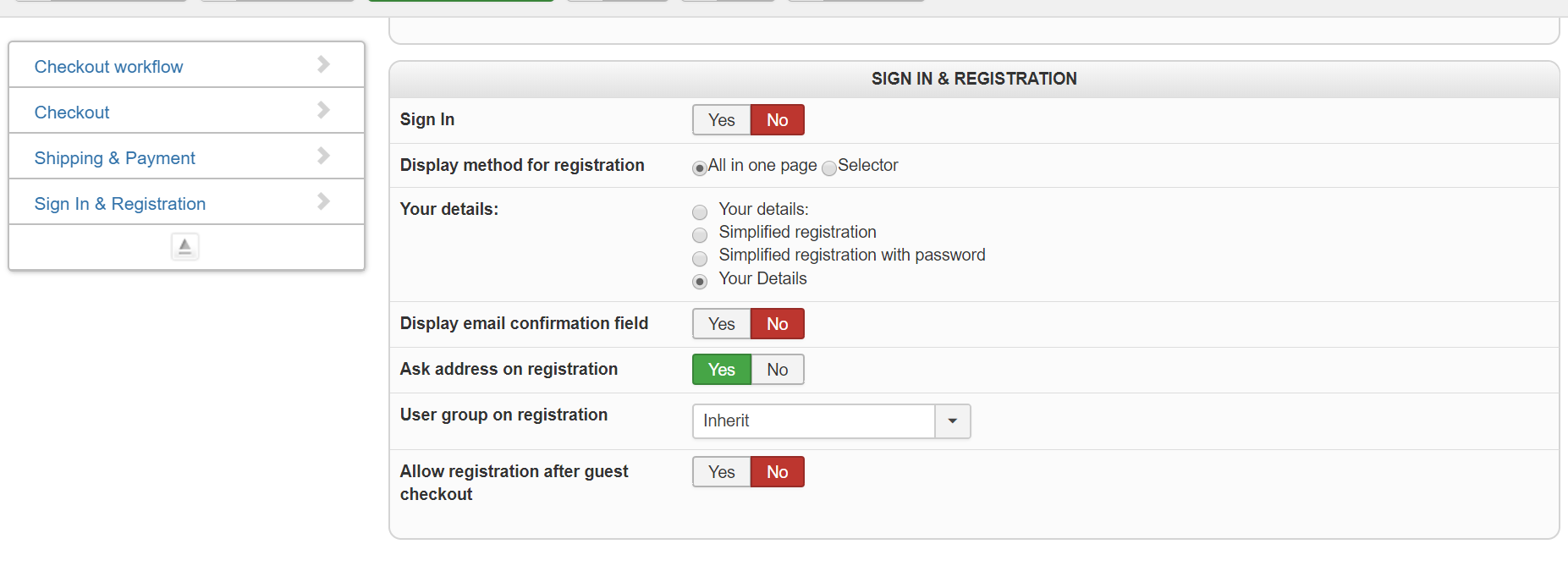

For the first issue, I was able to see it, now in order to better understand situation can you provide some screenshot of your Checkout Workflow settings page and more especially these parts :
Awaiting news from you.
  • Posts: 5
7 years 10 months ago #298886
Thanks for your help Philp,
I've attached my screenshots although I think I'm on an older version of hikashop compaired to yours
Cheers,
Nicole

I would recommend to turn off the "checkout legacy" setting under the advanced tab of the HikaShop configuration if that's not already done.
I think that it should help with that issue leading you back to the first step.
Updating to the latest version would also be great. There are a lot of ameliorations and bug fixes to the checkout since you're version so it might also help.
