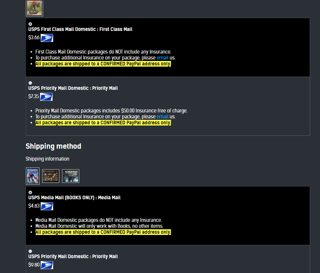

6 years 11 months ago #308597
Mohamed,
Sorry for the VERY late reply in getting this going. I've had a lot of unfortunate circumstances of late in the family.
So, I've got this working...but, there's a small issue I hope can be resolved ASAP.
When putting books in to the "book warehouse"...Media Mail is delectable. Problem is, if I add something that is NOT in the "book warehouse"...I then get 2 separated shipping methods as shown in the attached image.
I understand why it would separate out because of the "book warehouse" and the non warehouse one...but, BOTH could be shipped via Priority Mail together.
How can I get it do combine the items using Priority Mail? If a customer were to choose priority mail in this setup, they would be charged a total of $17.15 rather than a single charge of $9.80 (which is what the items combined should be.
Thank you!
6 years 11 months ago #308699
No problem, our support is always open. I hope everything is going fine for you !
The problem is that product which are part of different warehouses can't be shipped together.
If using warehouses doesn't suit your needs, another solution can eventually be to prevent the "media mail" shipping method when a product which isn't a book is on your cart.
You'll be able to do it by :
- Setting the "Use price per product" option of your "medial mail" shipping method to YES
- Going to none book products configuration page
- Use options of the "Shipping prices" tab of your products configuration pages
- Check the "Blocked" check box for the "media mail" shipping method.
If it still doesn't suit your need, you'll probably have to directly edit the code of the UPS shipping plugin.
Kind regards,
Mohamed Thelji.
