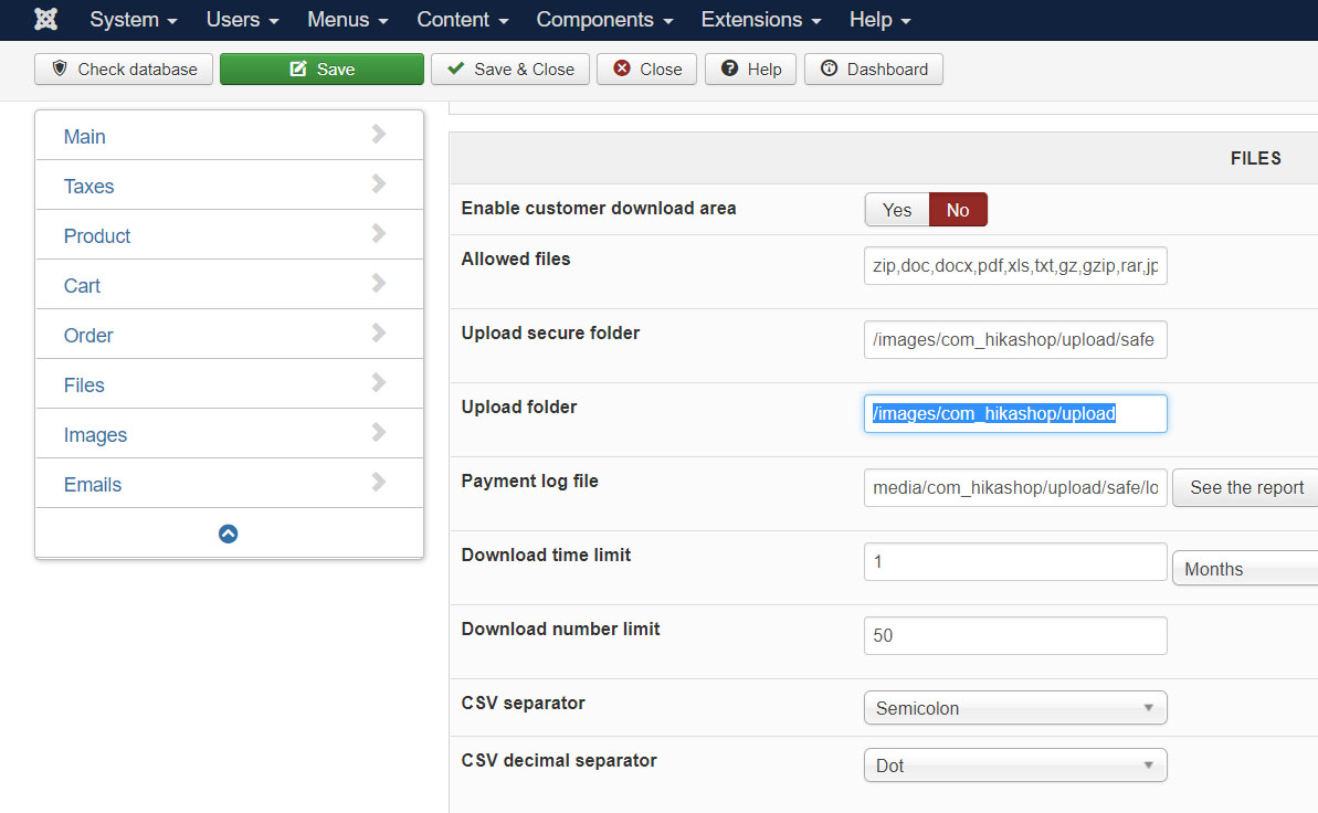

I've noticed that Hikashop have changed the image directory to allow better access for Google to discover.
Is there an easy way to update product images?

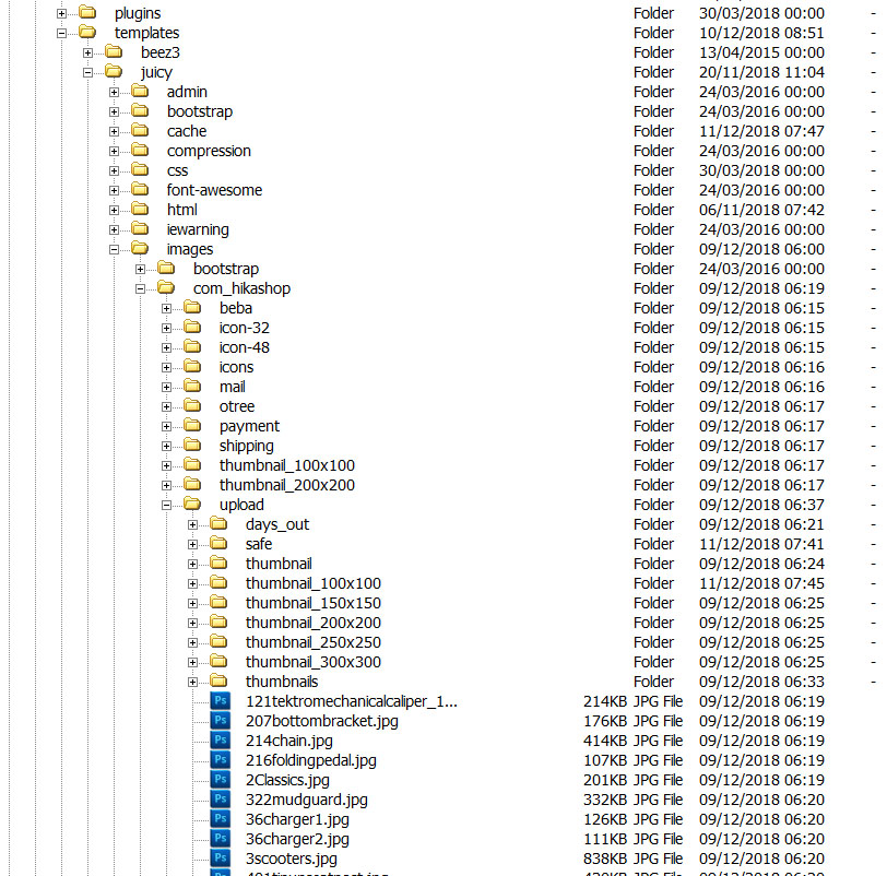

I have copied the existing images (hundreds) from media/com_hikashop/upload to templates/template/images/com_hikashop/upload
When I change the directory in configuration settings the product images path are not updated.
It would be nice not to edit every product! And the SEO of having images indexed by Google would be very useful.
Hope you can help.
KR, Bob

7 years 8 months ago #301471
Thank you Nicolas - I did try that, moving first by FTP.
Perhaps I did something daft. I will try again.
So, you say the directory part is not saved with the image file name, but is saved in the configuration.

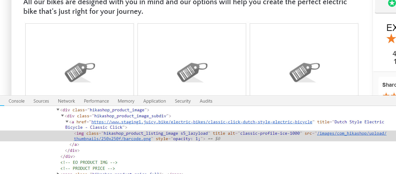

7 years 8 months ago #301500
Weird - I confirm the images are now at the location in Configuration setting...
But when I inspect I just see the default image...
Confused!

7 years 8 months ago #301502
1. Yes. Only the relative path is stored.
If your product image is stored in images/com_hikashop/upload/myfolder/myimage.jpg and supposing you have images/com_hikashop/upload in the HikaShop configuration, you'll have only myfolder/myimage.jpg in the database. That way, you can easily move the whole folder structure to the new place after or before you change the setting.
2. You stored the images in the folder templates/juicy/images/com_hikashop/upload/ but you entered the path images/com_hikashop/upload/ instead in the configuration. That's why HikaShop can't find the images. Enter the correct path and it will work.
