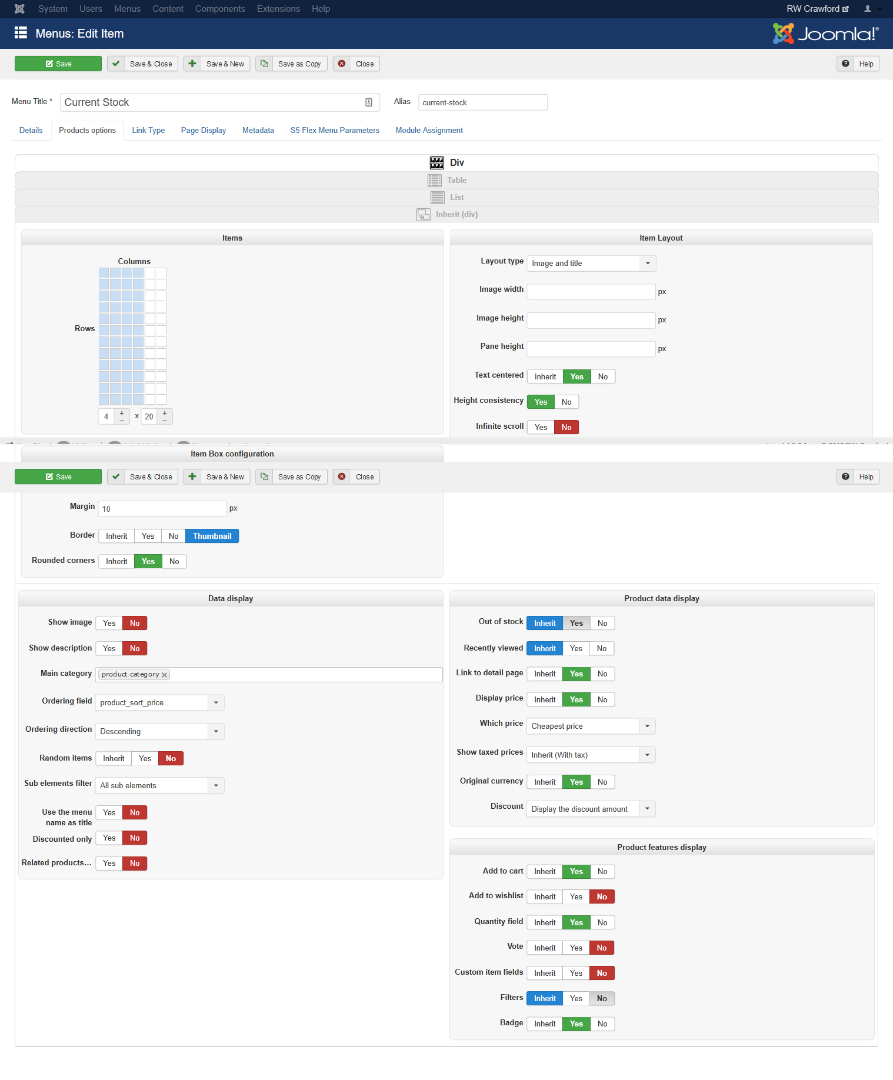

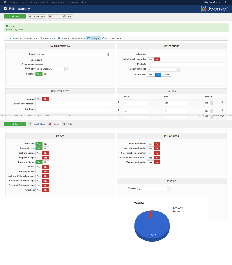

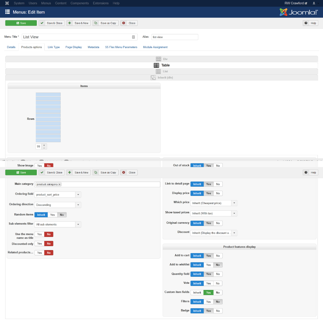

I have attached menu settings and custom field settings.

7 years 8 months ago #301634
Your custom field has two values :
1 - Yes
2 - No
As the graphic show, you do not have any product with the "2 - No", but you have some with the value "0" which is not an existing value for your field.
That's why, you have that "0" display in the product listing (first link) : pasteboard.co/HRGV0jU.png
And that's also why you have a blank display in the table listing ; since the table listing do not display the raw value like the div listing.
But if you configure your custom field and products with existing values ; the display will be fine.
