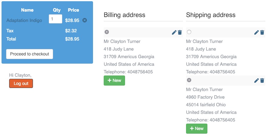

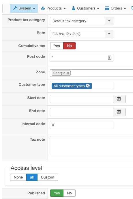

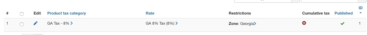

After a migration from Virtuemart to Hika, we're having an TAX issue.
We've setup the tax rate at "GA 8% Tax" (see attached "A")
We've assigned it to zone "Georgia" (see attached "B")
But, it's still charging tax on ALL shipping addresses??? (see attached "C")
Thanks in advance for the great help.
