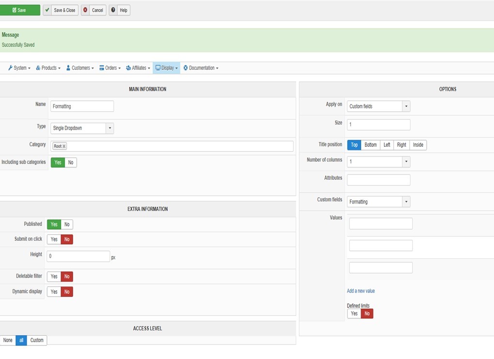

- Filer settings screenshot

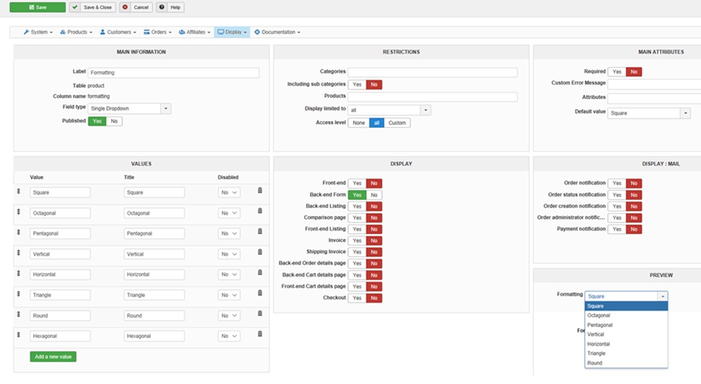

- Custom fields screenshot
- Describe in details your needs and your value
the point is for us to understand the context and what you want achieved as filter results.

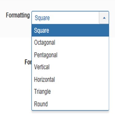

Please find below an example of the custom field set as dropdown field and filter based on this custom field also set as dropdown type.
Finally filter on the front page (in filter module) will looks like below – so order of values is as entered to the custom field settings but because I plan to have a lot of different filters with many values I prefer to have possibility to sort these vaules in the filter in alphabetical order
