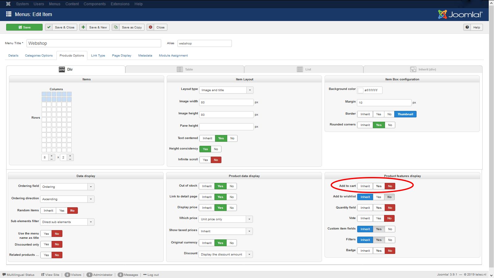

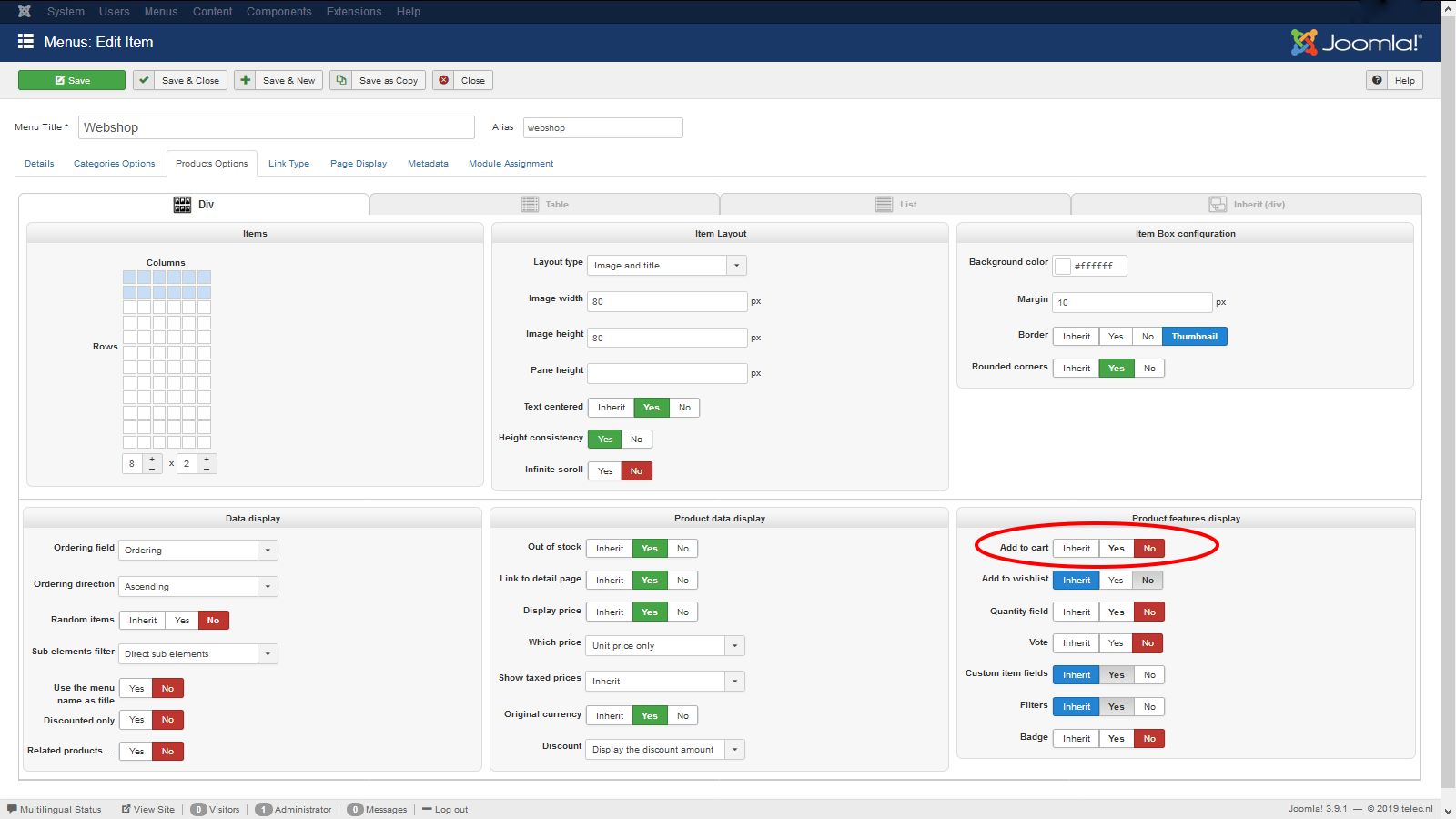

The choose options button is actually an add to cart button with altered text, so depending on your configuration it will either update the cart or add it to the cart and open the checkout form.
If you set the add to cart to no in product features display, the button will be gone and you need to create a new one that will link to the product page.

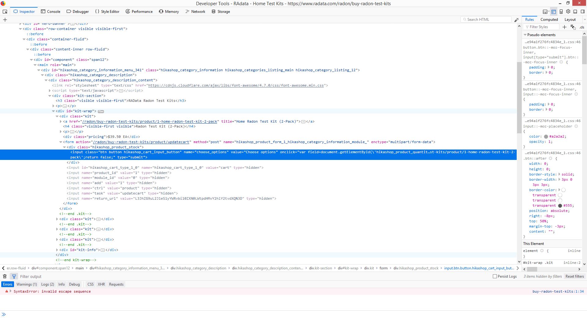

Please take a look at the highlighted text in the image, this represent your "Choose options" button, it's a cart input button. The normal text would be Buy now. If you click the image you go to your product page and can select the Testing Location Address.

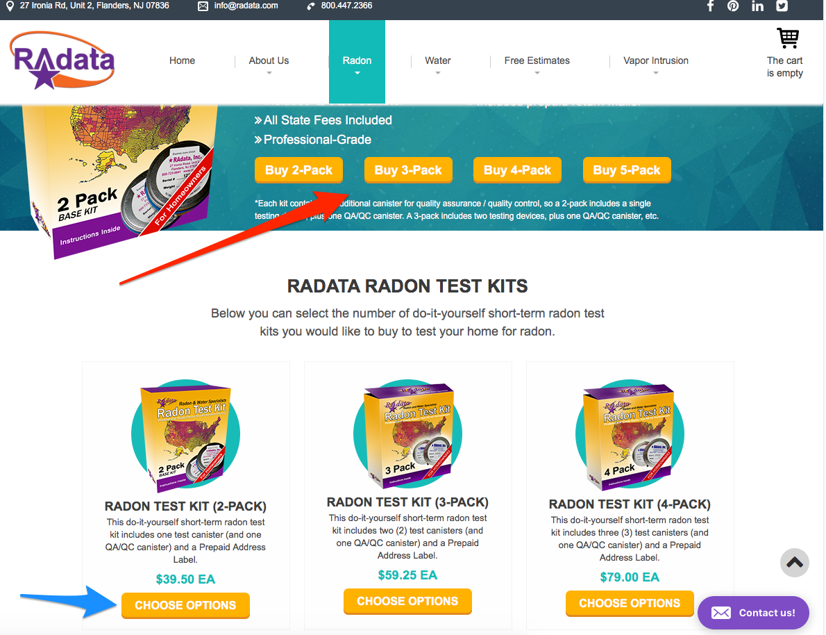

7 years 7 months ago #302788
You're not following me as to what's wrong. Attached is a screen shot from the page. When any of the buttons that say Buy 2-Pack, Buy 3-Pack, Buy 4-Pack, Buy 5-Pack those take you to the appropriate page depending on how many you want to buy.
www.radata.com/radon/buy-radon-test-kits...adon-test-kit-3-pack
All that is good and what's supposed to happen.
The issue is when you click on the Choose Options buttons (blue arrow) they take you to this page
www.radata.com/radon/buy-radon-test-kits/checkout
That's not where the Choose Options is supposed to link to. Its supposed to link to the same place the Buy (red arrow) go to depending on the quantity you want.
Do you see the difference in the two URL's and what's on the two pages?
I need to change the links for the Choose Options buttons (blue arrow) so they go to the same place as the Buy buttons (red arrow) go to.

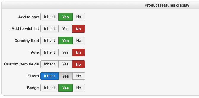

  • Posts: 64
7 years 7 months ago #302790
As you see mine is set to Yes. In your screen shot its set to No. Why?

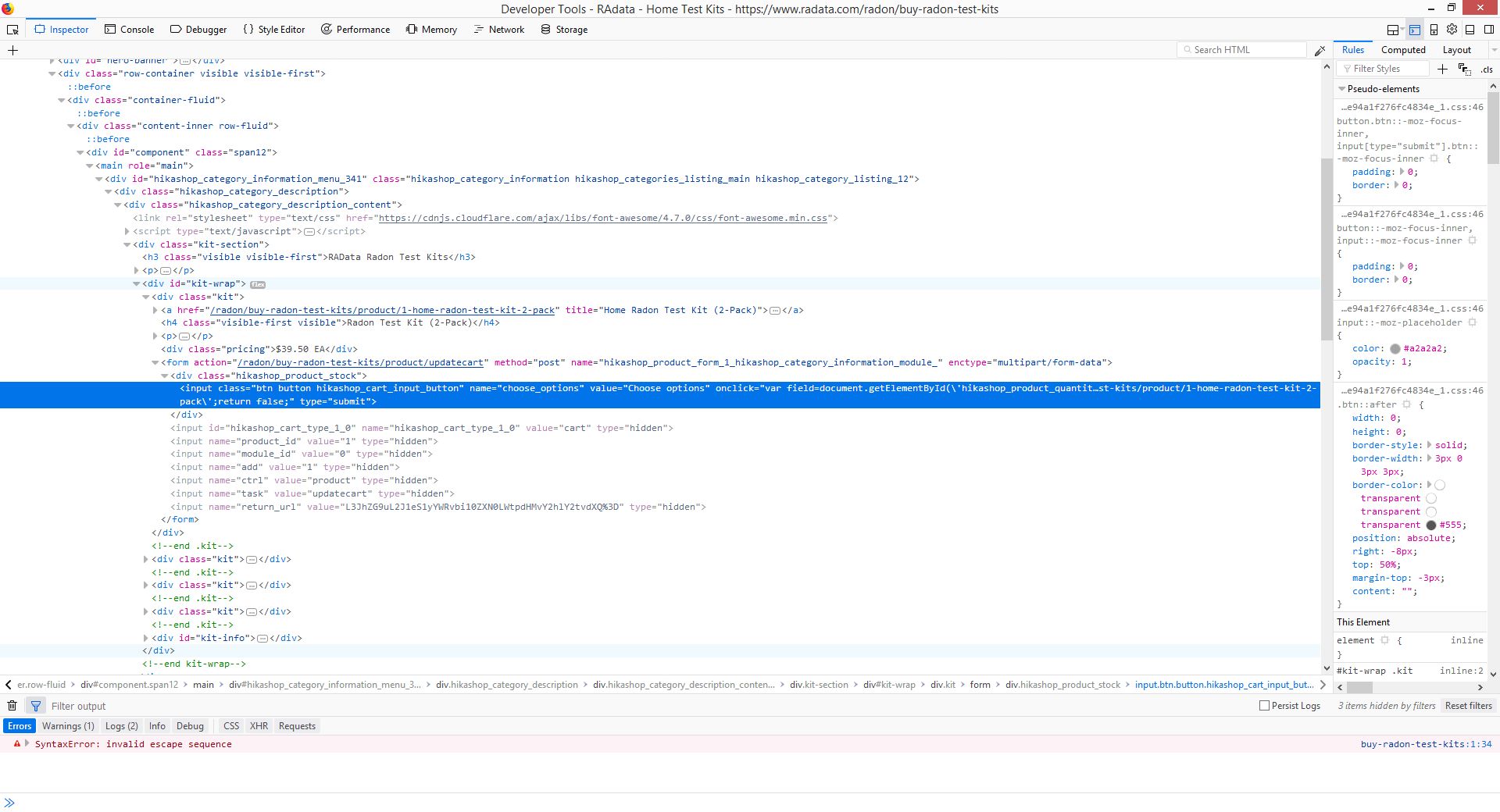

  • Posts: 86081
  • Thank you received: 14190
7 years 7 months ago #302806
The "choose option" doesn't work properly on your pages because there are extra \ characters in the onclick attribute of the button, as you can see on the screenshot you posted.
This happens either:
- because of a customization of a view override
- an old bug in the view displaying the button, that we fixed since
In any case, updating HikaShop and turning off the "add to cart legacy" setting as I said in my previous message will fix the problem.
  • Posts: 101
  • Thank you received: 8
7 years 7 months ago #302812
Yes I am talking about the "Blue arrow" part, it's an add to cart button, not a normal link as the "Red arrow" part. Just set the add to cart to No and see if the "Blue arrow" part button is gone and check if you can still order on the product page.
If that's all working create an link like the "Red arrow" part to go inplace of the "Blue arrow" part button.
Please note that this is an old version of Hikashop Business (2.6.0) as Nicolas states try to update.
Not sure if the turning off the "add to cart legacy" setting is present in your, older, version of Hikashop

Go to dev.radata.com/radon/buy-radon-test-kits This is the Dev / testing site. I've turned off the Add to Cart in the Menu per your screen shot. Clicking on any of the 4 Buy buttons takes you to a different page then clicking on the Choose Options buttons. So turning off the Add to Cart in the Menu doesn't fix anything.

Did you turn it off for the hikashop_category_information_menu_341 ?
If not the buttons will still be there, if yes then I do not know were you did create the add to cart buttons.
