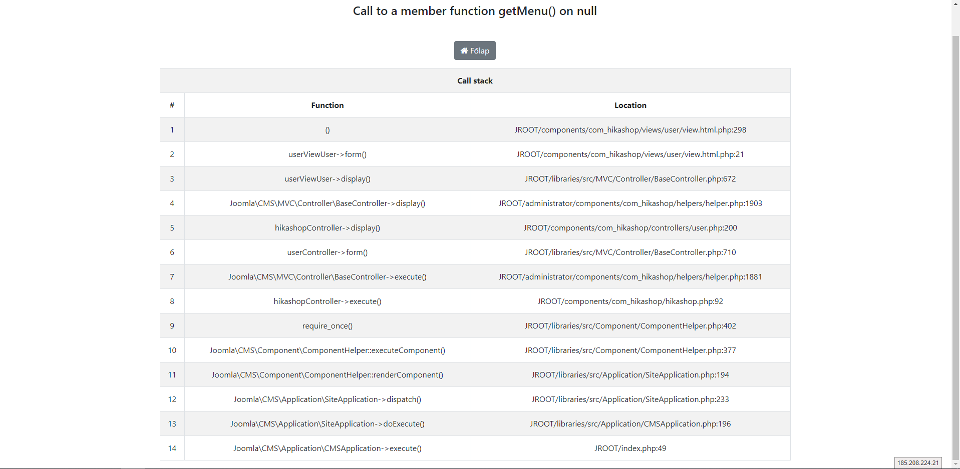

-- Error-message(debug-mod must be tuned on) -- : Call to a member function getMenu() on null
HI there!

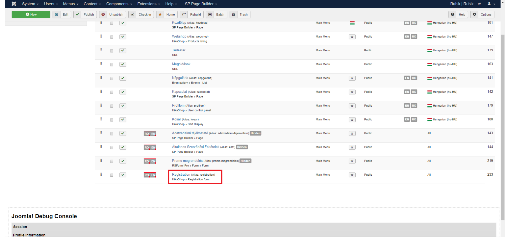

We got some serious problem with registration form: If we choose a Hikashop Registration form menu type, then the following problem occured.
It's also a problem when we do a clean install. None of the Registration form Menu item working at all.

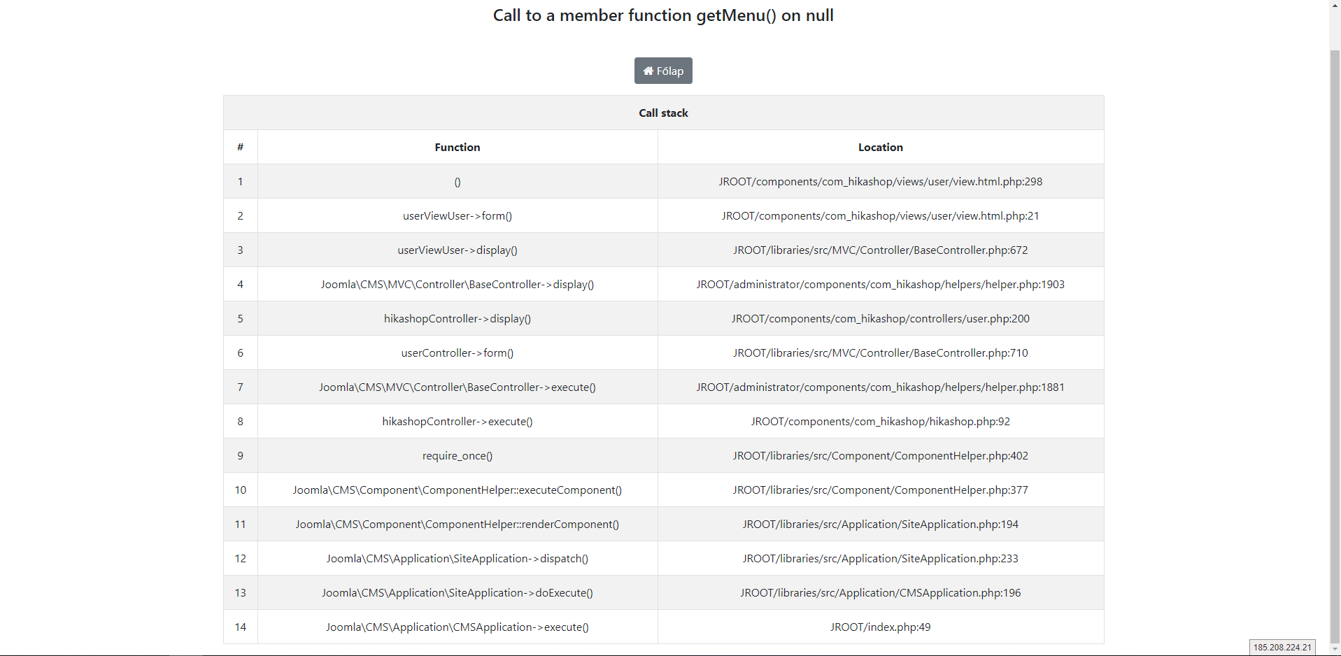

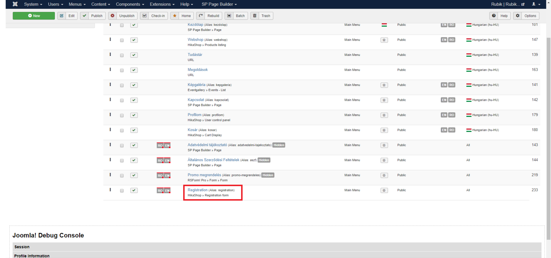

  • Posts: 41
7 years 7 months ago #302869
We activate the first time too, but i ptr sc for u. We try the update and clean install, but the problem is same.
