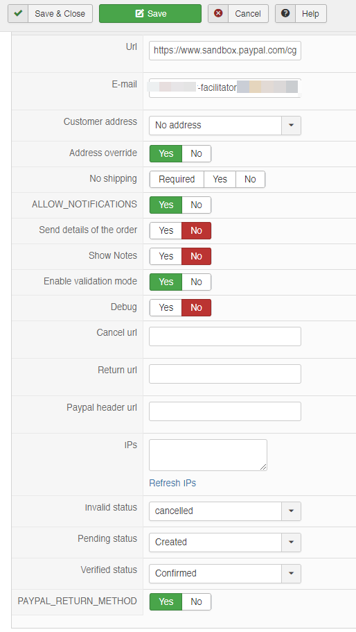

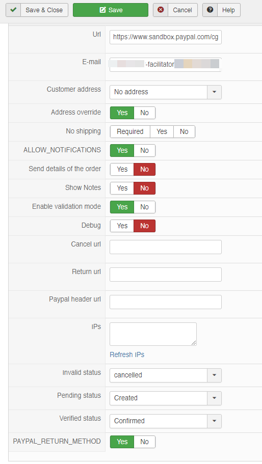

i'm testing the normal paypal plugin in the sandbox mode. i setup the box as you see in the screenshot.
now when i click on my checkout button in hikashop to proceed the cart and the next screen shows me that i get redirected, as a buyer, I immediately receive an order confirmation as email.
the thing is, the mail is send out to the buyer before he has made the purchase on paypal. this is not correct. the buyer should not receive an order confirmation until he has successfully completed the payment process at paypal.
what can i do to solve this?

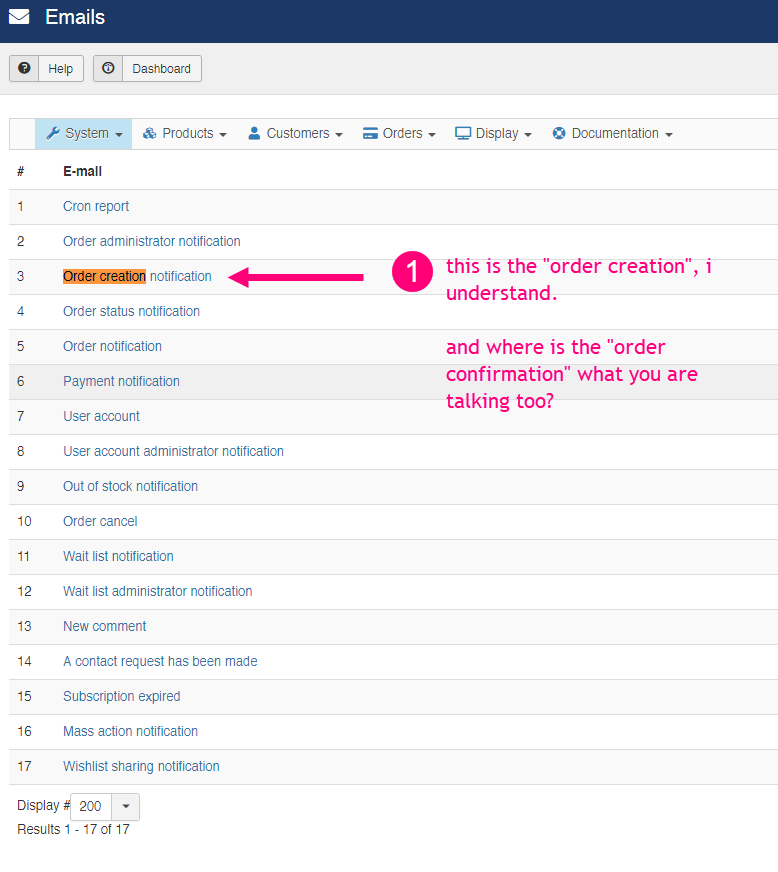

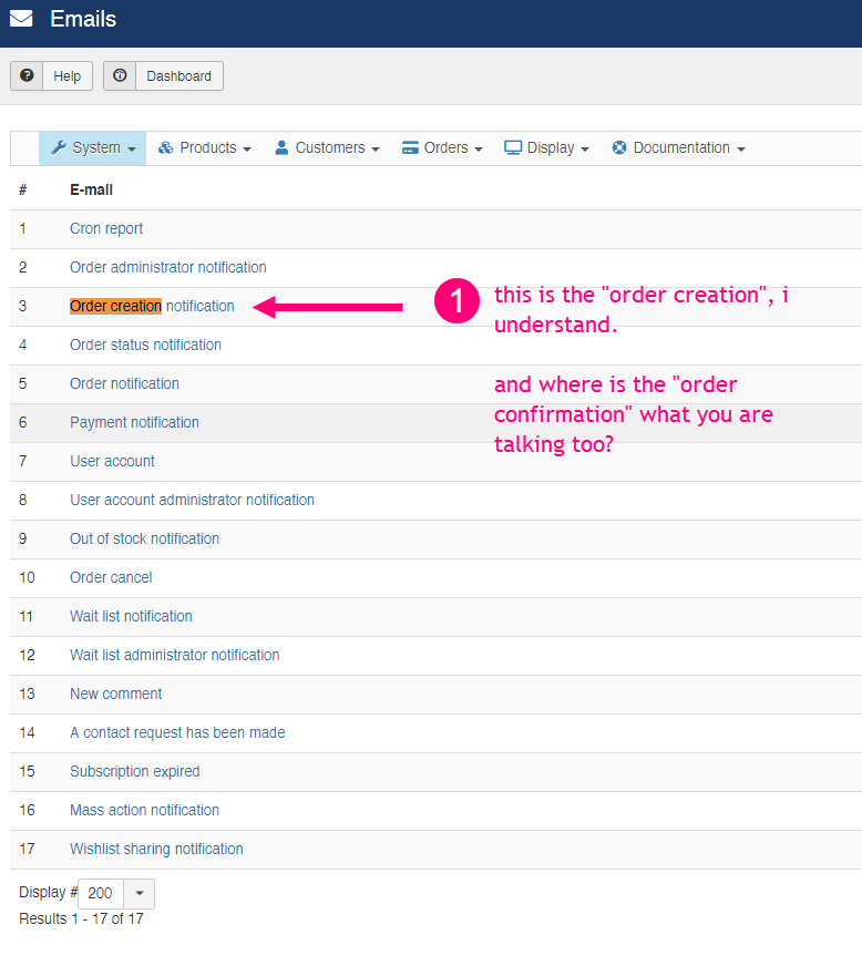

but when i deactivate the "Order creation" email, will the system also create the order?
and about the order confirmation email, i do not see this under the mails?

The order will still be created yes. Just test and you'll see.
The order confirmation email is actually called "order status notification" as it is also used when you change the status of an order in the backend and check the checkbox to notify the customer.

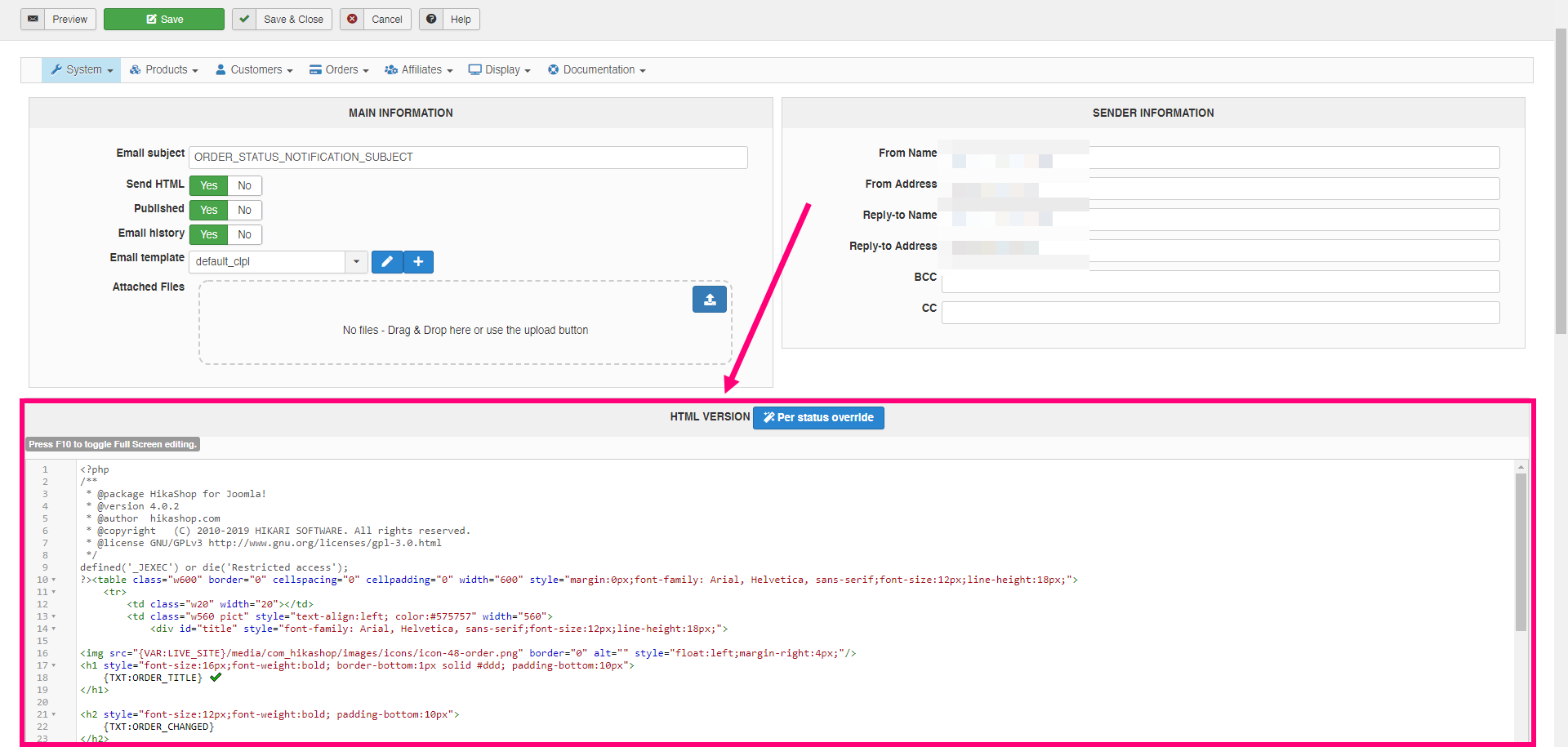

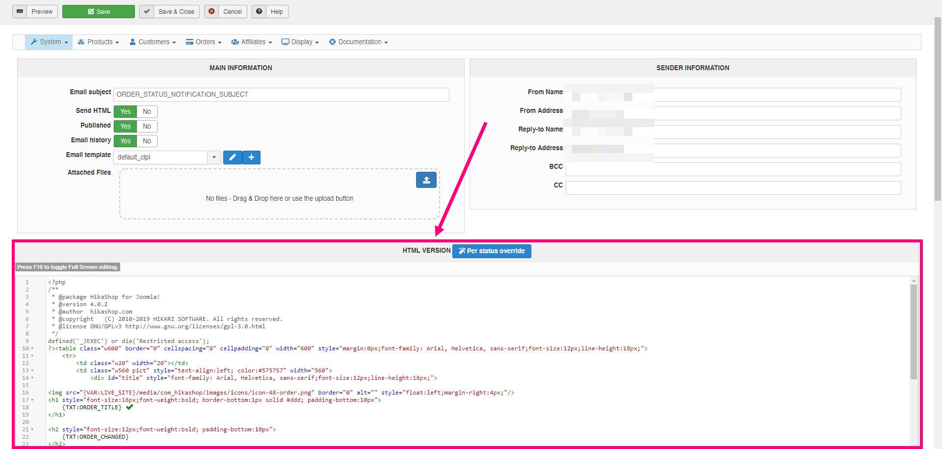

one more question: beside the Email template (root/media/com_hikashop/email-template), can i also modify the HTML versions with an code-editor and not in the browser? are there anywhere saved?

7 years 7 months ago #303092
Sure, you can find the files in media/com_hikashop/mai/
Note that it's better to first make a change in the HTML version via the interface and save, so that you modify the override file in that folder instead of modifying directly the original file so that you don't loose your changes when you update your HikaShop.
