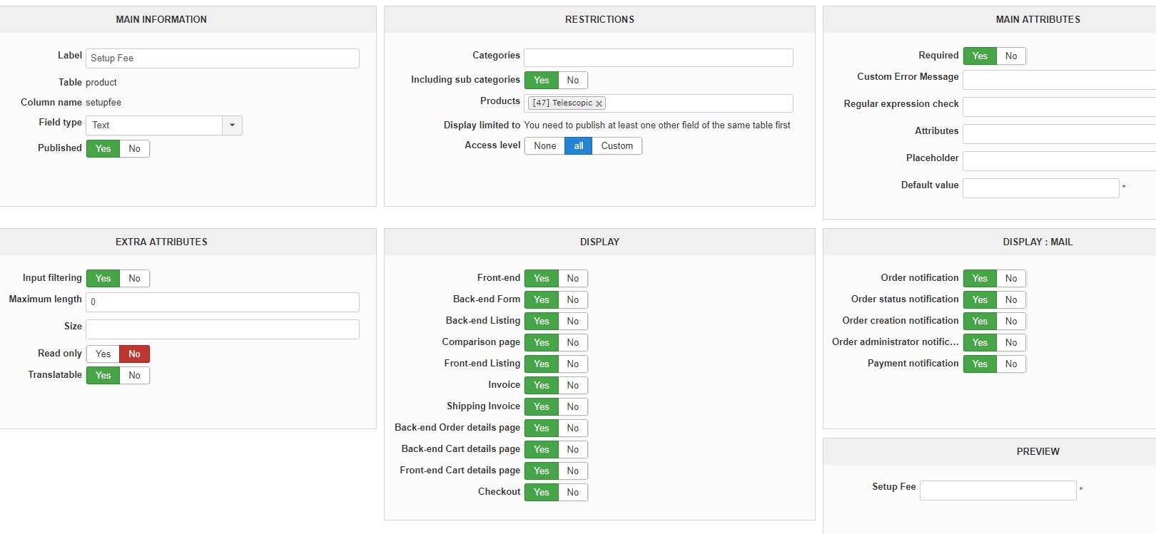

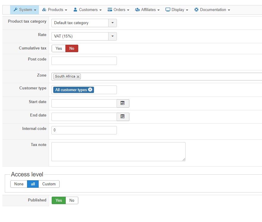

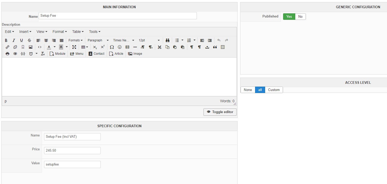

7 years 6 months ago #304022
Please provide a screenshot of the custom field settings, a screenshot of the settings of the plugin and a screenshot of the settings in the taxes area of the HikaShop configuration so that we can get a better understanding of the situation.
  • Posts: 15
7 years 6 months ago #304034
Hi Nicolas
Here are the screenshots. Thanks

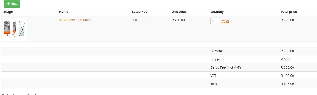

I'm not able to reproduce the problem on my end.
I configured the global cart fee plugin like that:
monosnap.com/file/eLYsPY2GJxpB9CTj8FDjf9pSzE9AMV
And the fee is properly added to the total amount:
monosnap.com/file/8oiTNdq4cYLdjXcQXMZHOLVWnEteSV
I tried without taxes, with taxes, without shipping with shipping.
It worked each time.

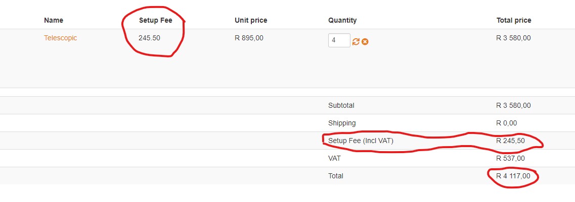

7 years 6 months ago #304157
Hi Nicolas
Thank you for your assistance with this. I have added it to the same product you used and I once again have the same problem. See attached.
Also, in your example it is not adding the Vat on that line item to the Vat total?
