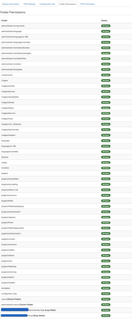

hi
just installed fresh hikashop with sample data but no sample data exists
and get this error
Can't open file tmp/dataexample/script.sql
what to do
thanks?

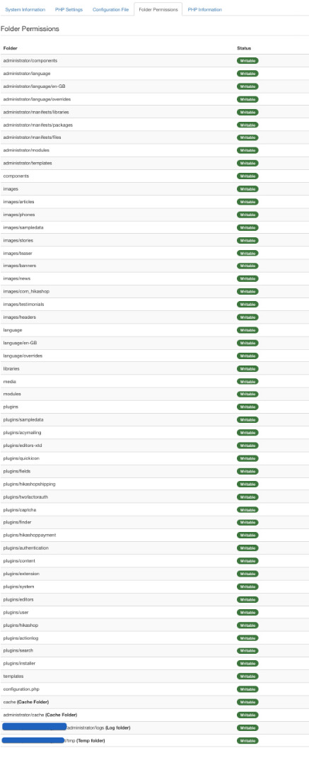

The last one I said is probably not that since your screenshots says that the tmp folder is writable.
But it could be something else.
The first thing is to try again the wizard and see if that helps and check the tmp folder to see what was done by the wizard.
