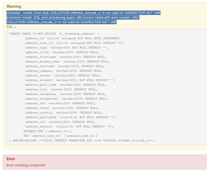

When installing Hikashop on Joomla I got the following error:

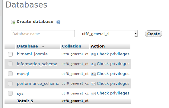

I checked the configuration of the mysql database and as you can see here after none of them are configured with 'utf8mb4_unicode_ci'
Can you please guide me to solve this issue?
many thanks
best regards

Please re-download HikaShop 4.0.3 in order to re-use the installation file using UTF8 and not UTF8mb4.
Unfortunately, a typo has been introduced in the packaging system and before restoring UTF8mb4 for "production", we will need to perform further tests.
