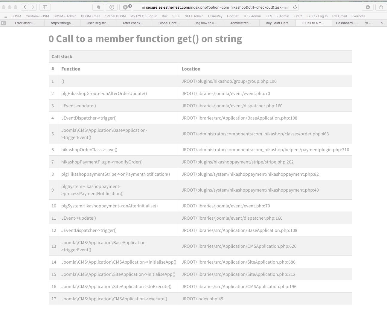

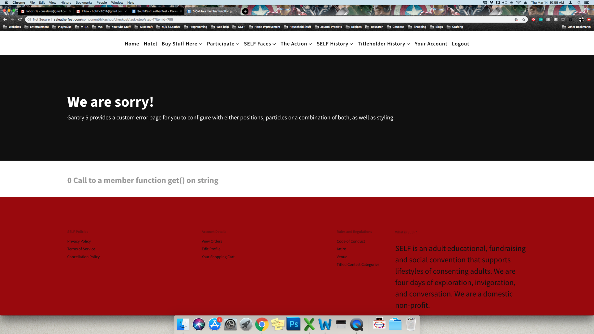

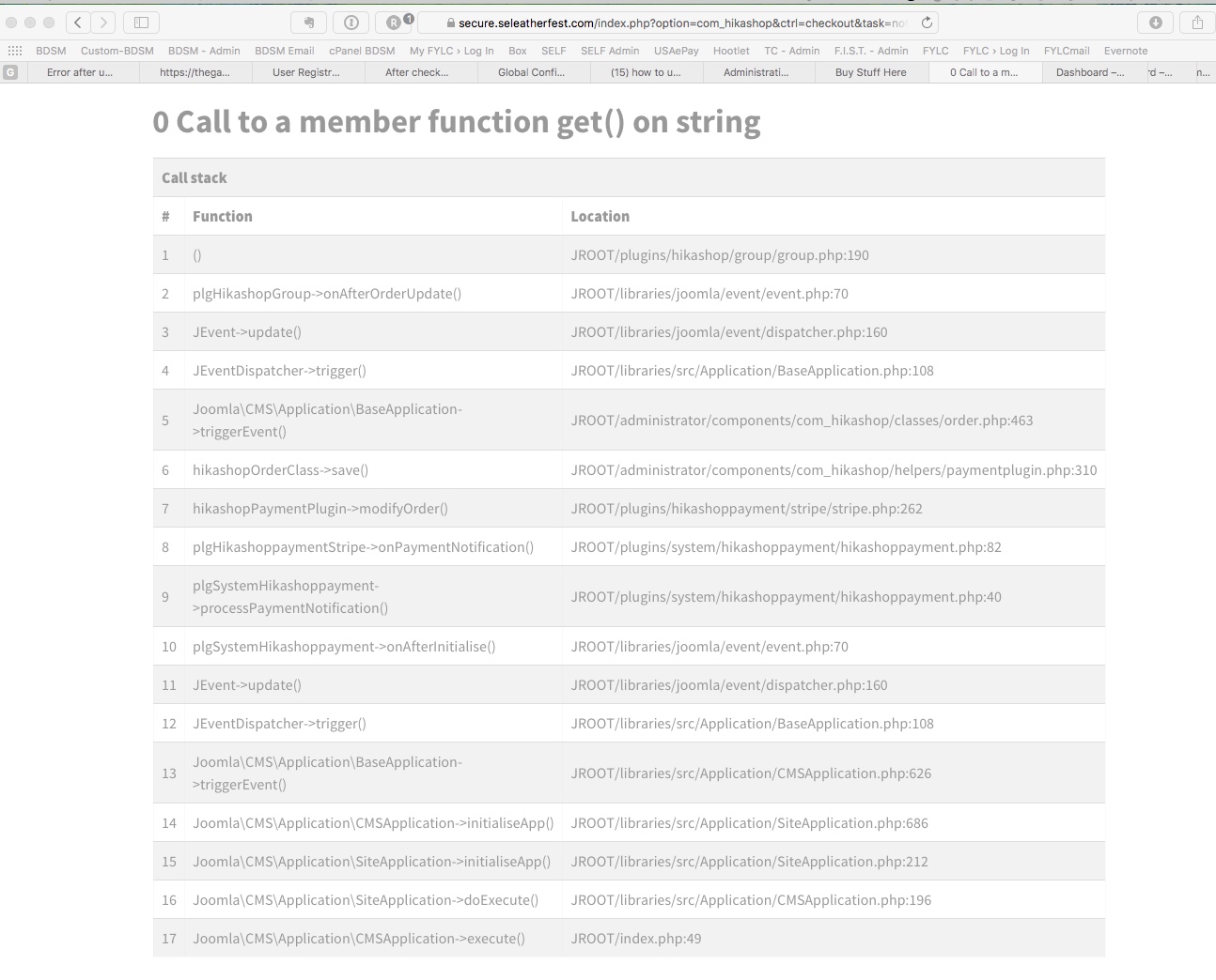

-- Error-message(debug-mod must be tuned on) -- : "0 call to a member function get() on string"
"0 call to a member function get() on string"- is the error that appears when someone has successfully purchased anything from the store. They get the email, they are able to buy but instead of the final thank you page (return url) appearing, they get this error. I have a photo we can upload for you of the error a customer sent us. How do we fix it please?

First, please activate the "error reporting" and "debug mode" settings of the Joomla configuration in order to get more information on that error and provide the addtional information you see on that screen.

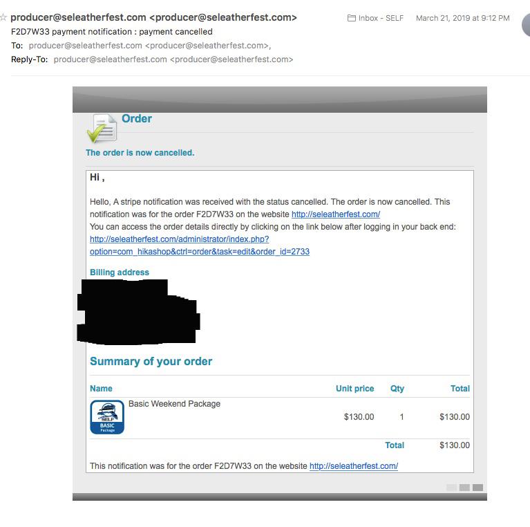

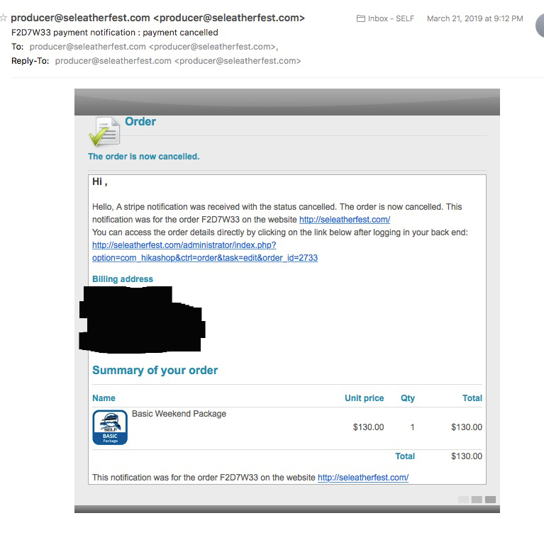

This is getting even stranger. My customers are now receiving an email telling them their order was cancelled. When they get a notification from Hikashop about the cancellation, is says this, "Hello, A stripe notification was received with the status cancelled. The order is now cancelled. " and those are the first two lines but the payment was good, it shows as good in stripe (successful). We are using version 2 of Stripe payment. This has been happening since we did the last upgrade of Hikashop.

Regarding the payment notification email, I don't see how the customer could receive it. That email is sent to the email address you entered in the "payment notification email address" setting of the HikaShop configuration. Please double check.
Also, please note that you can check all the emails sent by HikaShop via the menu Customers>Emails history.
Regarding the fact that you get a cancelled notification, I wouldn't be able to say much besides the fact that it indicates that either the Stripe library used in the plugin returned some kind of error during the notification, or the charge object returned was marked as failed.

Okay, I have a ton of information. All of this began after I uploaded the newest version. Everything had been working smoothly prior to that.

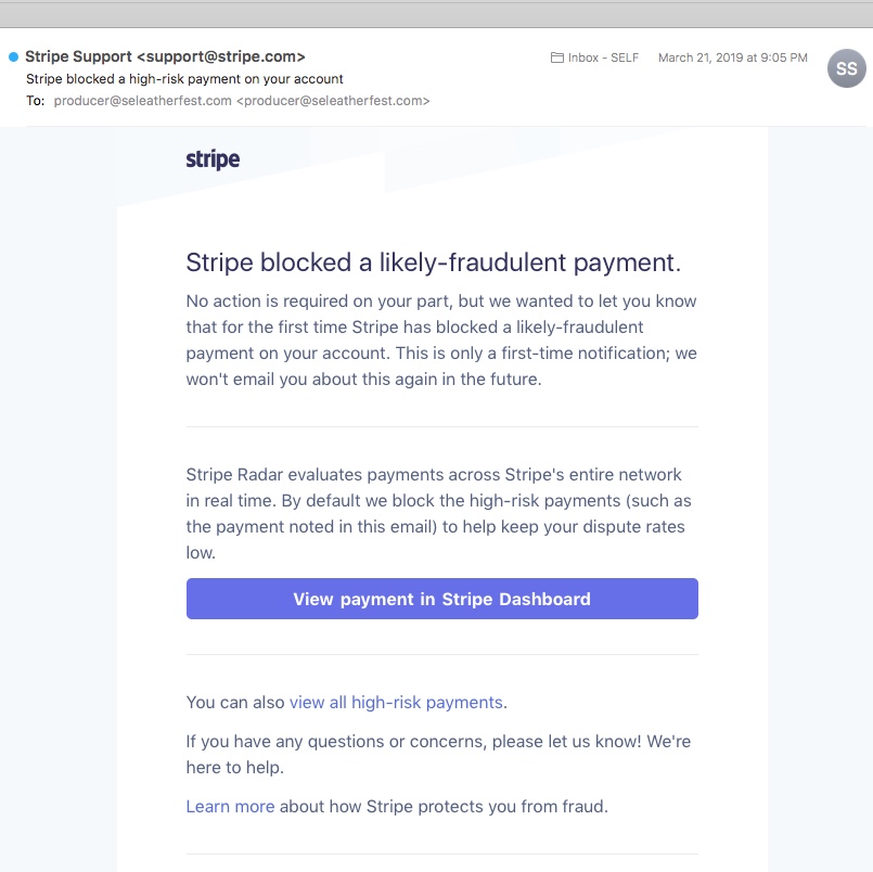

This might be overkill but I want to give you as much information as possible. I talked with Stripe for a number of hours. They are saying that there is something in the software which now is setting off Radar alarms and telling their system that all of our cards are high risk. We've been here for 24 years, our people aren't high risk. So the cards end up being declined or sent back because the systems aren't talking appropriate and then my people get sent an email that their order has been cancelled. I'll attach an email that shows that. What is interesting is in the email the URL of our site has been shortened. I noticed that, it's www.seleatherfest.com instead of secure.seleatherfest.com
I made a new user acct, made an order in test mode (stripes test api's and not the live ones) and got a page full of errors when I clicked the last button to finish the purchase. I'll attach that also. I have also attached the High Risk email I'm getting from Stripe.
There are payment logs and all sorts of debugging reports but it has information that I need to put somewhere secure. Does this help at all?

7 years 5 months ago #305073
1. Regarding the error at the end of the checkout, it indicates that HikaShop was not able to load the settings of the HikaShop group plugin and that the order that is created is changing the user groups of the customer.
I've added a patch on our end to avoid that.
Download again the install package on our website and install it on yours and it will add the patch and remove the error.
