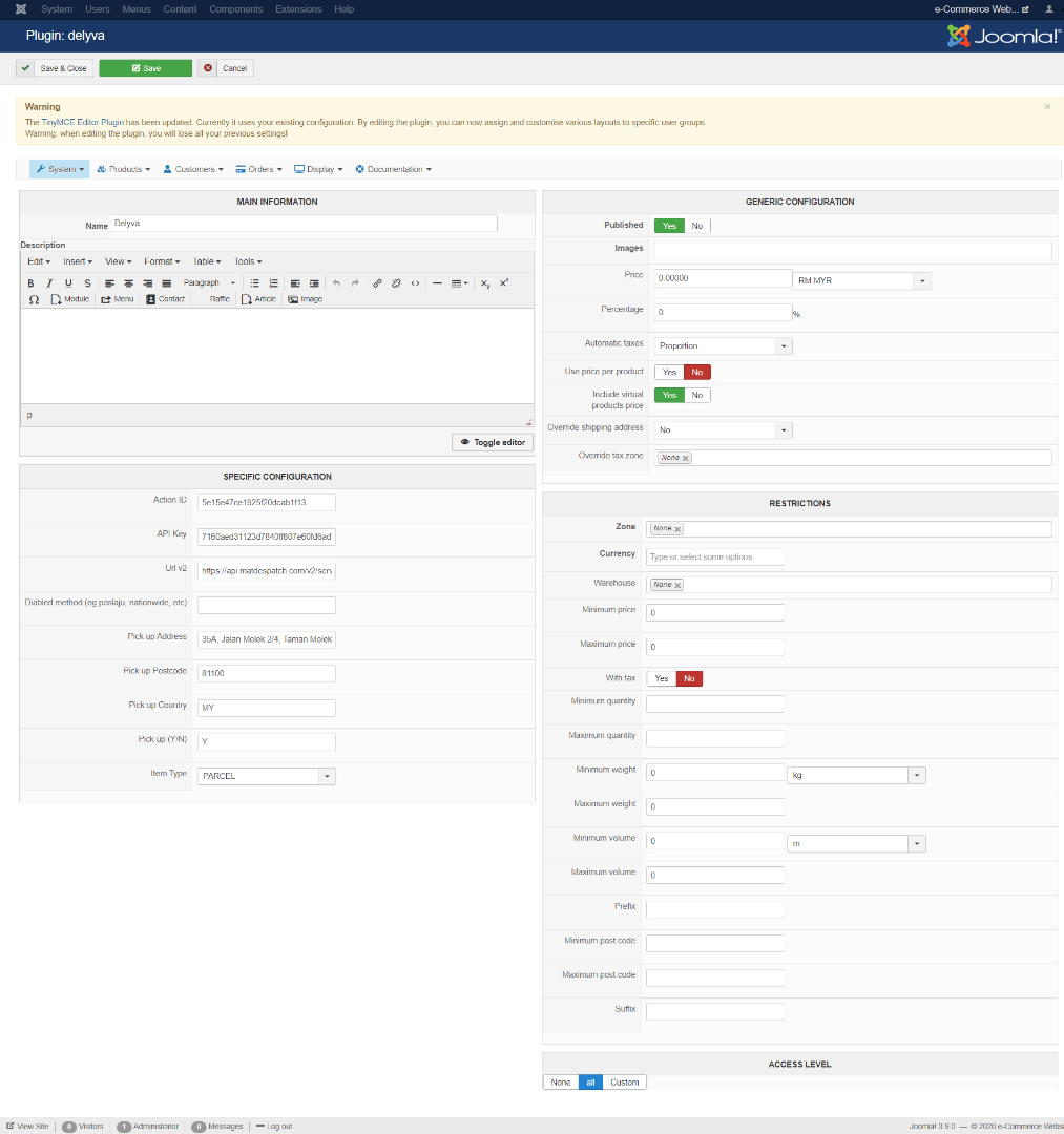

Can you provide a screenshot of the settings of your shipping method ?
  • Posts: 575
  • Thank you received: 11
6 years 6 months ago #315625
This is the screen shot

  • Posts: 86081
  • Thank you received: 14189
6 years 6 months ago #315626
I think that the issue is that the $name variable of your plugin is incorrect. It should be delyva and not Delyva.
Because of that id doesn't find any matching shipping method for your plugin and thus returns false.
  • Posts: 575
6 years 6 months ago #315639
Dear Nicolas
I have attached the latest plugin
I have change it to "delyva"
however, it become random behaviour
some cases it return false
some cases it return true
and when we click next on ecommerce.satumalaysiahosting.com/checkout
it seem like go into infinite loop.......we can never complete the check out and stuck at this page
This message has attachments files.
Last edit: 6 years 6 months ago by ler@singmuiheng.com.
  • Posts: 86081
6 years 6 months ago #315654
You should first change the line:
var $use_cache = true;
to:
var $use_cache = false;
while you're developing to make sure that the code changes you do works properly.
Then, you can change that back when the plugin is working fine.
That will help with your tests.
Otherwise, if you do some test where you don't return something to print some debug but it still caches the information, you're left with nothing in the cache afterwards and your code won't run as the result is cached. So it makes it a lot more complex to test and debug as you're not sure what is going on.
Besides this the code you sent looks correct.
It will return false when either it already has the result cached or when there is no shipping method found for your plugin (so it means your plugin doesn't have to do anything other than return.
It will return true when it wants your plugin to process his shipping methods as it doesn't have the result cached yet for the current situation.
So it can look random because of the caching and when the situation changes or not in the checkout.
Time to create page: 0.438 seconds
