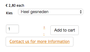

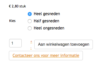

After a recent update of hikashop the characteristics selection method has changed in our webshop.
It used to be a dropdown list but now it has changed to radio buttons.
Changing this in the settings does nothing.

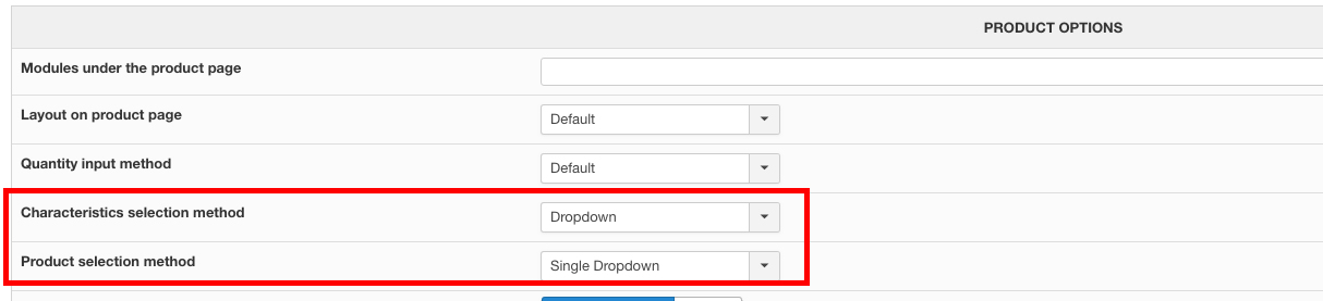

I've provided some screenshots of what it used to look like, what it looks like now and what settings i've tried changing.

Your third screenshot comes from the setting of the HikaShop configuration. However, in each characteristic, there is a similar setting so that you can override the general setting per characteristic (and thus you can have some characteristics with a dropdown and some with radios).
So I would first recommend to check the settings of your characteristics via the menu Products>Characteristics.
