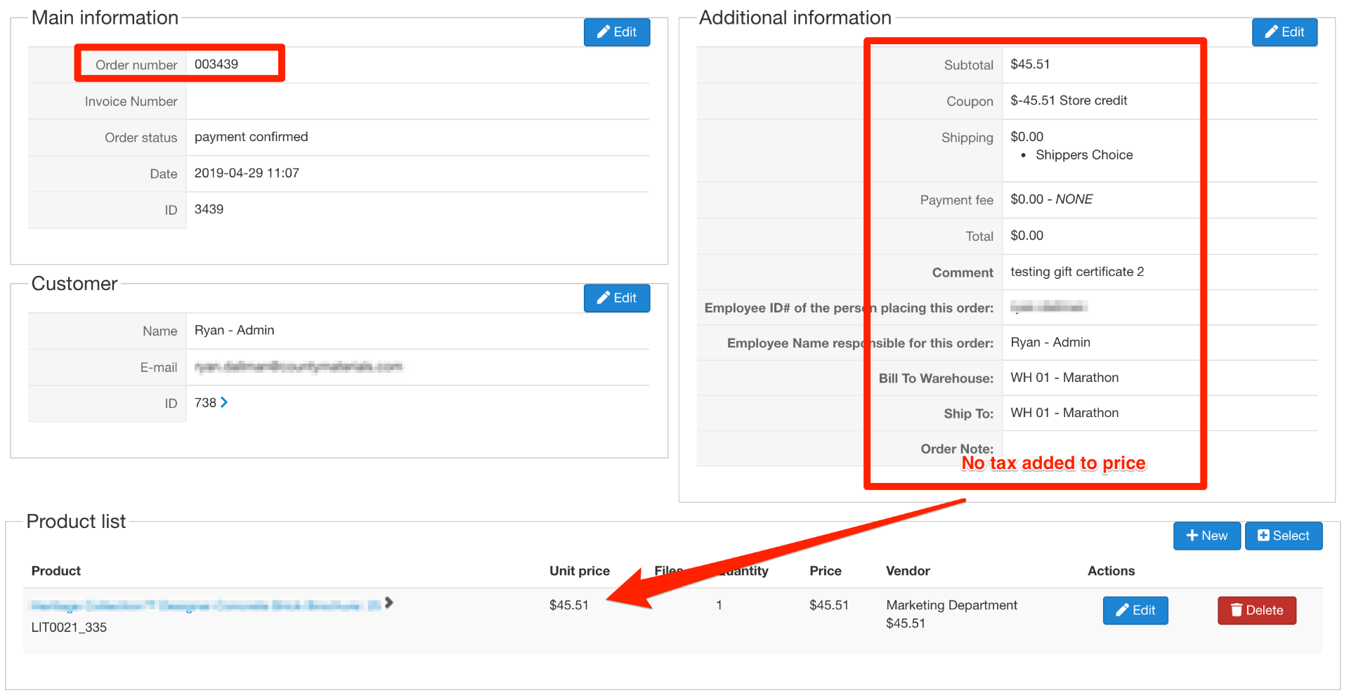

We recently became aware of an issue with the TIC code set for the products in Hikashop not coming through to Taxcloud.

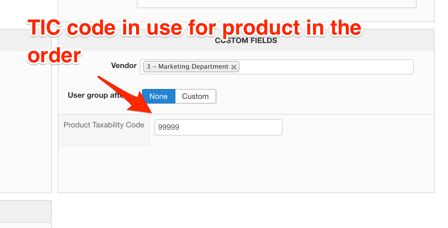

We have the TIC code set as 99999 for several items (In-store Sales). This is working correctly in checkout (no tax is added).

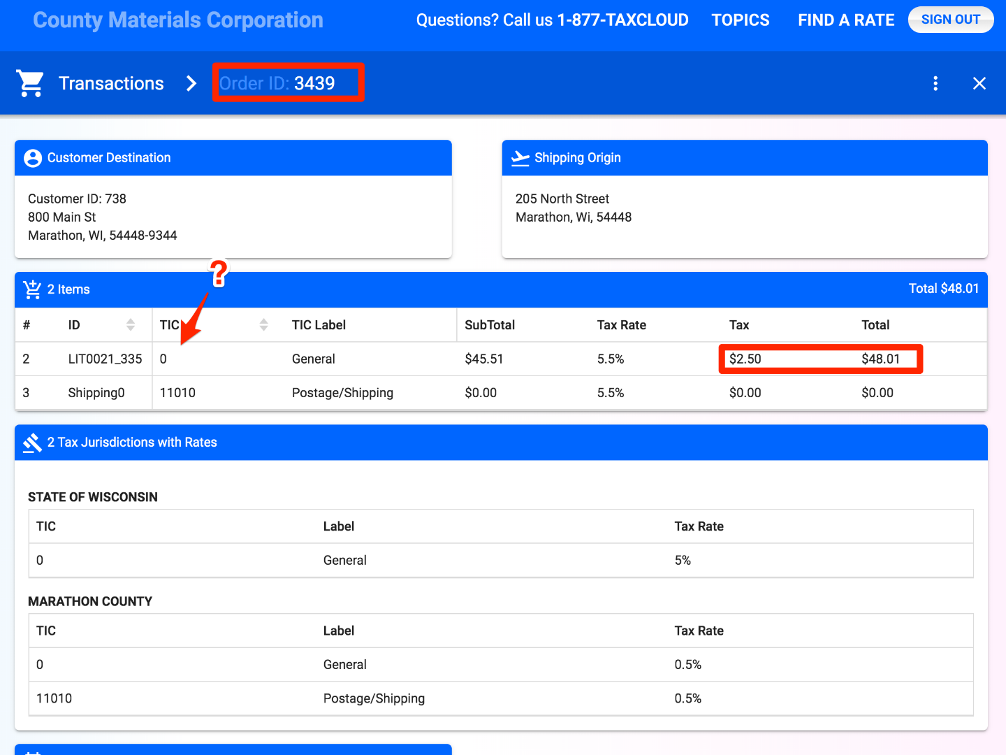

However, in Taxcloud the TIC associated with the orders is "0" which results in tax being added on the Taxcloud side.
Looks like the TIC set in Hikashop is not coming through which results in us getting charged incorrect tax each month.
Images attached for reference.
Please advise.

I don't see the ability to set TIC codes in the variant settings. On the variant tab under "Custom Fields" there is only "Vendor" and "User group after ...". Product Taxability Code is only found on the main product tab.
