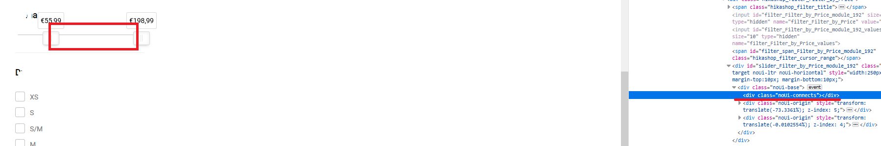

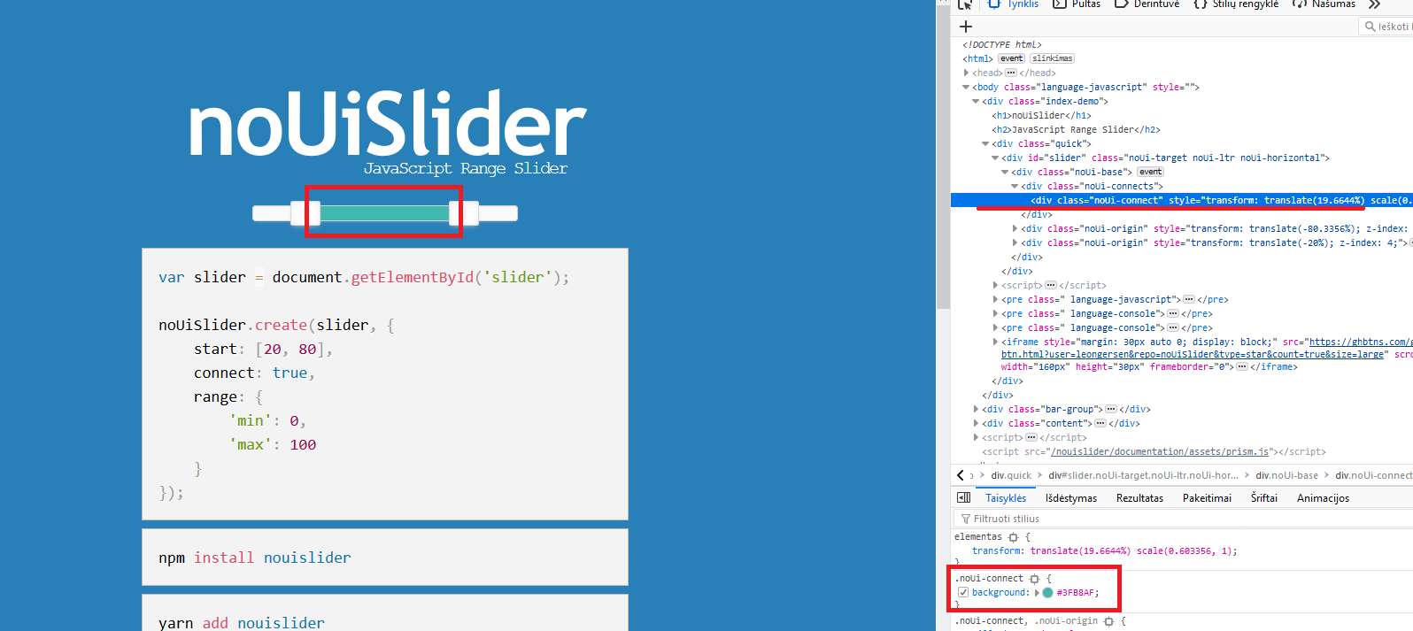

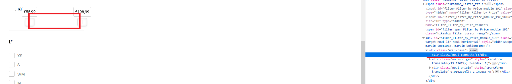

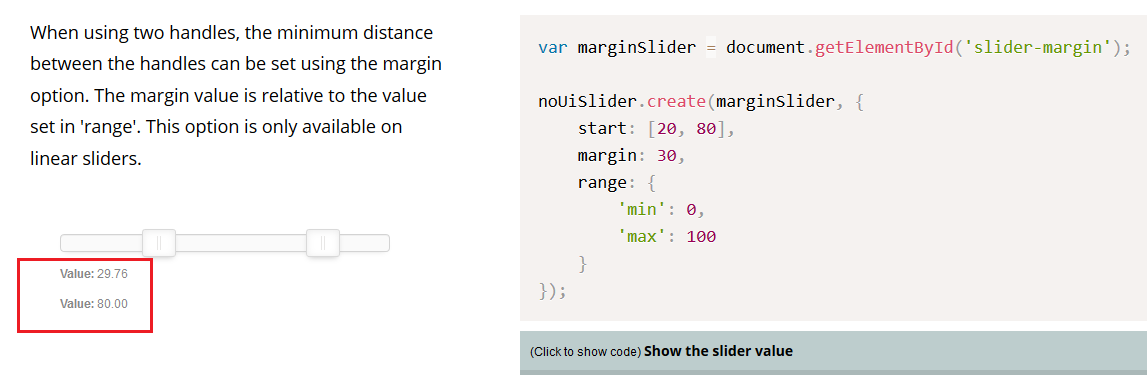

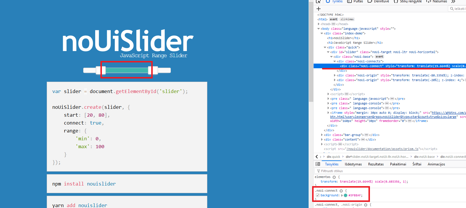

4. Been trying to add some styling to new cursor filter and found that there is no possibility style ( add different color) current range state. Please take a look at screenshots:

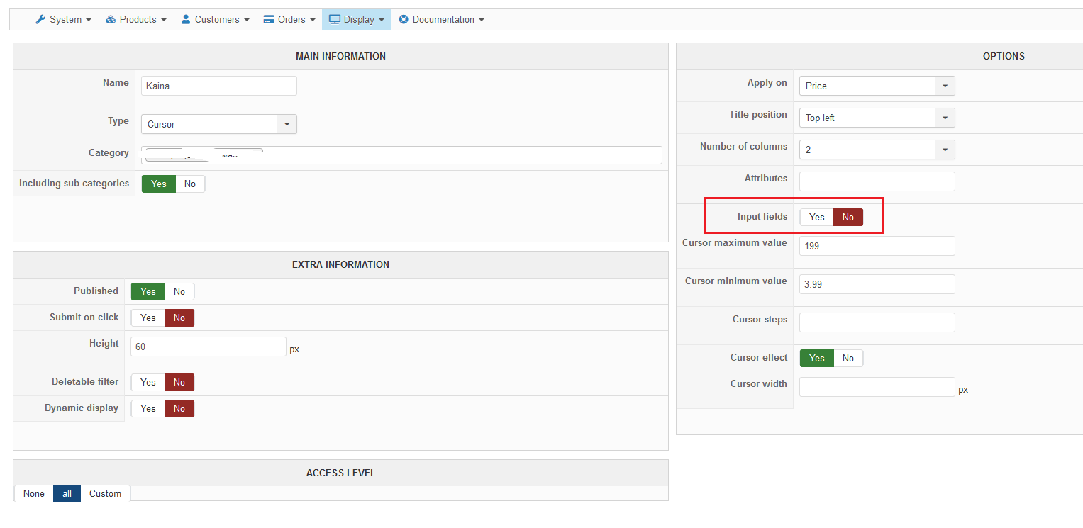

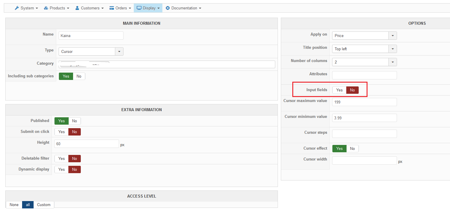

5. Filter type cursor, setting input fields to "YES" and saving, it wont save and goes back to "NO" after page refresh. Not sure what it does thought...

And one more...

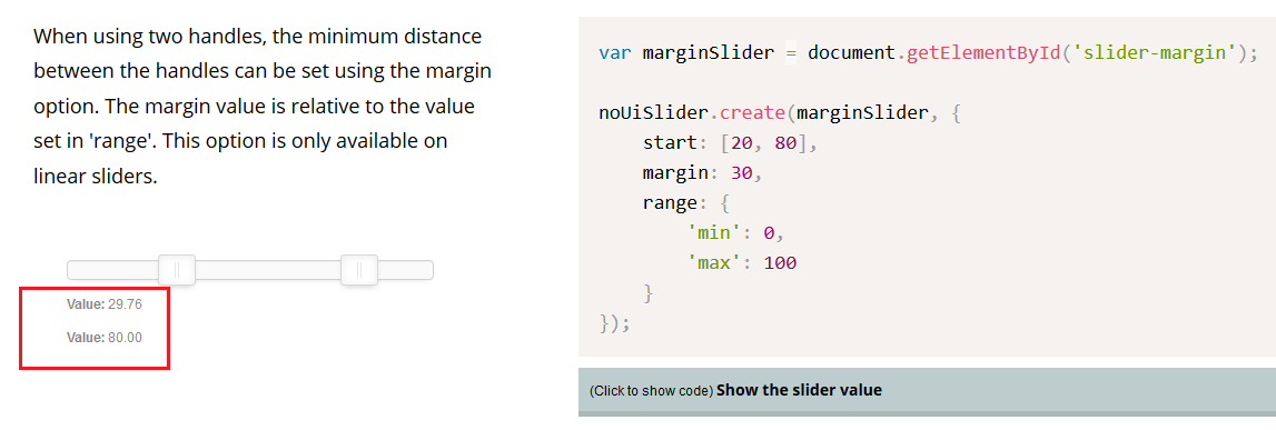

6. Using price range, price is displayed via tooltips but how could we make them static/fixed as it was with old price range?
I could disable it using:
tooltipSlider.noUiSlider.removeTooltips();
But the price range would be not displayed at all. Would be great to have some settings regarding this.
Thanks again.

1. and 3. Craming all the CSS and JS into one file is definitely not what we want to do. I can only see disadvantages. Otherwise, we would also have all the PHP code of HikaShop into one file... expect you would load plenty of things which aren't used most of the time and the memory requirement would be enormous. Adding the nouislider CSS (4KB) in the default CSS of HikaShop would result in the default CSS of HikaShop being 4KB bigger while only 1% of the people have a cursor filter which need that CSS. You might say that for this, there's not a lot of CSS so that's fine, but it's the same for all the other CSS and JS files.
Normally, when you start having a lot of CSS and JS files loaded, what you want to do is use a JS/CSS compression tool like JCHoptimize so that it generate cache files of the CSS/JS files so you end up with only 1 file for the CSS and 1 file for the JS on each page, especially optimized for the needs on your website.
Now, having hidden options to remove all the JS/CSS files could be something to do. But I'm afraid we'll end up with additional support as people set these options while they don't know what they do. Please understand that we make HikaShop for everyone, no just for people who know what they do :)
2. webp images are stored next to the thumbnails. So if you have your thumbnails in images/com_hikashop/upload/thubmnails/... then you'll find the webp images there. They are generated dynamically, like other thumbnails. So when you change images in the backend, nothing will happen until someone displays the images on the frontend and new thumbnails and webp images are regenerated for the new/modified images.
4. and 5. Good points ! Thanks for the feedback. I've added patchs for both. Download again the install package on our website and install it on yours and you'll get the patchs for these points.
6. It's the "input field" setting which allows you to do that. With the setting fixed, you'll be able to activate it and get a fixed display of the cursor values.

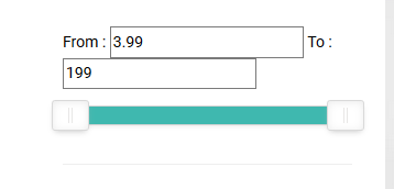

1. Indeed you right. So the question is what is worst? To have 1 extra request for people using cursor filter or to have few lines of css for everyone who use front-end css :)
2. Input fields does work now but values are not updated dynamically when you move cursor? Also why it's input fields if basically user will use cursor for adjusting the values insteed of writing them directly into input fields? Why not just have values as per nouislider documentation?
Thank you for your time.

2. The values are updating dynamically on my end. Could you give a link to the page if that's not working on your end so that we can see the situation ?
Having input fields with the value instead of plain text is something that was requested by several people. The big advantage is that on mobile devices, it's a lot easier to enter the value in the input fields rather than drag the cursors with your finger, especially if you want a precise value and you have a lot of steps possible.
