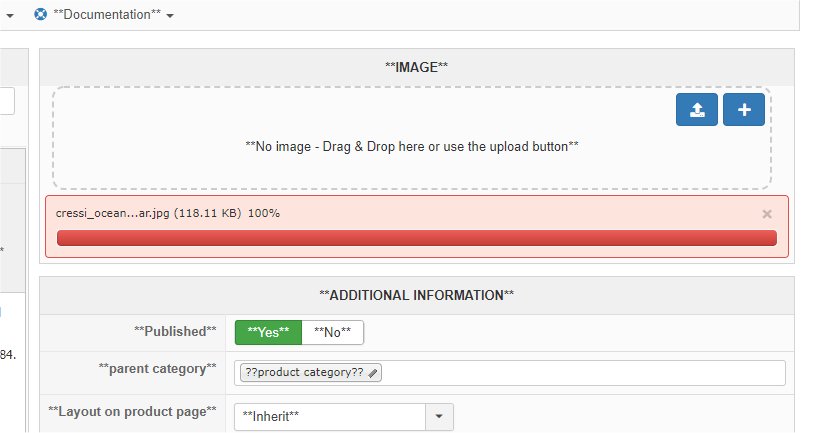

I have the just broughed the buisness version but Im not able to upload photos in products, categories etc... When I try the upload box turns red insted af green and the photo dont show up.
I can see the photos are uploaded to the folder /public_html/images/com_hikashop/upload/
But beside the file that is uploaded a file ending .webp is created.
I also have the issue that ever like 5 time when i click a link I get an 404 error, If i update the page then it loads. Not sure if there is a patch issue or something.
I have the free version I have used for testing on another domain name and there I dont face any issues.
Please advice.

When I look at the response from the server during an upload on your website, I see that it looks like a 404 SEF URL routing error page from the frontend: monosnap.com/file/h00jp3fgwpNLqekHGnouVMlPaCDYX9
This should never happen in the backend as the SEF routing is not used there.
In fact, I get the same issue with the + button which is supposed to open the image selection:
monosnap.com/file/d4ybKtIDyskOpuRsxx8x3sZ9cdJ00O
What's even strange is that if I look at the upload folder with the Joomla Media manager, I do see the images, so they did get uploaded. It's just the display of the data back to the javascript on the page which didn't work.
I don't know why this happens though. Would you have some changes in the .htaccess file of your website compared to the default one of Joomla ? Or maybe it's something related to the hosting setup ?
I also thought about strange plugins of the group system which could affect the display of the page after the rendering of the page, but I didn't see plugins which seemed strange on your website.

  • Posts: 86081
  • Thank you received: 14190
7 years 3 months ago #306629
The webp image is a feature we've added in HikaShop 4.1.0
This allows for faster page rendering for browsers supporting it:
developers.google.com/speed/webp/
When you say that you tested on another website on the same server with the Starter edition, did you also use the 4.1.0 ?
Also, if you use the Essential 4.1.0 on that other website, do you have the problem too ?
Knowing these would also us to know if the problem comes from the differences between the Starter and the Essential edition (which I don't thing is the case), or the differences between an old version of Hikashop and the latest (which could be related to the changes we made for the support of webp), or the other extensions you have on the first website where you have the issue and the other one where you don't have the issue.
