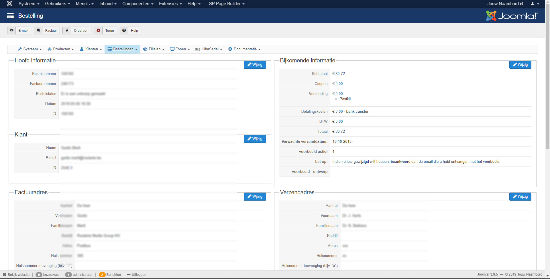

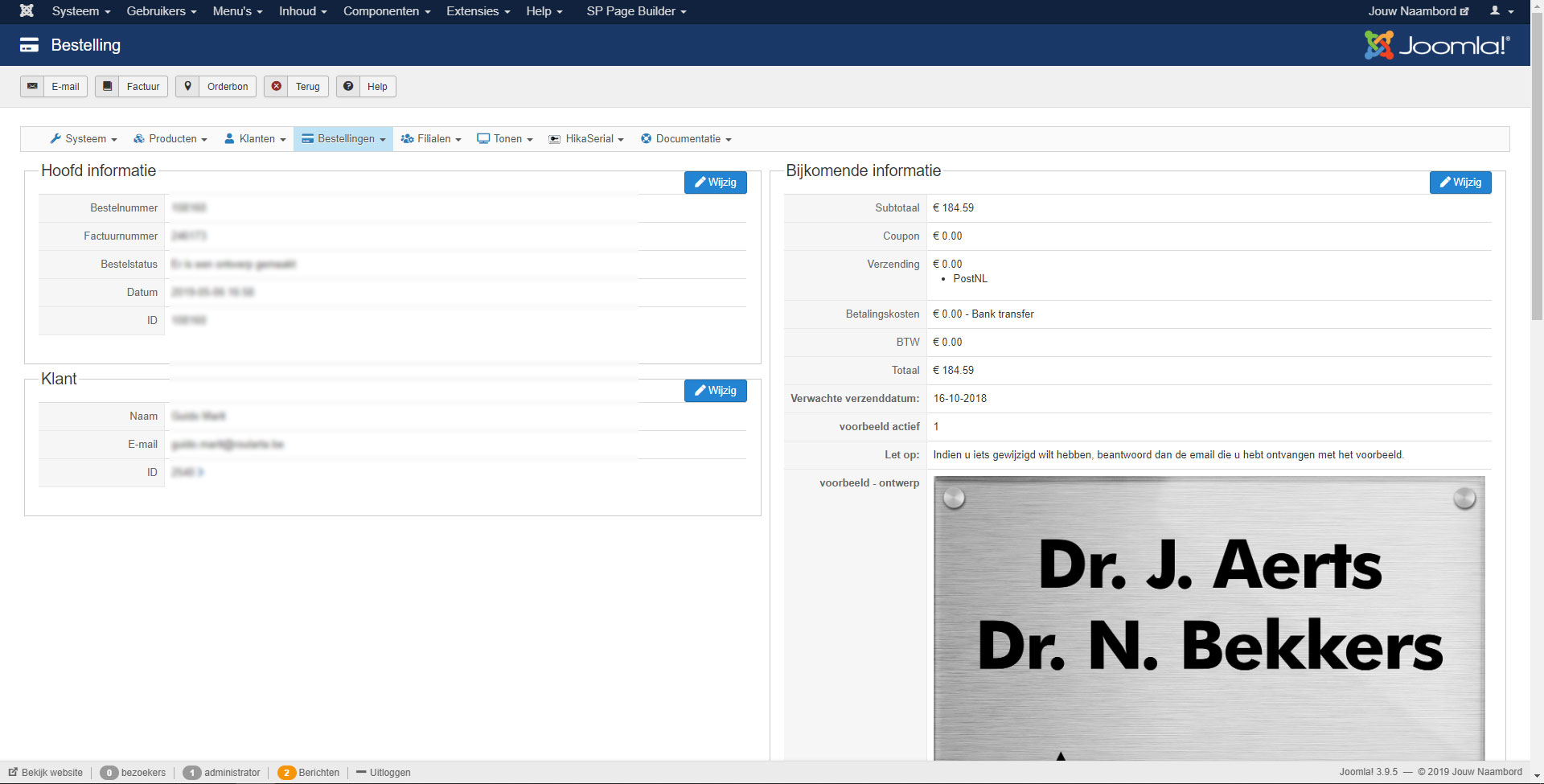

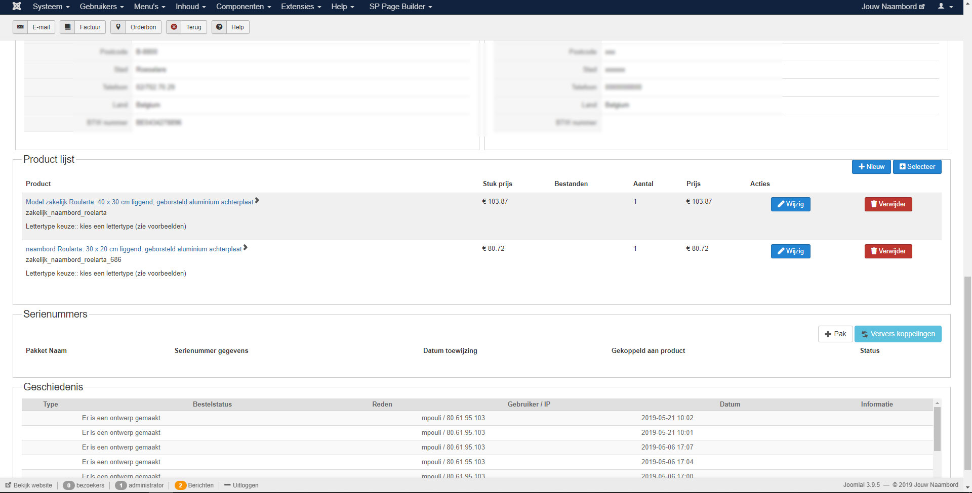

Every time I remove a product from an order I get an error and the sample image (custom_field)I wich is assigned to the order will disappear from the backend form. See the screenshots.
Could this be a bug?
Michel.

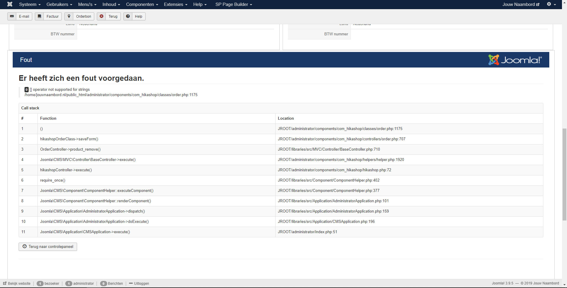

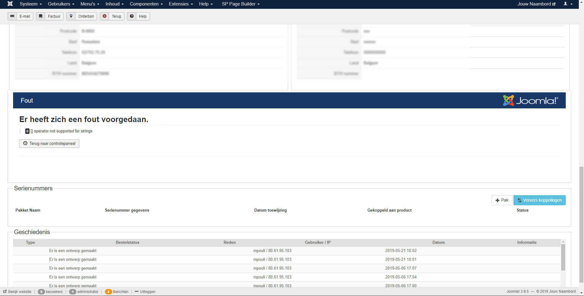

Here the screenshot with the debugmode activated.

7 years 3 months ago #306867
Thank you.
Change the line:
$order->product[] = $order_product;
to:
$order->product = array($order_product);
in the file administrator/components/com_hikashop/classes/order.php and that should fix the problem.
