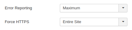

Ok, first of all can you switch On your Joomla Debug mode and have "Error Reporting" to maximum in order to get more informations.
Then, can you test to process some test with your sveawebpay unpublished

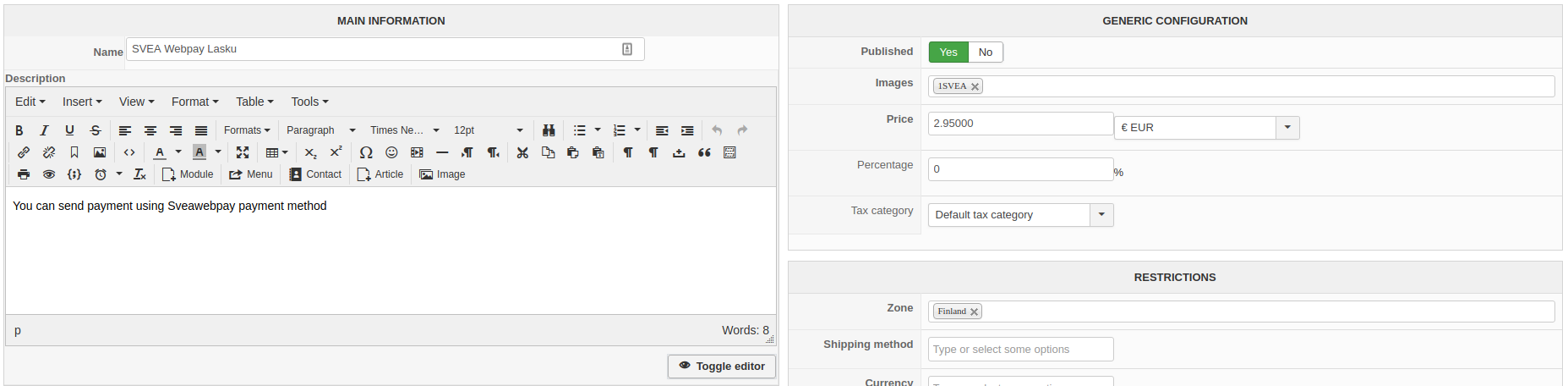

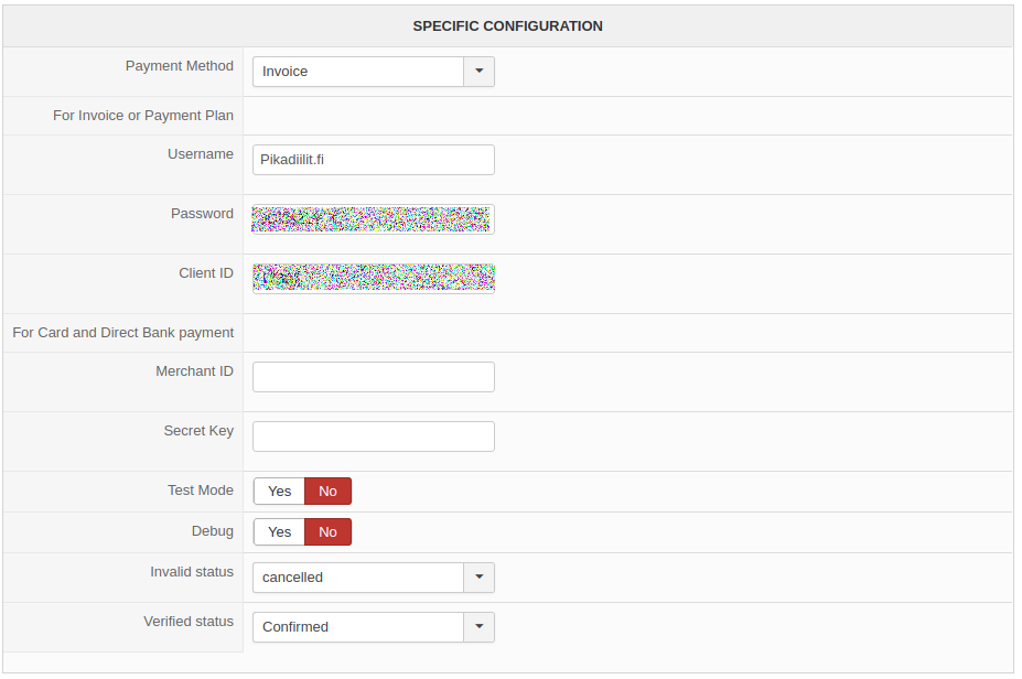

7 years 2 months ago #307273
Hello Philip,
Debug mode was already On with error reporting set to maximum:
The memory exhausted errors is all that is displayed.
As I mentionned in my first post, without svewebpay enabled it works. I'm able to place orders using other plugins like collect on delivery or bank transfer. Order is created, all necessary mails are being sent.
Here is the configuration of the plugin.
Note that it's crashing with and without test and debug enabled in the plugin.
Best
Olivier
