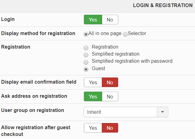

When customers order a product they can checkout as a guest. If the shipping address is different than the invoice address they can't change it but have to log in first. In the attachment you see the the login/registration settings.
Which setting do I have to change so "guests" don't have to login but can fill in a different shipping address?

You should turn off the "checkout legacy" setting in the HikaShop configuration in order to switch to the new checkout of HikaShop 3 and 4. You're using the checkout from HikaShop 1 and 2 and it has some glitches with the popup mode for the address selector.
The new checkout works much better and has more options if you want to fine tune it in the HikaShop configuration.

Thank you Nicolas, that solved the problem.
