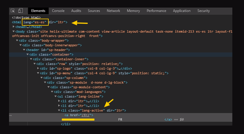

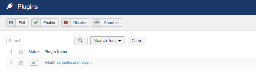

When Hikashop Geolocation plugin is activated (I think it is by default) Joomla! multilanguage tag html is not built correctly and even if we change the language on the site (vía switcher menu), language html tag still indicates the selected language by default in our configuration of Joomla! multilenguaje.

Can you confirm that when you turn off the plugin you don't have the issue ?

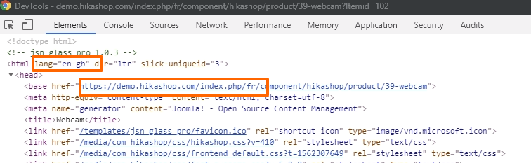

You can see one example in the Hikashop demo Multilingual Store and you see language tag in Japan or French demo.
If you turn off the plugin , you will see language tag correct.

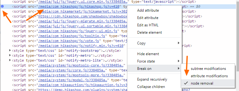

Also, in your browser Chrome tools or IE, please clean history, close sessions, etc, you will see how Joomla! Multilanguage work fine if you make a node removal script the media hikashop.js

Supposing that it comes from that plugin (and I don't see why it would since we didn't configure it to do anything on our demo website), you could try changing the "After initialisation" setting of the plugin. This dictactes when the plugin is run when the page is processed.
However, I really doubt it comes from that plugin. This plugin is supposed to get the location of the user based on his IP address on the first page accessed by the user and set that information in the session. Once it's set there, the plugin doesn't do anything on the other pages. It doesn't even load HikaShop.
Finally, adding a break on node removal of that javascript file should not do anything. Doing that should stop the javascript processing of the page when that javascript file is removed from the header of the page. However, there is nothing which should remove that javascript file from the header while the page is already loaded. If it were removed, it would be by a system plugin like JCHoptimize and that would be done in PHP so adding a break on node removal wouldn't do anything as that is on the browser side.
To me this just sounds like a simple issue between the template and the language switcher module/menu:
The template must have already calculated the language to use in the header before the language is switched on the resulting page. Hence you only get the correct language attribute on the pages after the first one which does the switch.
