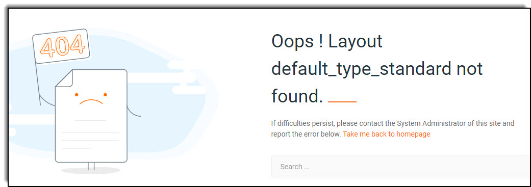

URGENT REQUEST- SITE IS DOWN: Very tight timeline on new web site for customer.
New site using Joomla 3.9.8 and Joomlashine JSN Mall 1.0 template. Everything was working fine until installing HikaShop Business 4.1.0 and now getting 404 Error Layout default_type_standard not found when trying to access the front-end of the site.
Template - Joomlashine JSN Mall
Plugins - Akeeba Backup Pro & Akeeba Admin Tools Pro
Is HikaShop compatible with the Sun Framework used by Joomlashine?
Thanks in advance for your assistance!

HikaShop is supposed to work with any template.
And that "default type standard" layout isn't from HikaShop.
So I'm not sure your issue is related to the install of HikaShop.
Try to disable HikaShop via the Extensions->Mange->Manage menu of Joomla. If you still have the error after that, then it's not linked to the install of HikaShop.
Also, before you access that page, activate debug mode and error reporting settings of the Joomla configuration. It should display more information on where the error is coming from which will help us/you understand which extension is involved in the issue and which file. That will help in fixing the problem.

It appears Hikashop Business adds 5 menu items. After making the first HikaShop menu item the default, the front-end started working. Then I went back and made the JoomlaShine JSN-Mall Home the default menu item and the front-end was then working there. IMHO there appears to be an installation issue with Hikashop but not sure why making Hikashop the default menu item corrects the issue. Unable to recreate the problem so debug doesn't show anything.

So this tells me the problem is an incompatibility between HikaShop and the Joomlashine JSN Mall template. When I turn on Debug there is nothing showing at the bottom of the page so that suggest it is something that is being flagged early in the load process.

We are unable to provide access to unauthorized companies/individuals per company policy. This should be simple for you all to setup a test environment by installing Joomla 3.9.8, the Joomlashine JSN Mall v1.0 template and then install Hikashop 4.1.0 Business.
When we make any of the Hikashop menu items the Default menu item, the front-end loads fine. However, it we make any JSN Mall menu items the Default, we get the 404 error message and the front-end does not load. Everything was working fine until we installed HikaShop. Logic seems to point to Hikashop being the problem but it really doesn't matter who's software is at fault. It just needs to get fixed ASAP. It has been almost a week and we need some movement on this NOW and quit stalling and pointing fingers.

While setting up a test environment with the template on our end to try to reproduce the issue is possible, it could take a while as we don't have a copy of that template. So we'll first have to request it from JSN. And that doesn't mean we'll be able to reproduce it as something else might be at play here, especially since we don't have the layout mentioned in the error message in the code of HikaShop and thus it can't come from the code in HikaShop.
That's why I suggested an access to your website in order to rapidely look into it. That's the fastest way to go about it, actually.
I've requested a copy of the template, so we'll see, but there is a high chance that I won't be able to reproduce the problem.
What you could try in the mean time is to rename the folder templates/YOUR_TEMPLATE/html/com_hikashop/ via FTP to something else. That will deactivate the overrides of HikaShop from your template and it should hopefully fix the problem.

This morning I downloaded Joomla 3.9.10 and installed it on a fresh version of Linux Apache server, downloaded Joomlashine JSN Mall template (for your information, this version of the template has a free 15 day trial - www.joomlashine.com/joomla-templates/jsn-mall.html ) and downloaded Hikashop Business 4.1.0. It took me less than 40 minutes to download and install everything to duplicate the error.
Just because this 404 Error is not part of HikaShop code doesn't mean that HikaShop is clean because it is when HikaShop is installed everything quits working.

You wrote "What you could try in the mean time is to rename the folder templates/YOUR_TEMPLATE/html/com_hikashop/ via FTP to something else."
There is no folder by that name in the "templates/jsn_mall/html/" folder. Could it be something went wrong during the HikaShop installation process?

I actually took the time to get the trial version of the template and set it up on my end and unfortunately I didn't get the error.
I'm able to access all the different pages of HikaShop on the frontend and it works just fine:
monosnap.com/file/3hyTtCgWZB8JiHJvwGcvgbeSjHHBfU
So there is something else to it.
Maybe it's because of your version of PHP is different than mine, maybe you did some configuration steps I didn't do, or vice-versa.
