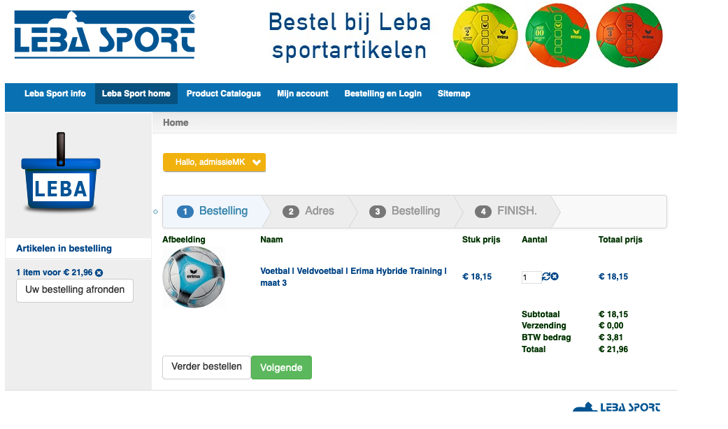

Problems with joomla 3.9.10
In two test sites i see that the "next button " in the order is blocked. So the order can't be finished and send. This was on localhost. In the online test also the same and the login account dissapears.
Normal function in Joomla 3.9.9 the order is fine till the end, finished and send.
In the normal shop i had online the same problem an i put back the backip site from 9 july with joomla 3.9.8 because we want orders. So i can't show you in real. Will test this by yourself please?
best regards
