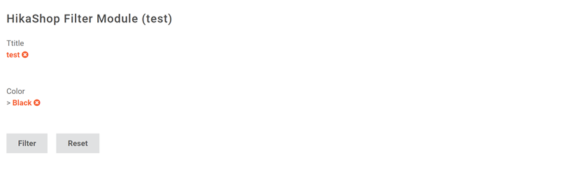

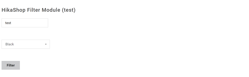

7 years 4 months ago - 7 years 4 months ago #308940 by Greg_C
Hi, Yes, I know that Reset Button should appear after Filter is set. Please find enclosed screenshots from test page how it looks in Hikashop 4.1 (image 1) and how it looks in Hikashop 4.2 (image 2) after Filter is set (selection confirmed by using button Filter).
You can see test page here: test page
Greg

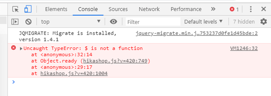

before deletion of the line in filter.php I see following error in console:
after deletion of the line in filter.php there is no errors in console
Greg
7 years 4 months ago - 7 years 4 months ago #309133 by kyratn
Try changing this:
Code:
window.hikashop.ready(function($) { // init Isotope var $grid = $('.masonry-grid').isotope({
to this:
Code:
window.hikashop.ready(function() { // init Isotope var $grid = jQuery('.masonry-grid').isotope({
And that should fix your issue.
