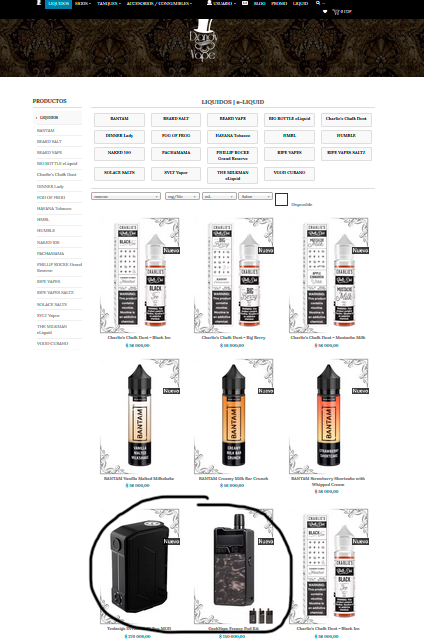

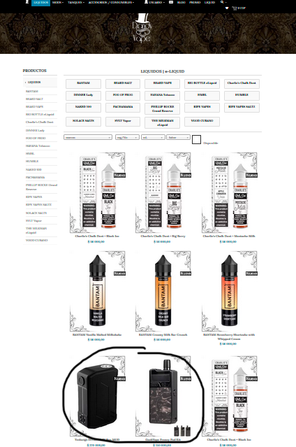

Hi, After the update, I have problems with the list of products in parent category.
I have a menu with list of categories, and that shows the sub-elements of the child categories, but there are products that do not belong to these categories.
The list of all products on the web appears, this before the update did not happen.
Looking at the files the problem is generated by the new file listing_div.php
I forgot to mention what happens using infinite scroll
Note: I do update in local environment.
Thanks for your help!

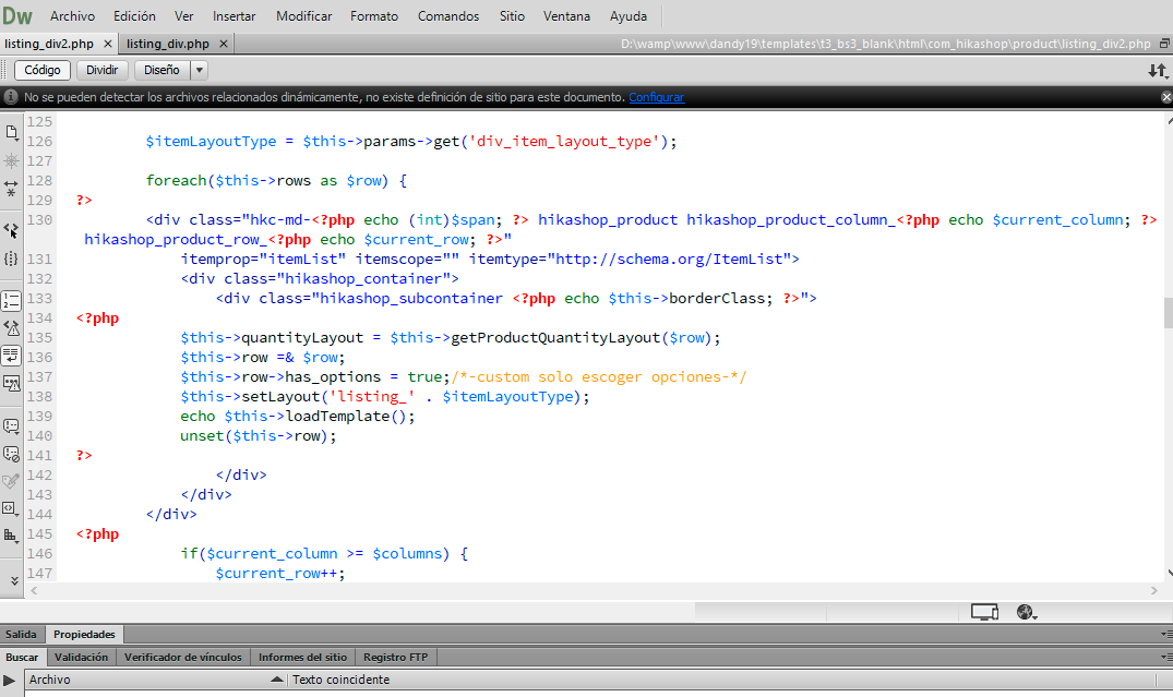

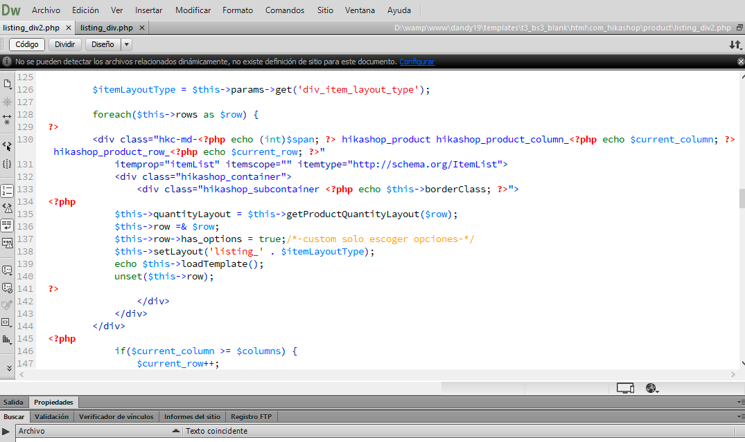

I have a template override of the listing_div.php view of the previous version, so it works well, when I use the 4.2.0 update, the list changes, shows products that do not belong to the parent category.
The son categories work well.
When the update comes out I update all the files that I have changed for my template. I tried to do it with this file but this problem happened.
Try to try a new menu item, but the Infinite scroll does not work, and I can not see more products.
this is the only change I have in the file of the previous version.
Thank you for your help, please help me understand what happens, or how I can solve this

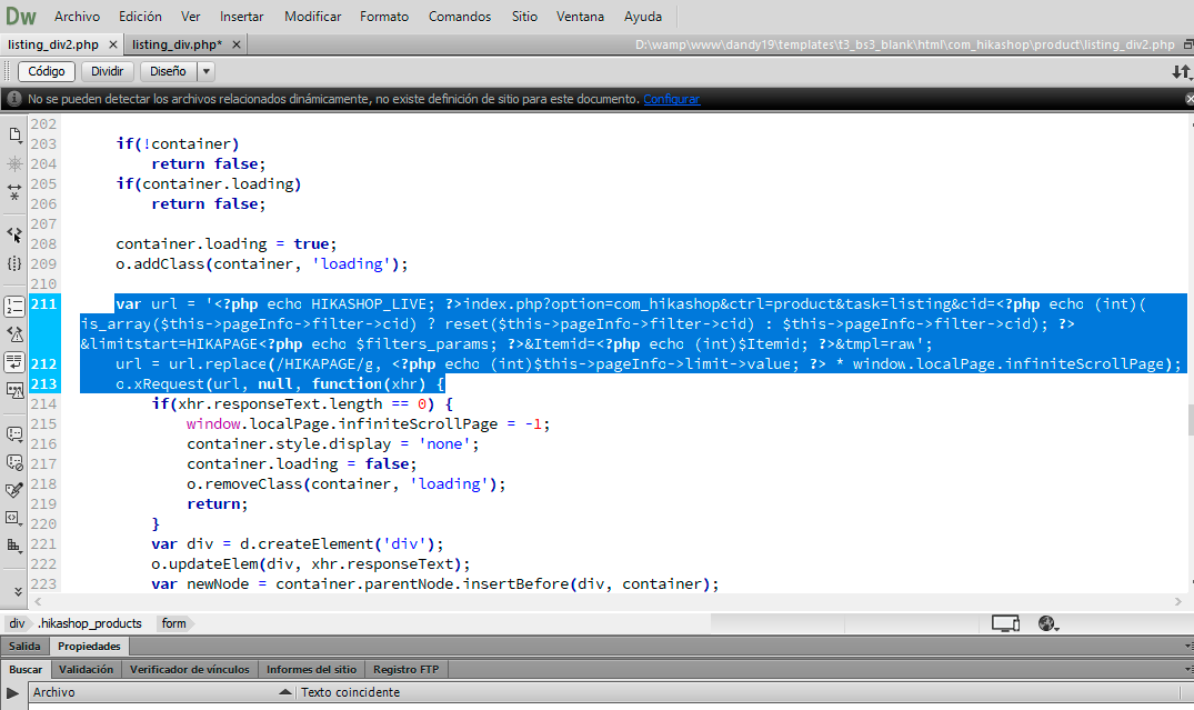

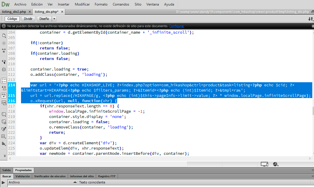

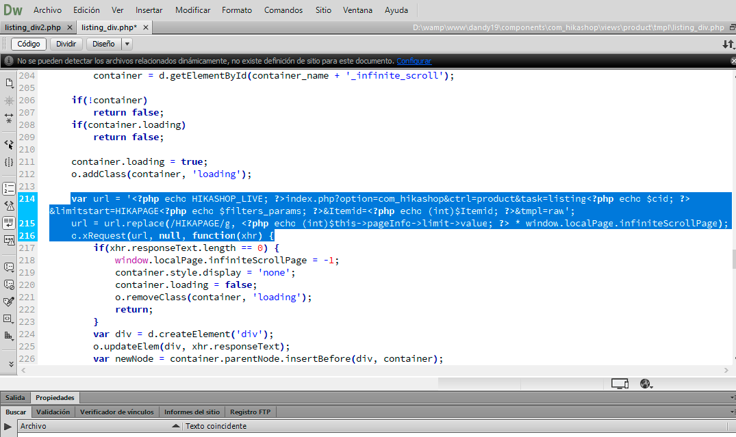

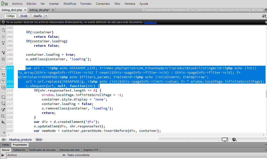

  • Posts: 25
7 years 2 months ago #309025
Hi Philip
Testing the two files, change this line of code to the one of the previous version and that works well.
Can you tell me if doing this is correct, is there anything else I should add?
previous version file 4.1.0
file version 4.2.0
I appreciate your opinion about it
  • Posts: 86216
  • Thank you received: 14222
7 years 2 months ago #309031
There are a bit more changes to the listing_div.php view file in the 4.2.0 release.
Here is a diff of all the changes:
Index: listing_div.php
--- listing_div.php	(revision 12671)
+++ listing_div.php	(revision 12796)
@@ -8,7 +8,7 @@
 $mainDivName = $this->params->get('main_div_name', '');
-$enableCarousel = (int)$this->params->get('enable_carousel', 0);
+$enableCarousel = (int)$this->params->get('enable_carousel', 0) && $this->module;
 $infinite_scroll = !$enableCarousel && ((int)$this->params->get('infinite_scroll', 0) == 1) && ((int)$this->params->get('random', 0) == 0);
 $this->align = (((int)$this->params->get('text_center') == 0) ? 'left' : 'center');
@@ -50,9 +50,9 @@
 if(in_array($pagination, array('top', 'both')) && $this->params->get('show_limit') && $this->pageInfo->elements->total && !$infinite_scroll) {
 	$this->pagination->form = '_top';
-<form action="<?php echo hikashop_currentURL(); ?>" method="post" name="adminForm_<?php echo $mainDivName . $this->category_selected; ?>_top">
+<form action="<?php echo str_replace('&tmpl=raw', '', hikashop_currentURL()); ?>" method="post" name="adminForm_<?php echo $mainDivName . $this->category_selected; ?>_top">
 	<div class="hikashop_products_pagination hikashop_products_pagination_top">
-		<?php echo $this->pagination->getListFooter($this->params->get('limit')); ?>
+		<?php echo str_replace('&tmpl=raw','', $this->pagination->getListFooter($this->params->get('limit'))); ?>
 		<span class="hikashop_results_counter"><?php echo $this->pagination->getResultsCounter(); ?></span>
 	</div>
 	<input type="hidden" name="filter_order_<?php echo $mainDivName . $this->category_selected; ?>" value="<?php echo $this->pageInfo->filter->order->value; ?>" />
@@ -115,10 +115,10 @@
 		else
 			echo '<div class="hk-row-fluid hk-row-'.$row_fluid.'">';
-		$itemLayoutType = $this->params->get('div_item_layout_type');
+		$itemLayoutType = $this->params->get('div_item_layout_type');
 		foreach($this->rows as $row) {
 		<div class="hkc-md-<?php echo (int)$span; ?> hikashop_product hikashop_product_column_<?php echo $current_column; ?> hikashop_product_row_<?php echo $current_row; ?>"
 			itemprop="itemList" itemscope="" itemtype="http://schema.org/ItemList">
 			<div class="hikashop_container">
@@ -130,10 +130,10 @@
 			$this->setLayout('listing_' . $itemLayoutType);
 			echo $this->loadTemplate();
 			unset($this->row);
 				</div>
 			</div>
-		</div>
+		</div>
 <?php
 			if($current_column >= $columns) {
 				$current_row++;
@@ -178,6 +178,10 @@
 				$filters_params .= '&'.$name . '=' . $value;
+		$cid = '';
+		if($this->categoryFromURL)
+			$cid = '&cid='.(int)(is_array($this->pageInfo->filter->cid) ? reset($this->pageInfo->filter->cid) : $this->pageInfo->filter->cid);
 		<div class="hikashop_infinite_scroll" id="<?php echo $mainDivName; ?>_infinite_scroll">
 			<a href="#" onclick="return window.localPage.infiniteScroll('<?php echo $mainDivName; ?>');">
@@ -203,7 +207,7 @@
 	container.loading = true;
 	o.addClass(container, 'loading');
-	var url = '<?php echo HIKASHOP_LIVE; ?>index.php?option=com_hikashop&ctrl=product&task=listing&cid=<?php echo (int)(is_array($this->pageInfo->filter->cid) ? reset($this->pageInfo->filter->cid) : $this->pageInfo->filter->cid); ?>&limitstart=HIKAPAGE<?php echo $filters_params; ?>&Itemid=<?php echo (int)$Itemid; ?>&tmpl=raw';
+	var url = '<?php echo HIKASHOP_LIVE; ?>index.php?option=com_hikashop&ctrl=product&task=listing<?php echo $cid; ?>&limitstart=HIKAPAGE<?php echo $filters_params; ?>&Itemid=<?php echo (int)$Itemid; ?>&tmpl=raw';
 	url = url.replace(/HIKAPAGE/g, <?php echo (int)$this->pageInfo->limit->value; ?> * window.localPage.infiniteScrollPage);
 	o.xRequest(url, null, function(xhr) {
 		if(xhr.responseText.length == 0) {
@@ -303,9 +307,9 @@
 if(in_array($pagination, array('bottom', 'both')) && $this->params->get('show_limit') && $this->pageInfo->elements->total && !$infinite_scroll) {
 	$this->pagination->form = '_bottom';
-<form action="<?php echo hikashop_currentURL(); ?>" method="post" name="adminForm_<?php echo $mainDivName . $this->category_selected; ?>_bottom">
+<form action="<?php echo str_replace('&tmpl=raw', '', hikashop_currentURL()); ?>" method="post" name="adminForm_<?php echo $mainDivName . $this->category_selected; ?>_bottom">
 	<div class="hikashop_products_pagination hikashop_products_pagination_bottom">
 	</div>
Also, note that we had to add several patchs today for the filter system. So if you have issues with it, I would recommend downloading again the install package on our website and installing it on yours to get the patchs.
