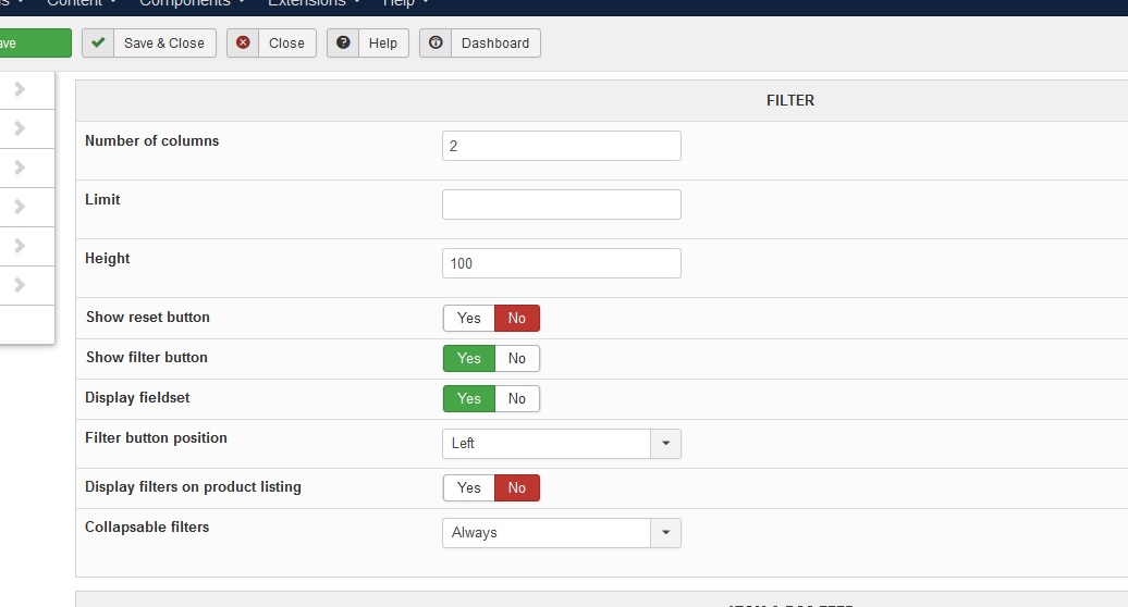

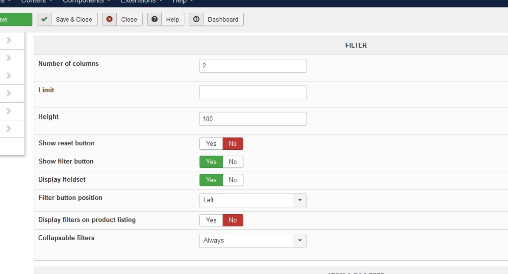

  • Posts: 67
6 years 11 months ago #309283
Hello Nicolas,
1. Infinity scroll is now working, after turning on redirect POST mode
2. Collapsable filters were working and option "always" was already turned on. But after update it stopped working. Screen shot is provided
Last edit: 6 years 11 months ago by kivici.
  • Posts: 85883
  • Thank you received: 14120
6 years 11 months ago #309285
Thank you for the additional details. I found the issues and added two patches on our end which fixed the issue for me.
Download again the HikaShop install package on our website and install it on yours and that should fix the problems for you too.
The following user(s) said Thank You: kivici
  • Posts: 67
6 years 11 months ago #309344
Thanks a lot for fast fix. Both problems are solved.
